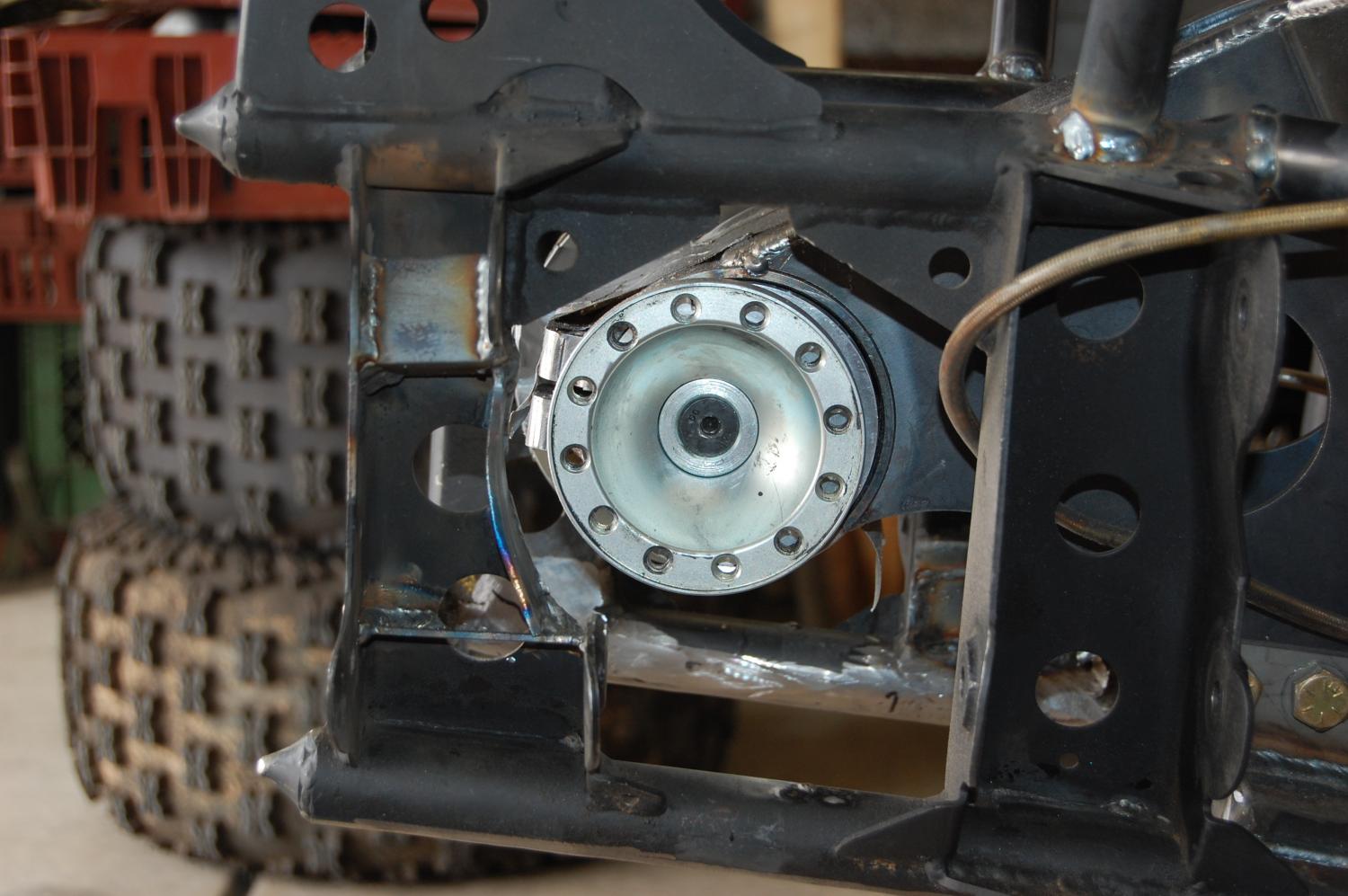

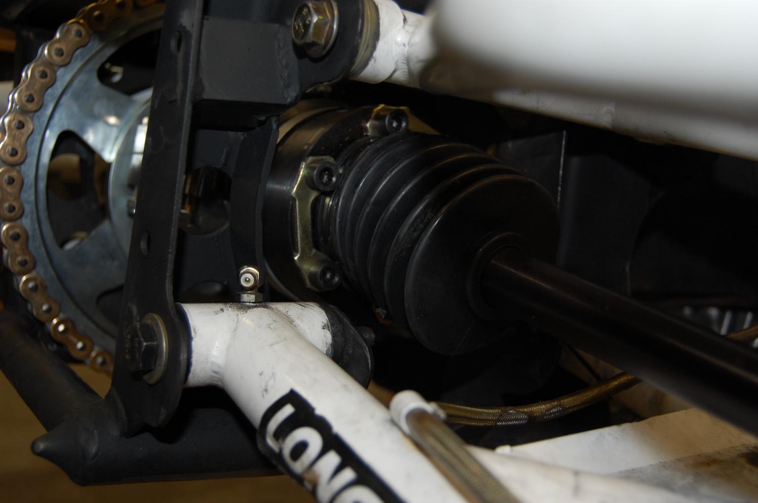

now i just installed the chain and went to adjust it and the cv's hit the rear up rights before the chain is tight and i cannot take a link out of it. oh well it sucks trying to cram 20lbs of motor in a 5lb frame. have to dissassemble the rear end and cut out some metal then replace it at a different angle. i am glad i have Vets day off to start on the sheetmetal. hope to take it out to Sycamore saturday.

it would be too tight. i tried to stretch the chain with the carrier in the shortest position and it is 1/2 a link off. oh well nothing is easy.

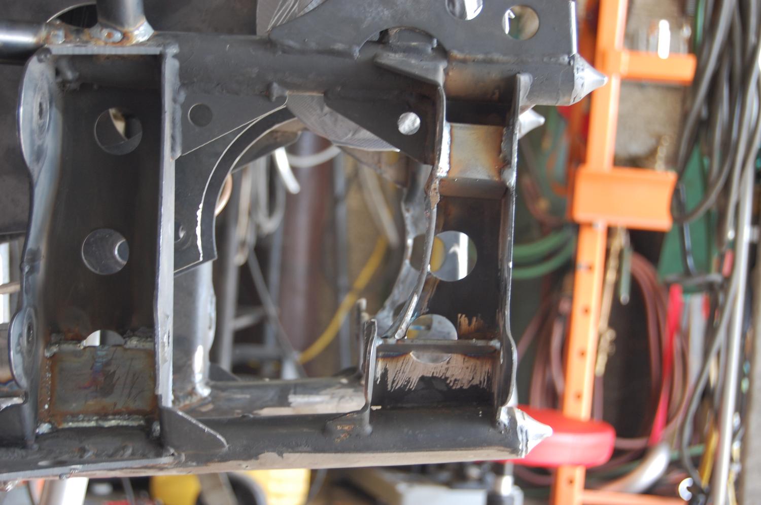

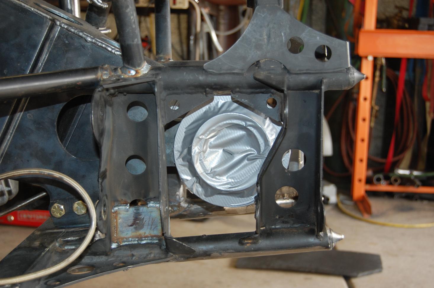

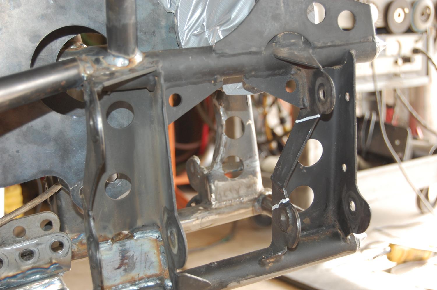

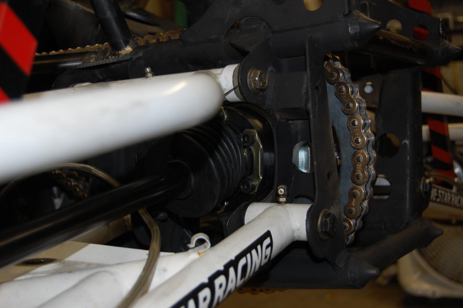

well got the sproket and cut the chain. then attempted to adjust the chain and the cv's hit the rear a-arm pivot points on the frame. had to dissassemble the complete rear end and then cut out and gusset the arear affected. got it all back together and pleanty of clearance now for chain adjustmment.
i installed the drivers rear shock and installed limit straps limiting it to 21*. i am getting really close to blasting around the neighborhood. i can't wait.
