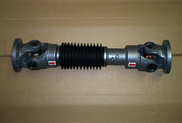

Check out driveshaftsuperstore.com They have one good for 200 hp for 550$ per pair and another good for more power for 650$.
do you guys have any idea how much more rotating mass those u-joint style shafts will add??

There gonna send me an actual quote and I will find out. I needed the flange to flange dimensions first, they will give me estimated weight when they figure it all up. They like to do double boots and heat sinks for dezert racing. I dont think the heat sinks will fit between the arms though.

I am currently running these axles on my R1 rhino. Things to think about, they are pretty heavy, I have snapped the yoke on one side (supposedly rated for 500 hp) I have since upgraded both yokes to a forged steel one (about $150.00 per side after they rebalance the axles) and the best for last. The degrees.... the side at the gearbox will get around 38*, but the side at the wheel is around 23-24*, so beware sometimes the sales pitch is just that, see for yourself before you purchase them. I am not totally unhappy, they have worked for me for the most part, but I will probably be going with cv's and summers bros. soon. I am not getting any real advantage currently as far as angle and I am having to spin quite a bit more weight. Oh yeah and when I sent the axles back to get repaired it took almost 4 weeks for me to get them back, and that was after about 8-10 phone calls.

Great info, why does one side have less angle? You stopped me in my tracks. Back to 930 then!!

Not sure, the yoke flange binds on the axle shaft when the wheel rotates. And I thought it was really strange too that one side had less angle capabilities, they should be the same so the move / travel together throughout the suspension cucle. It might just be the ones coming from this shop, the pictures you posted are different axles than the ones I have. My only suggestion is to check the degrees for yourself.

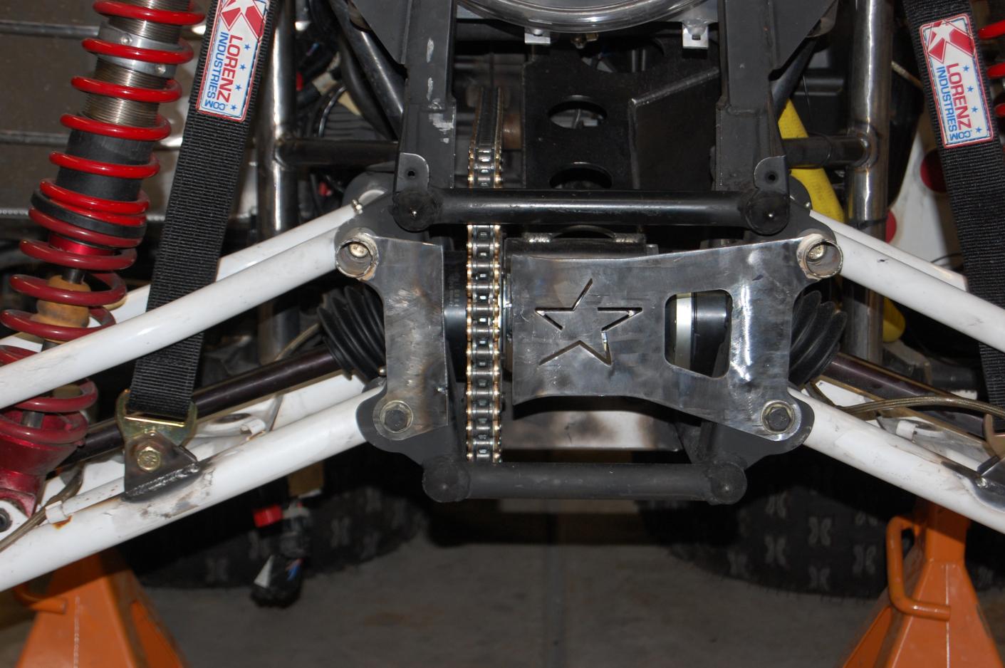

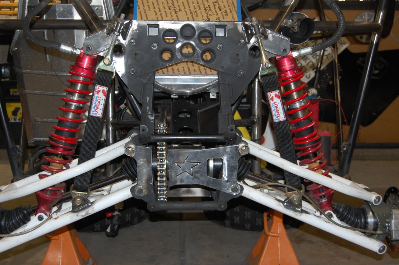

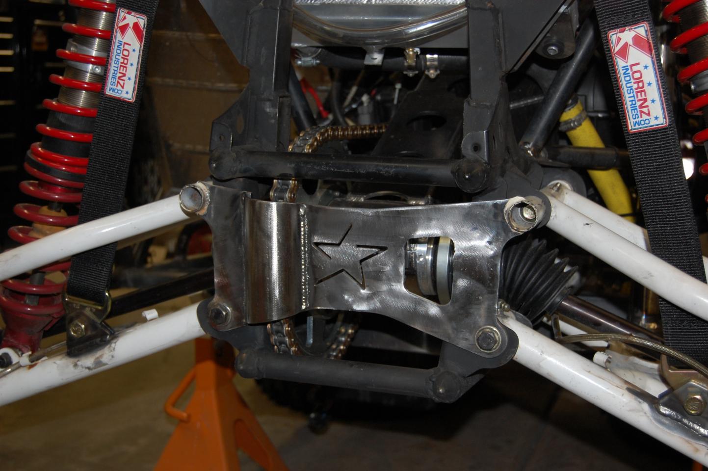

i setup the other limit strap today, cut the rear gusset plate in half and clearanced it for the chain. i still have to cap the ends and gusset it for strength.

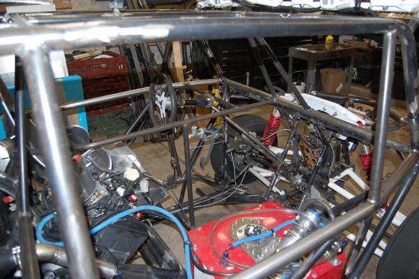

so no major issues but the pedals and steering wheel are too far off center to be comfortable. so i pulled it on the garage and cut the rest of the stock dash that held the steering column. i am going to cut and lengthen the steering shaft to move the steering center and closer to the seat. then ground the tacks off the pedal placement and working on moving them over.

cut and lenghtened the steering column 3 1/2".
added a Willwood proportioning valve to the front brakes and mounted it behind the front shock tower.
moved the steering wheel mount over 5" and got rid of the adjustable steering column.

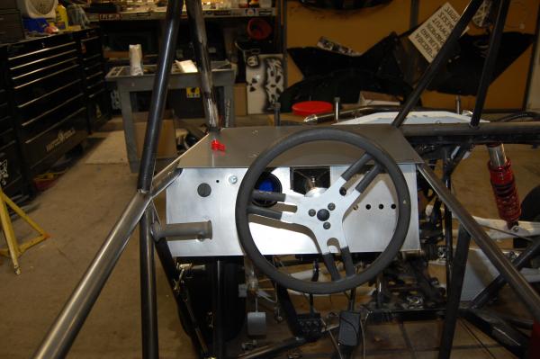

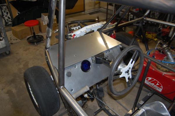

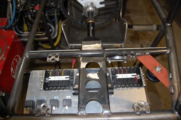

todays update. made the dash and fuse panel area. i made all of the panels removable with dzus fastners. it will make it easier to wire. i have to make two bends on the panels at work tomorrow but will slap them in and button up the wiring.
