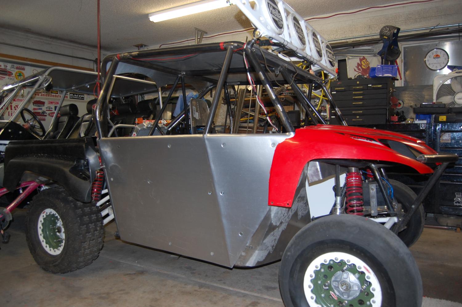

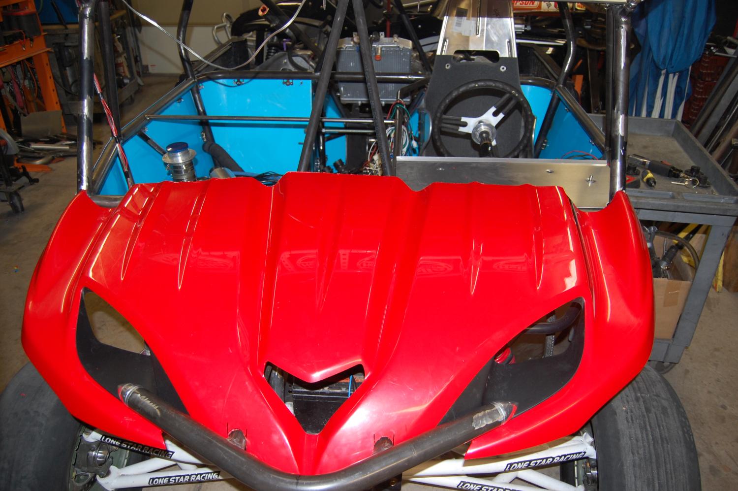

trimmed up the new hood a little tonight. still needs the mounts installed and some fine filing and sanding to finsih it off.

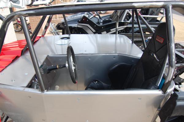

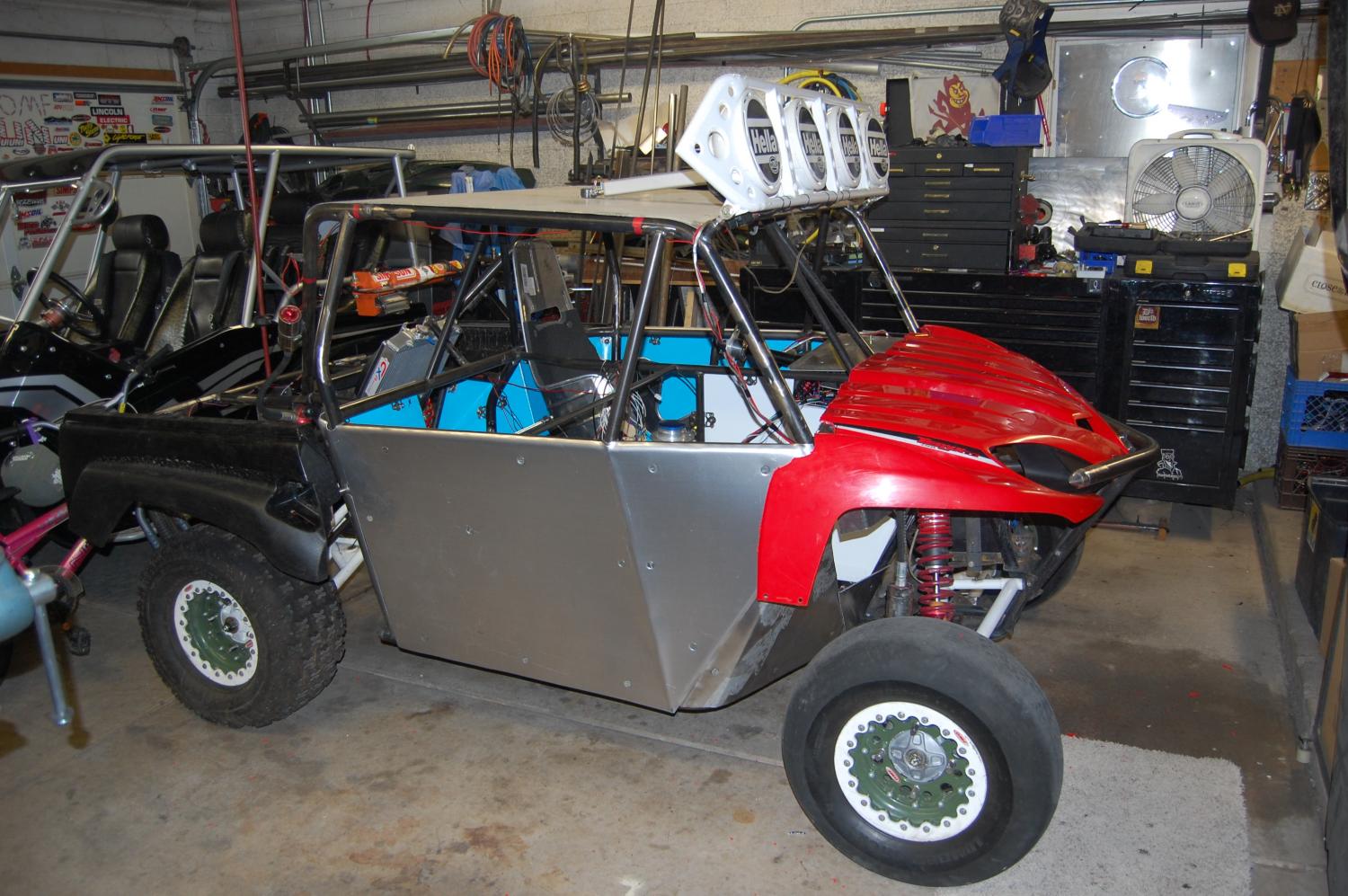

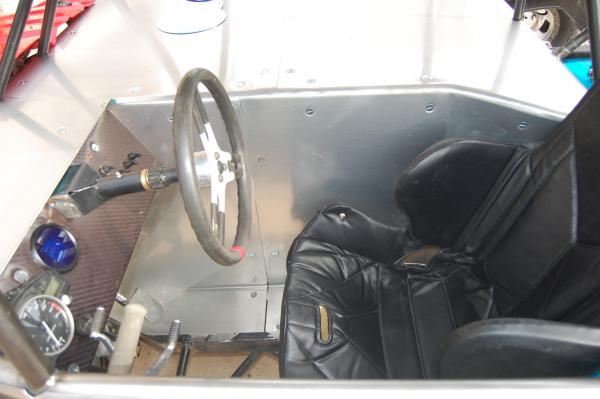

made a few panels this weekend then ran out of aluminum. still need to make the bed cover, cooler rack and bead roll the panels. then i have to decide what colors.
a little progress this weekend. mounted the bottom of the rear bumper to the frame. next is to make a cooler holder for frosty beverages.

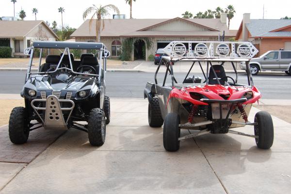

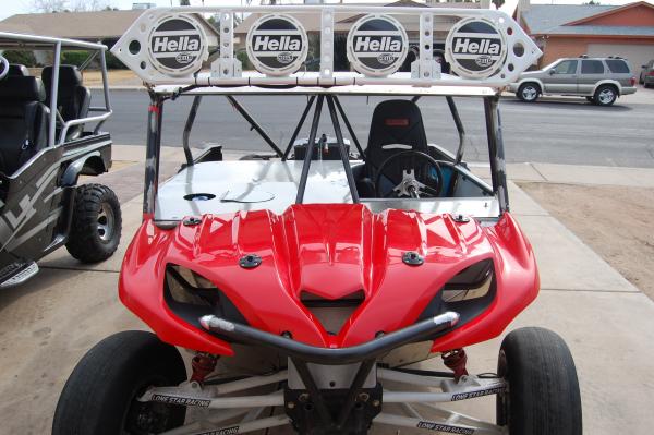

i used two Rhino bed shocks as stabilizers for my lightbar actuator. they have play in them and while driving through rough terrain the lightbar will jiggle agound and the lights will vibrate.

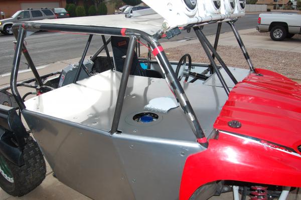

also made a drivers side mirror holder.
then finished up my rear trunk to hold my cooler for frosty beverages.

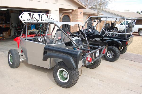

now that it ran i had to cut a hole in the motor cover for the airfilter and cut a hole for the 2" exhaust through the passenger side rear panel. got them trimmed and cleanned up then re-installed.
so excited i took it for a drive around the block. the clutch slipped badly and i had to go back to the garage and adjust it. crawled under the car and adjusted the clutch then back on the road.
damn thing is scary fast and you really notice how lumpy the dirt tires are while going 70mph on pavement.
proceeded to drive about 7 miles around the streets of Mesa then back to the garage with a huge smile on my face. it really has been a long time comming. i started this swap in late September.

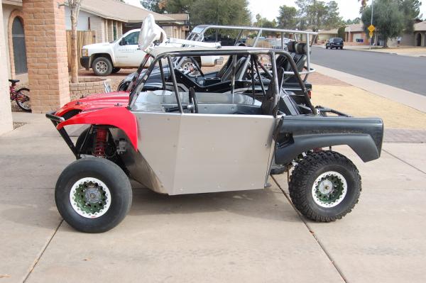

dont worry i will post some video and pics tomorrow morning of a little road trip in the "only street legal RZR powered by a R1". haha stupid line but true.
thanks for all of the help and support everyone has given me through this swap. i already have a short list of things to change and a couple upgrades. plus making it look good with some beadrolling of the panels and some powdercoating.
BUT I AM GOING TO ENJOY IT AND MAKE IT PRETTY LATER!!!!!!! rough tough and dangerous is how i roll.
