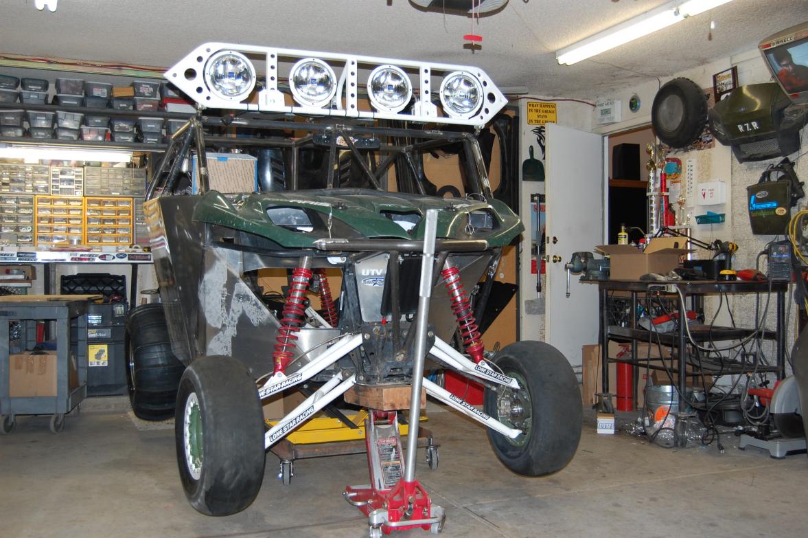

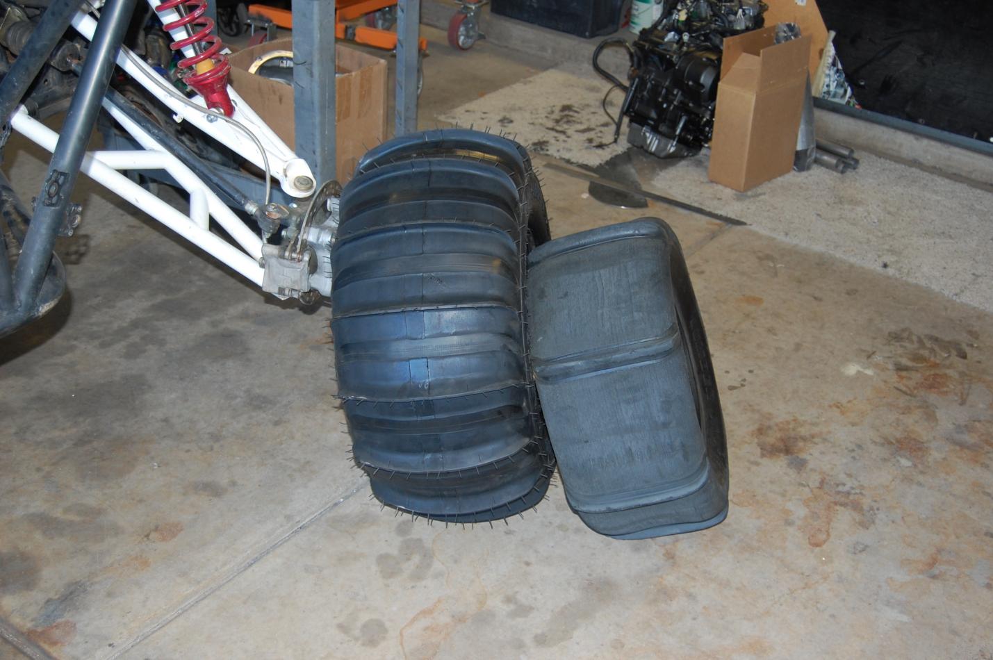

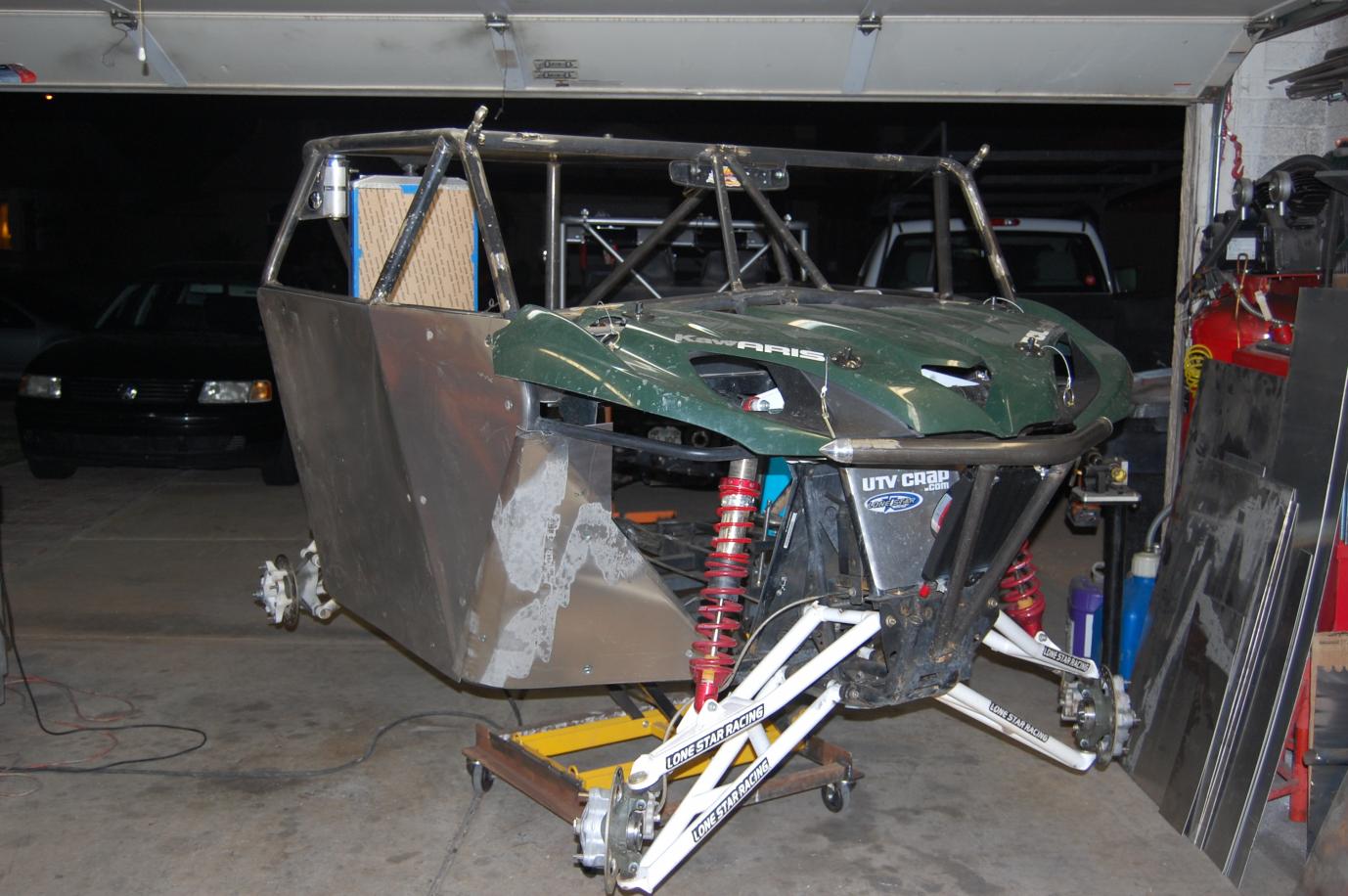

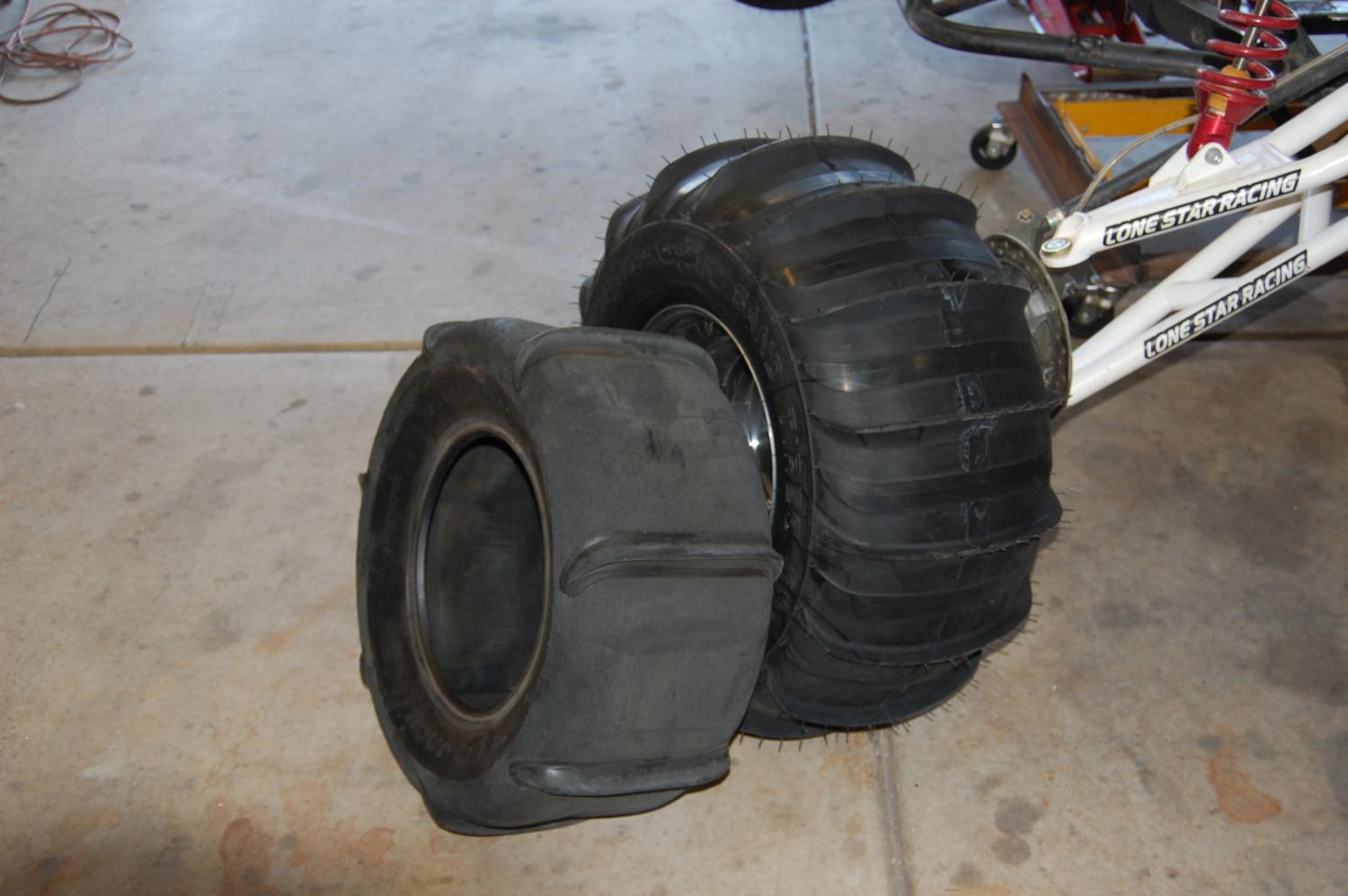

this weekend i mounted my paddles and made all new aluminum panels. took saturday off to go watch the LOORRS race.

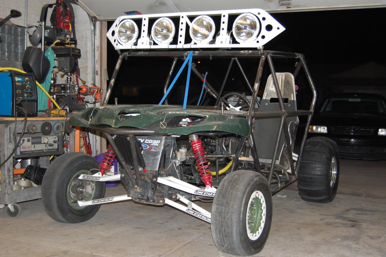

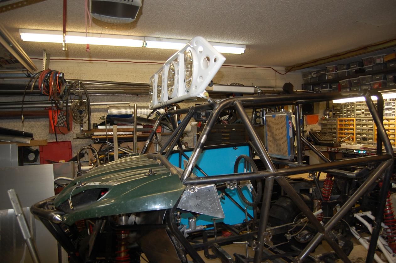

picked up my powdercoated light bar and lights from Lonestar today. also swapped the rhino tires to paddles cleanned the air filter, checked all fluids and replaced one torn cv boot on my rhino now its ready to ga as a back up.
Damn mikey! You won't even have to turn on those lights, and you will be able to see at night!! LOL.

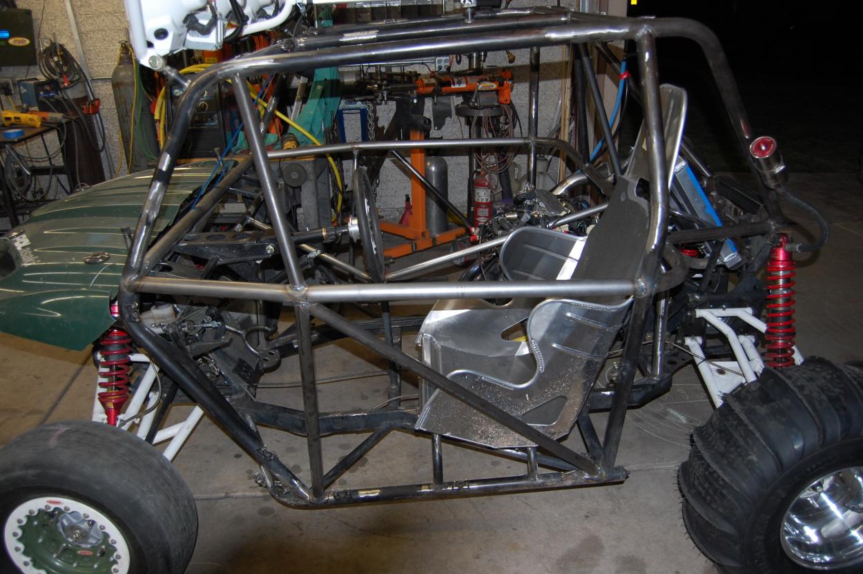

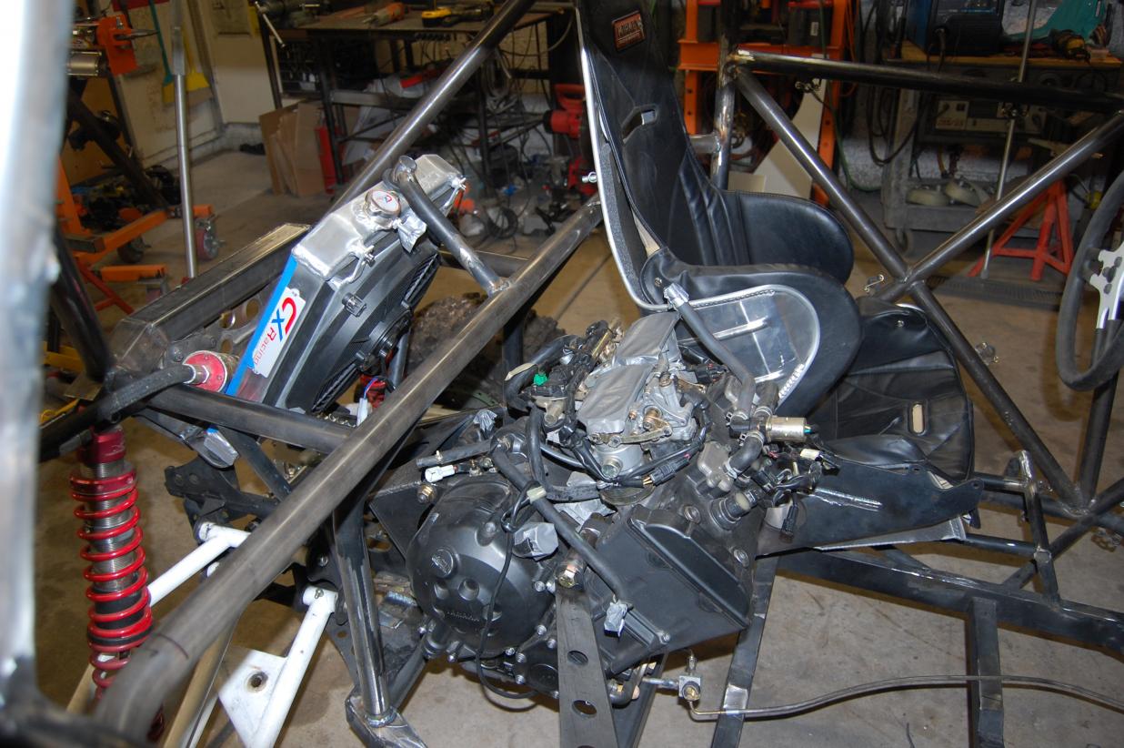

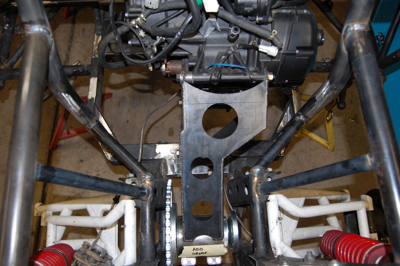

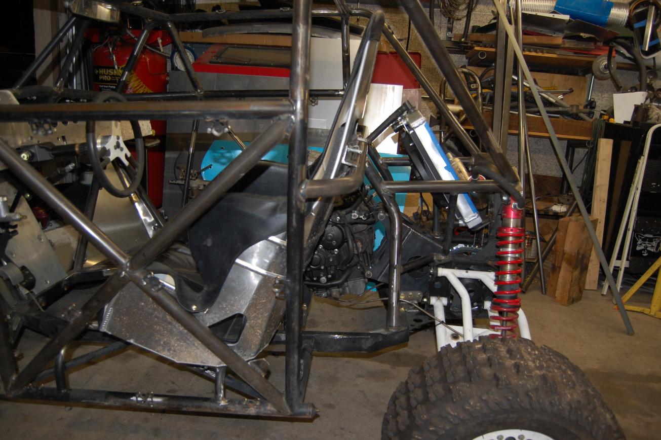

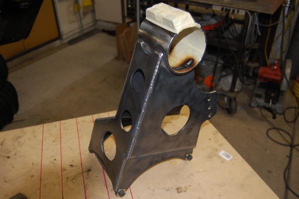

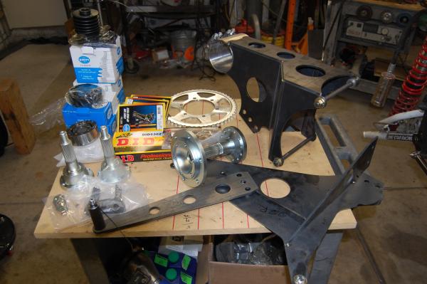

recieved the motor install kit from Weller Racing late friday.
made a gas pedal and shift lever

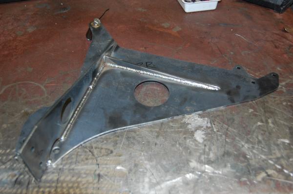

welded the motor mount kit together

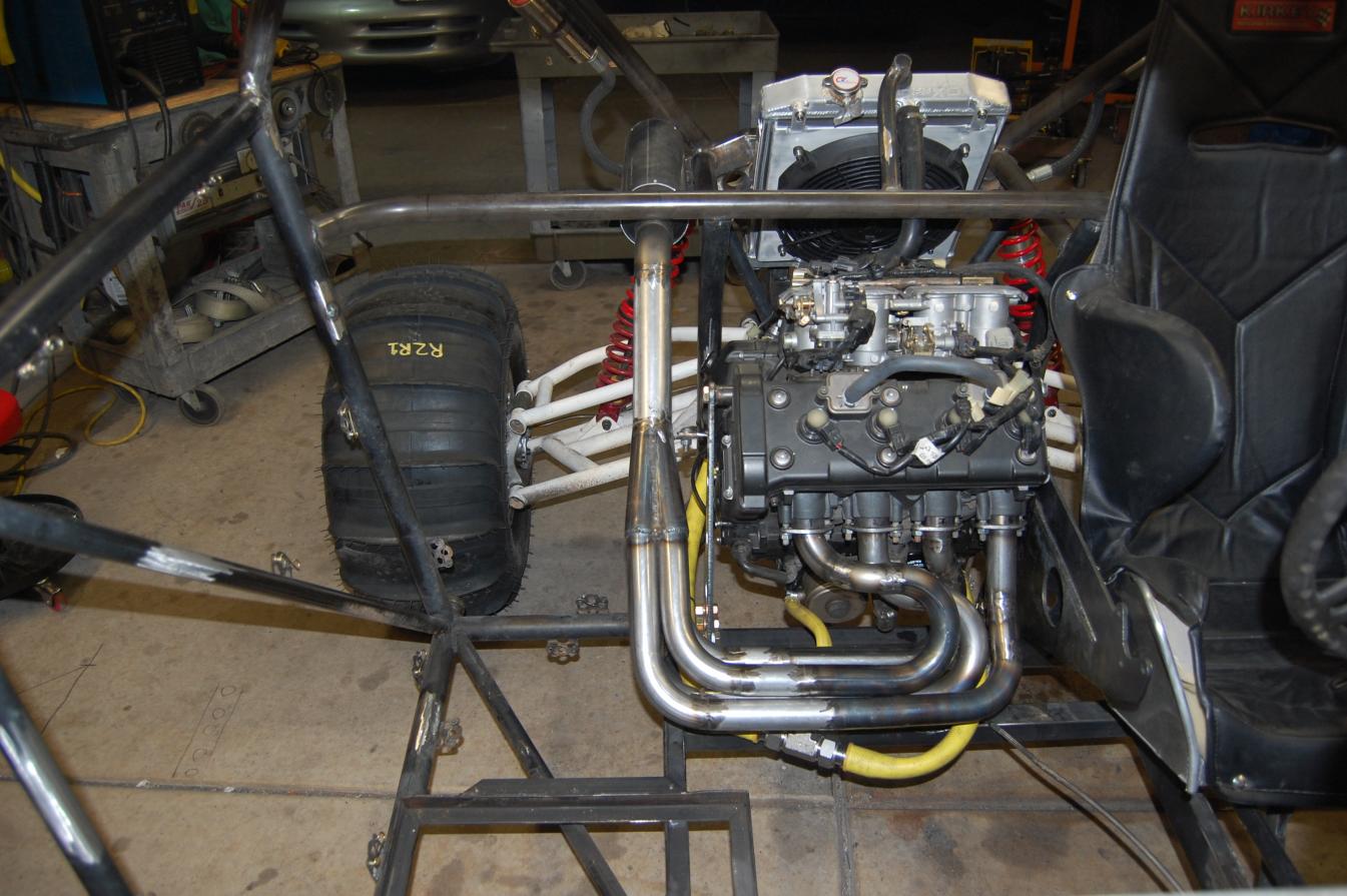

installed the motor and welded in the tabs
had to rework my shoulder harness mounting bar due to it being in the way of the air filter.

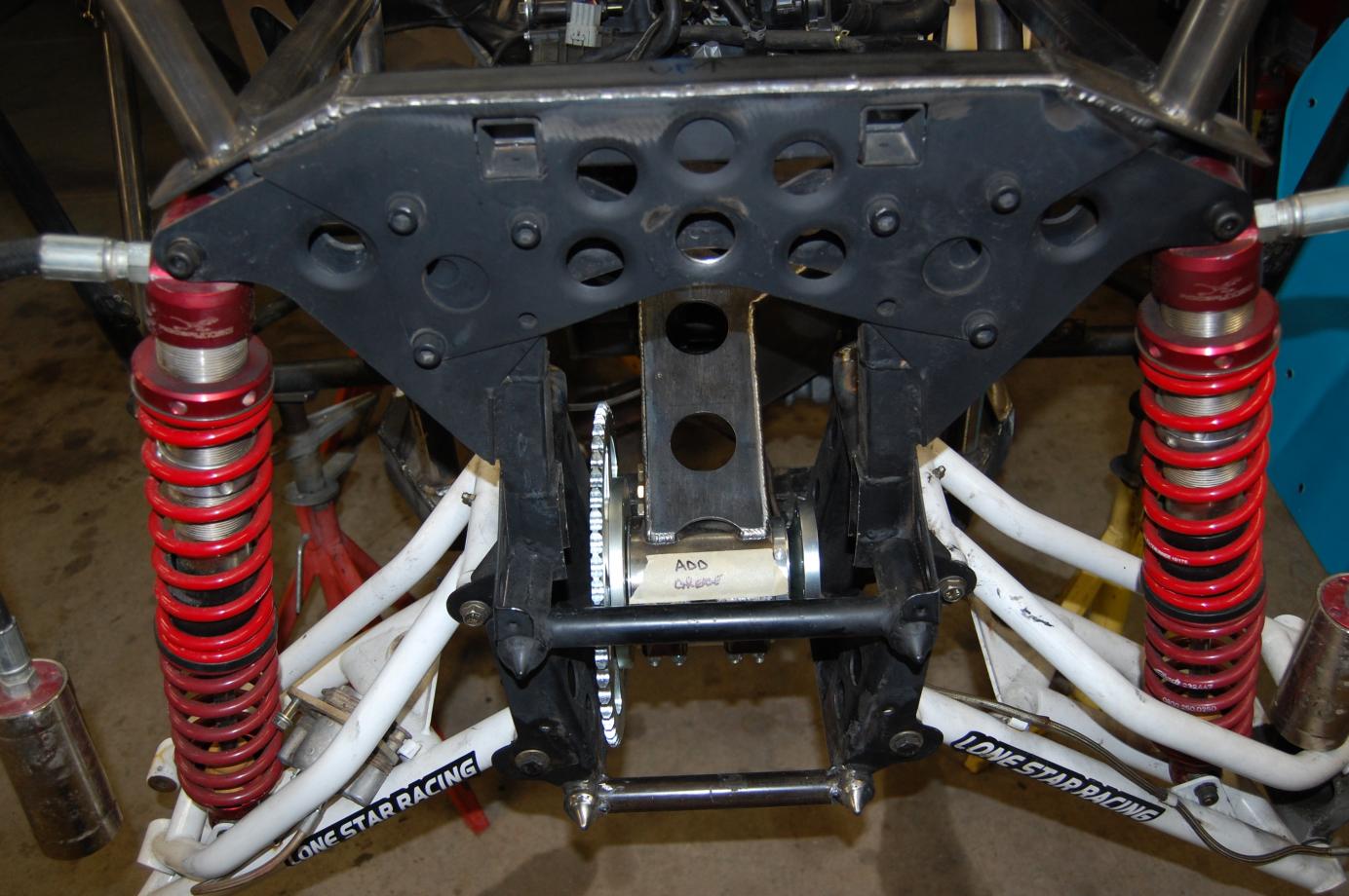

also supported the rear suspension more with some bracing.
enjoy
i have a little tube work to do tomorrow then mont and plumb the radiator. also i hope to start wiring sunday night.
super tight clearance
This thing is gonna be an animal!!
Were you able to use the standard SR1 kit from Weller or did they modify it for you at all?

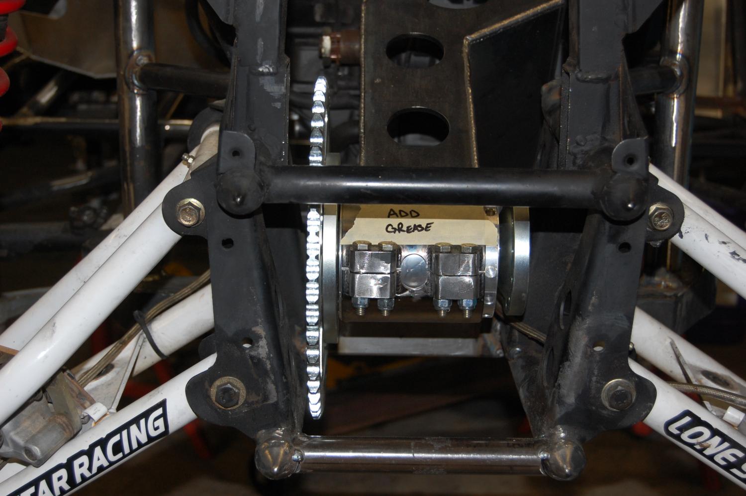

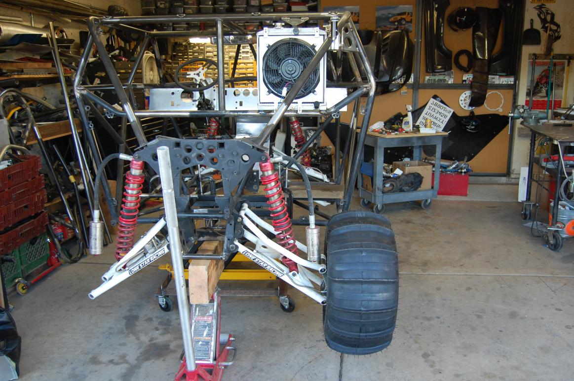

Jason made me a kit with the carrier 2" narrower than the rhino kit then he made rzr outer stub shafts with flanges for the cv's
I placed the carrier in the stock location. With the narrowed carrier and my +8 arms I should not have any cv binding issues.

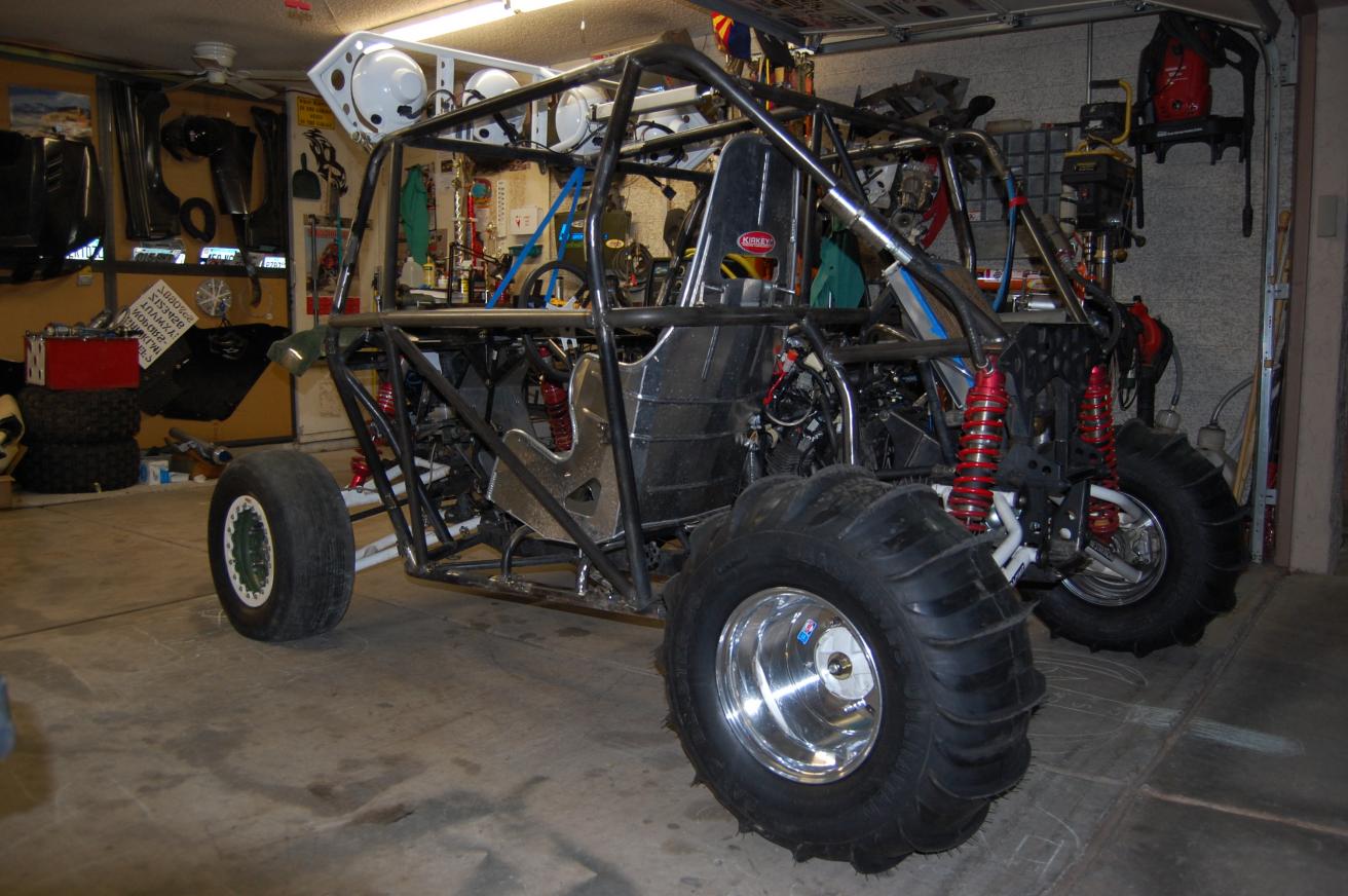

well i did not get all i was hoping to do tonight. we went to Harolds Corral in Cave Creekto watch a Steelers game. (i am not a football fan it was a last minute deal for my mom's b-day).

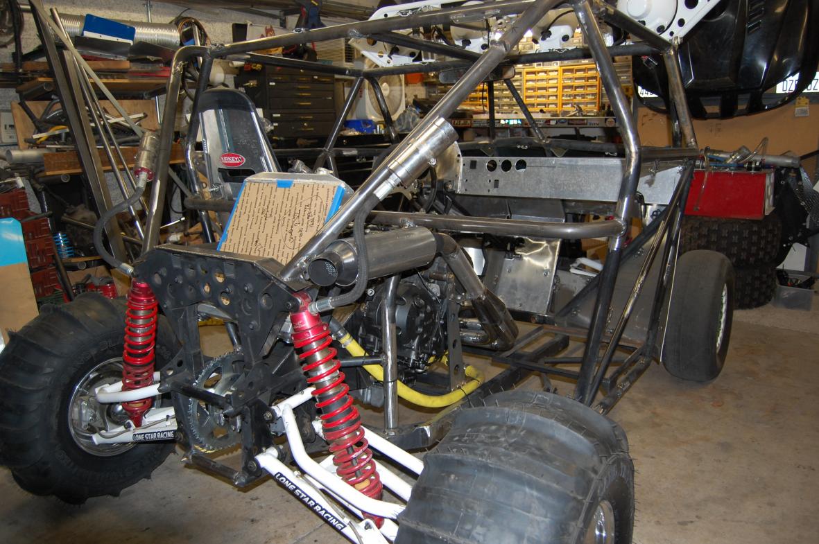

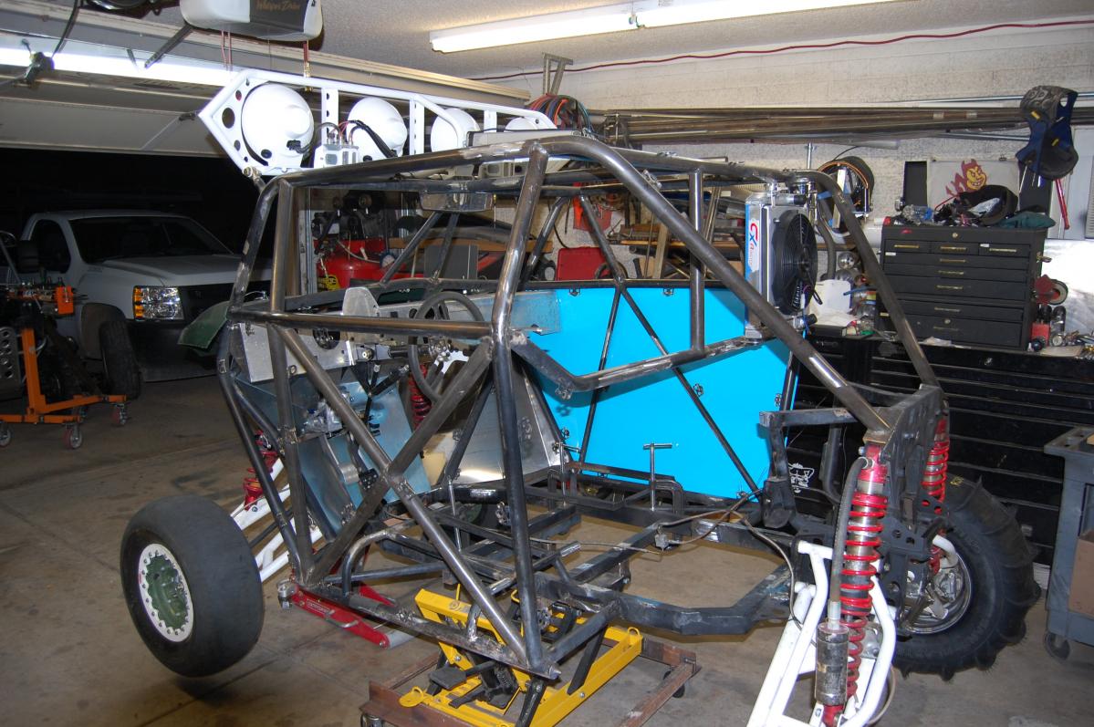

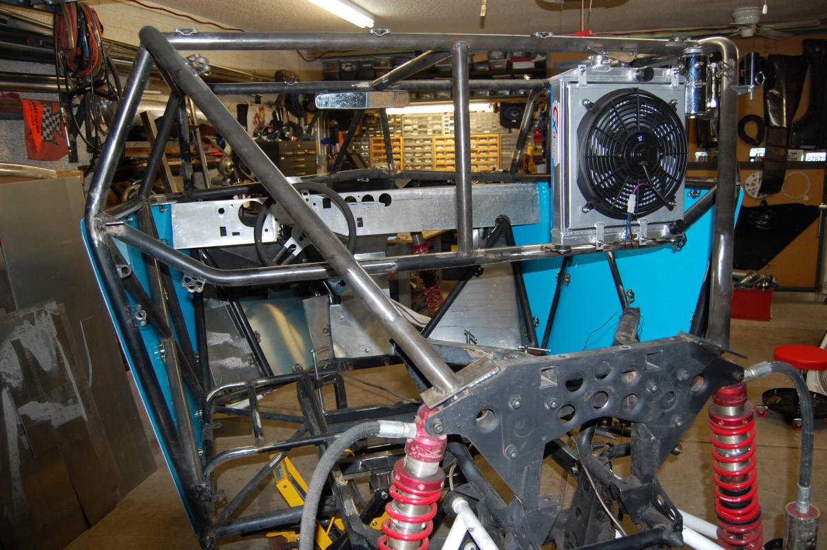

i mounted the radiator with the fan as a pusher fr now untill i get time to have tabs welded to the other side for the shroud.

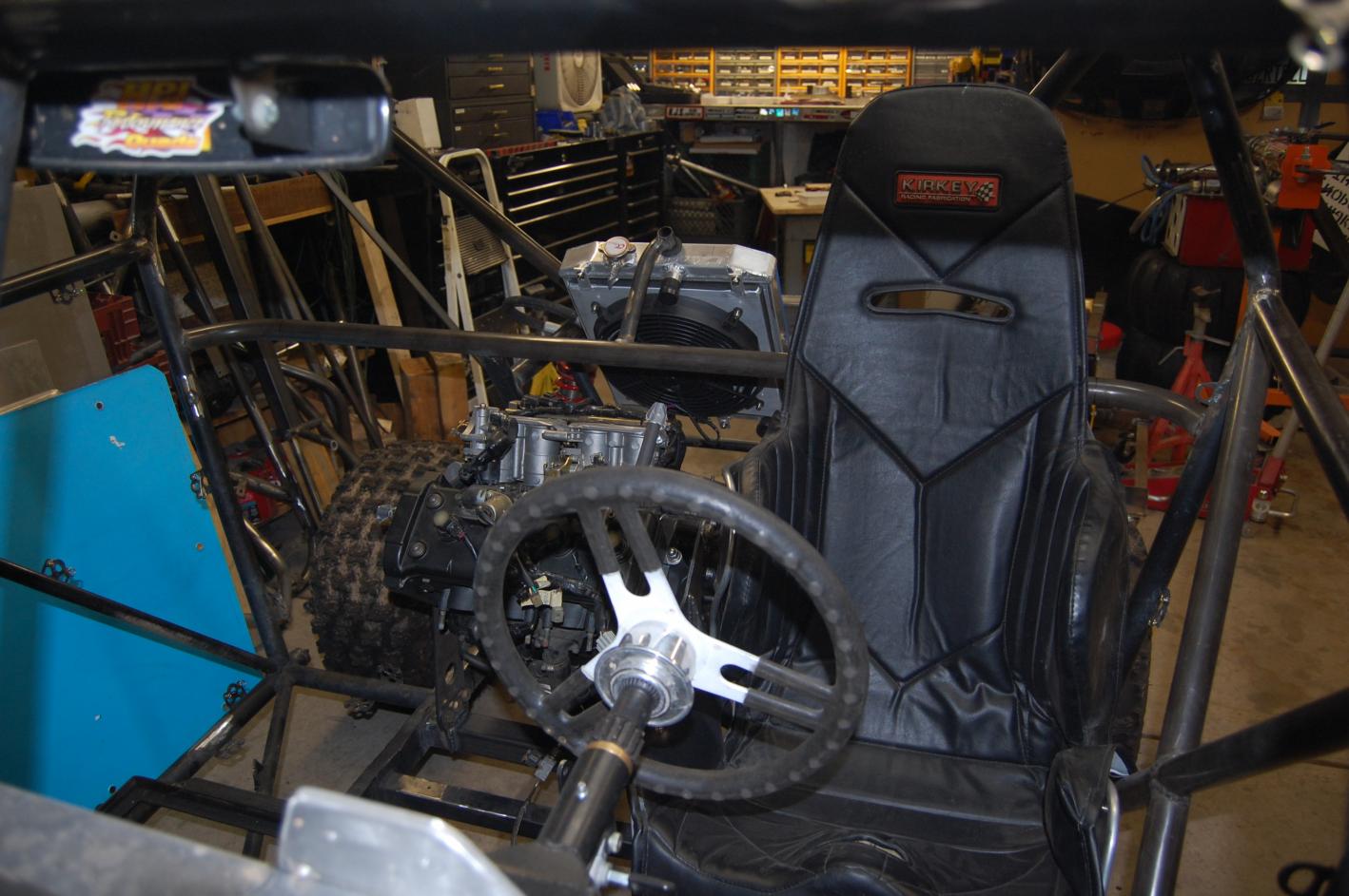

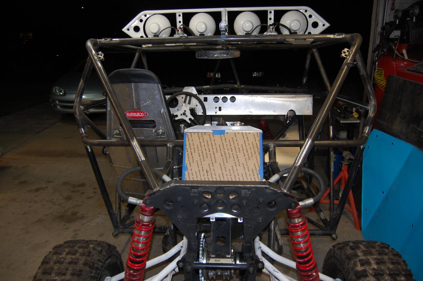

i mounted the seat and tabs for the 5 point harness.

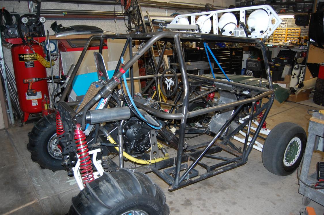

its a roller now and i am measuring for axles tomorrow and going to pick them up.
i am concerned that the rear of the car is not as heavy as the old setup and my spring rates are not correct now.
finished all of the plumbing, filled it with fluids, made an Optima battery mount, mounted the resivoirs, mounted the muffler, cut the drivers side motor mount plate since i am mounting my shifter on the left, started the wiring.

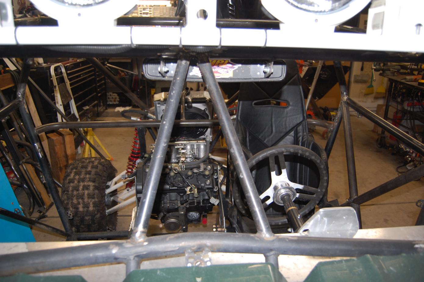

well did not make it out of the garage. finally got it running late friday night. still missing a sprocket to make it move. friggin $15 part grrrrrrrrrrrrrrrr. anyways i was pissed this weekend that i cold not make it to G so i decided to lower the door bars, dash bar and hood, then redo the dash. i plan on putting the main power cut off switch and ignition switch to the left of the steering wheel and the rest of the switches in the center of the car.
