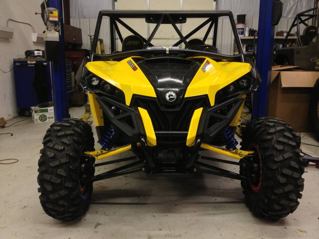

car looks good but, I personally think the cage is raked back a little too extreme. Just my opinion, but all is worth considering. makes it look like it was rolled over and crushed down from the start.
I hear what you're sayin, once we add a brace that goes from the bend at the top of the windshield down to the door bar it'll help that look and also that bend. Also the doors aren't staying, a lot of this what to get us to pass tech for this first race and figure out what we need to change.
This was my last racer, nicknamed the golf cart it looked silly but took the podium every race so I wanted to change that look.
That can am is wicked fast! With a little more shock tuning, that thing will be even faster! And, it looks good!
I agree. A little too much.
I'm in the same boat, its a little too much for my taste, I have always been on about the Wildcat cage and while it may take a massive get off the fold the front thats exactly what a cage in on to prevent. Its all guessing until you crash test them over and over, mathematics only goes so far, that why I'm always in favor over over engineering.
Just my personal bug.
Otherwise it looks like its been a sweet build and very jealous of the outcome and great performance obviously grabbing a win!! Congratulations!

We've also put one of our CT Racing front bumpers on it that are in production right now. It offers a lot of protection and has a winch mount for when we run KOH.
