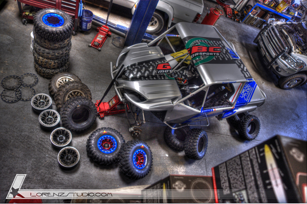

All UTV's Sneak peak at the new SR1 arse kicking machines for 2013
Dual core, dual pass, $600 hit to my wallet is on order. After going over the options including using Wellers SR1 Radiator, we decided the best option was to go with a custom unit that fits like a glove.

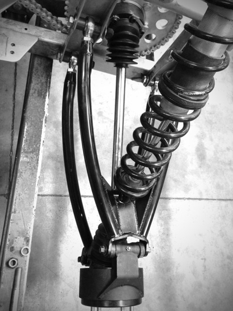

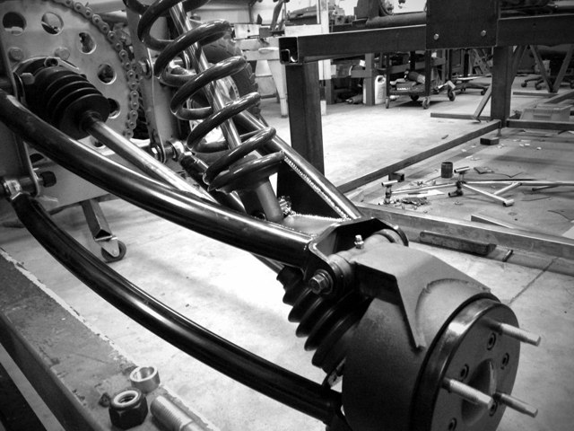

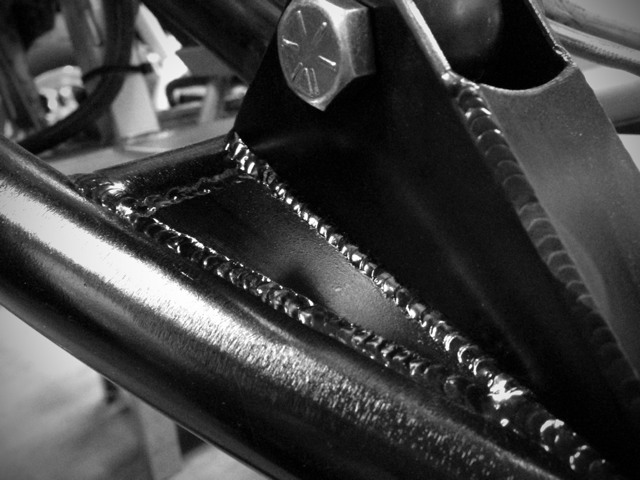

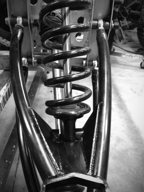

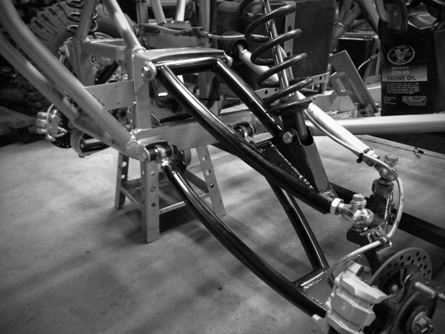

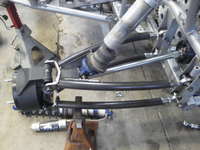

If you want unique, you need to get your car in line over at HRT. These boys are pulling off some amazing arms for the ZX-10 Teryx build.
The original plated HRT 5" over arms are now on Momma's car. We sacrificed the Race Car's arms for Suzy's car over the New Years weekend. Instead of swapping them back to the race car after the weekend in Glamis, I sent Todd on a mission to build some trick, lighter radiused custom arms for the race car.
Mission partially accomplished.

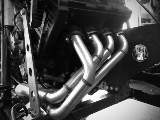

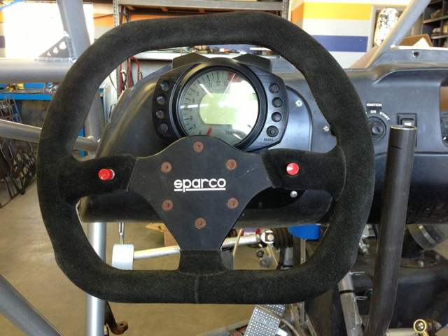

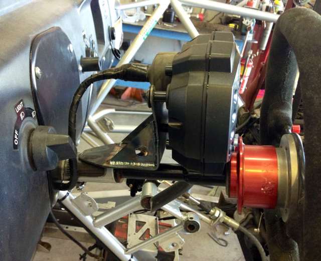

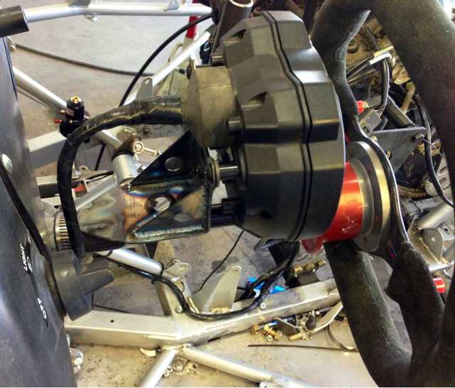

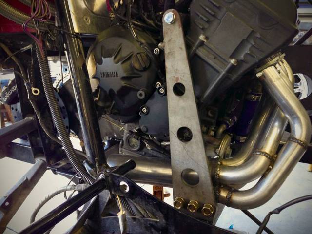

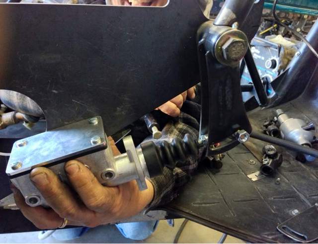

SR1 header progress and preliminary hand controls. The gas and brake pedals are removed from the car.

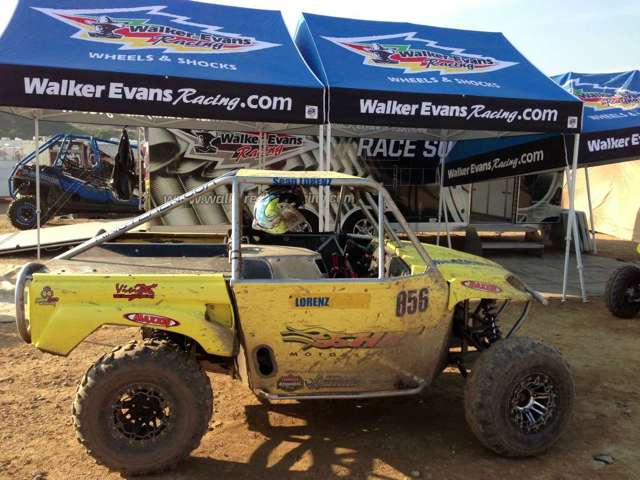

I'm not sure how we landed a couple of beautiful tech stickers, but we did. I saw a couple of familiar faces along the way. It's good to be back a LOORRS. Pro Photog to Racer Hack after a 2 year hiatus.
First race for the MinuteMen Racing in the AM.
My mid back and ribs are feeling it right now. That was not pretty. I Took 5th none-the-less! We're awaiting Jared's results. I'll take these results with a little pride, as it was Jared and my first race ever. It was the first time these cars had laid eyes on a race track as well. Fresh meat all around per say.

Here comes the excuses:
1) Shock setup needs major help from Walker Evans. I pancaked the faces of the rollers, and the plowed the face of the next roller ridiculously hard. This is how I wrecked my back. It happened every time no matter the line or speed I took. I'm calling the Chiropractor ASAP.
This car was valved to carry much less speed than it does now. This stock ZX10 is obnoxious fast with 190hp compared to the Teryx Motor 70-80hp. The power to weight ratio as it sits, rivals that of a Pro-Lite V8 Truck.
2) Chain alignment needs some love. That means the motor needs to come out and new machined spacers need to go in. If I didn't tighten the snot out of the chain it would bind and skip teeth when I laid into the throttle. The sprocket alignment is off about a 1/8", and its crossing up the chain not allowing it to roll over the sprockets freely.
3) An aluminum foot rest needed to go in as a dead peddle so I don't get my left foot stuck under the brake pedal
4) More "Go, Go, Go"

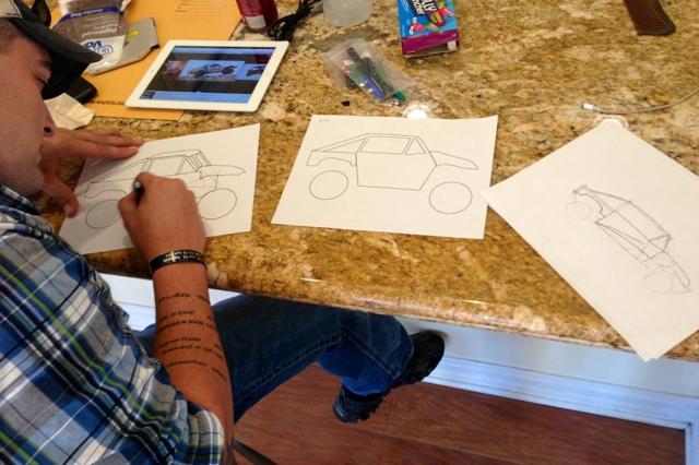

Graphics will be in the works before the next Race. Do you have a guy you like to use here locally. Designs and ideas are floating around in the truck as we speak right now on the way home back to the Ranch in Ramona. We'd be honored to have you and UTVunderground Team up again like its 2009.
