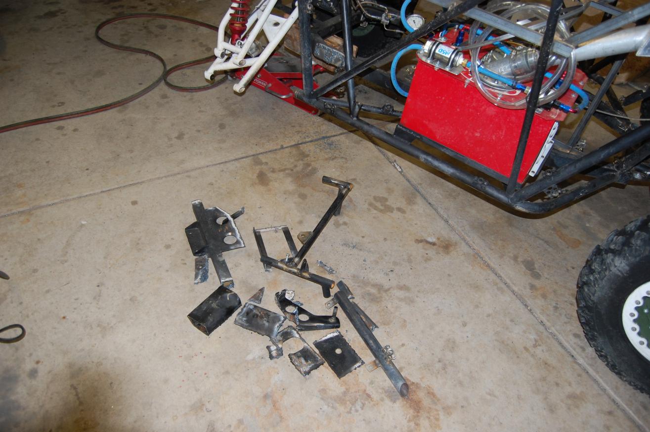

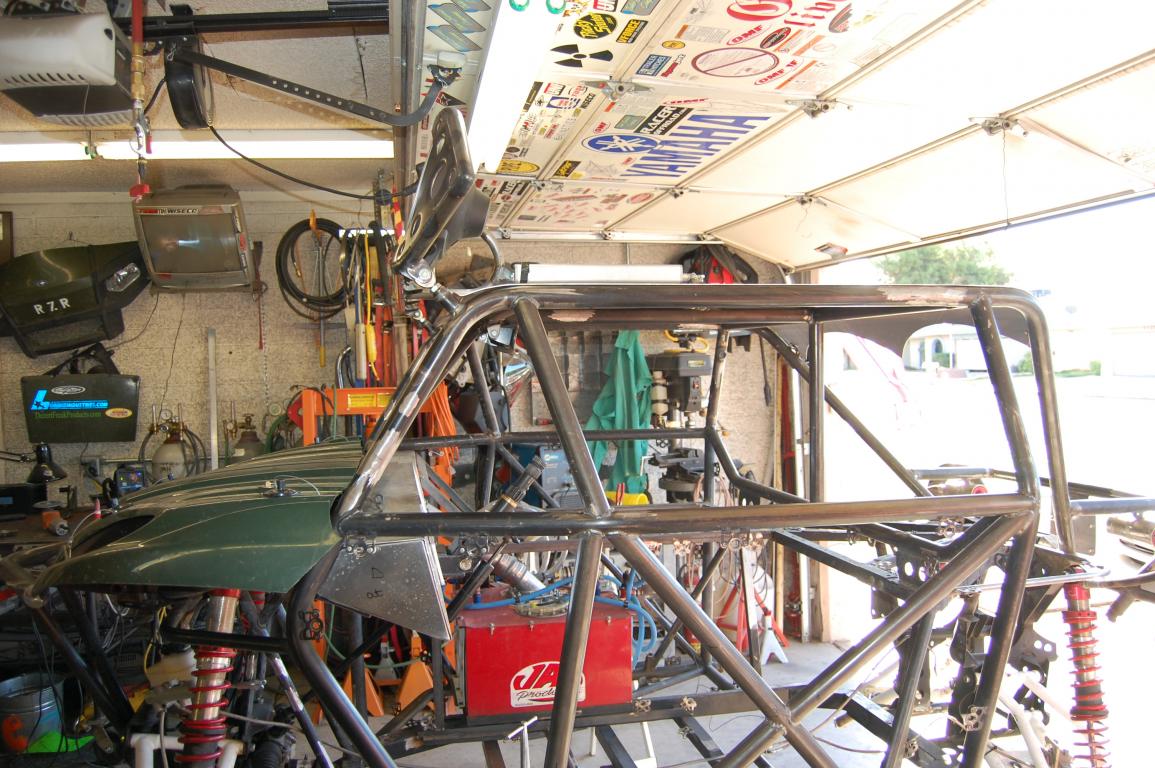

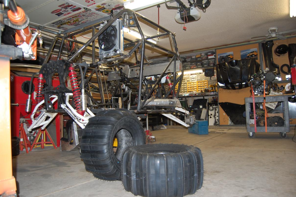

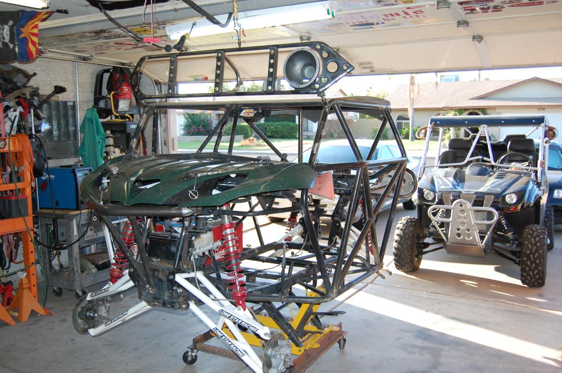

i started by pulling the drivetrain and selling most of it, then cut out all of the tubing i will not need. there was 2x more that i did not take a picture of.

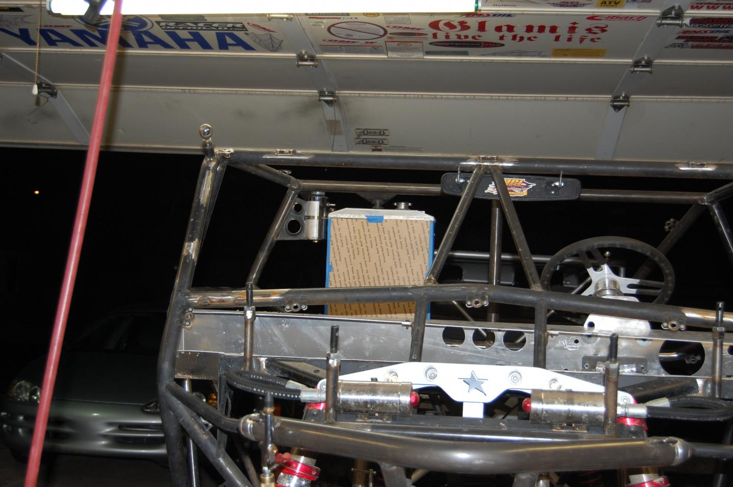

then i was bored this weekend and decided to make an actuated lightbar with the 4 Hella 55 watt hids i stole of the wifes rhino.

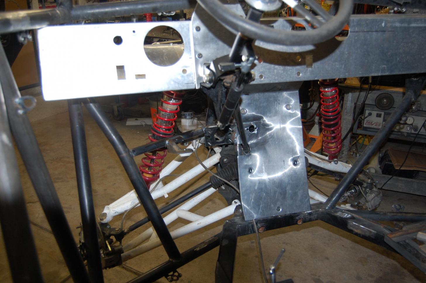

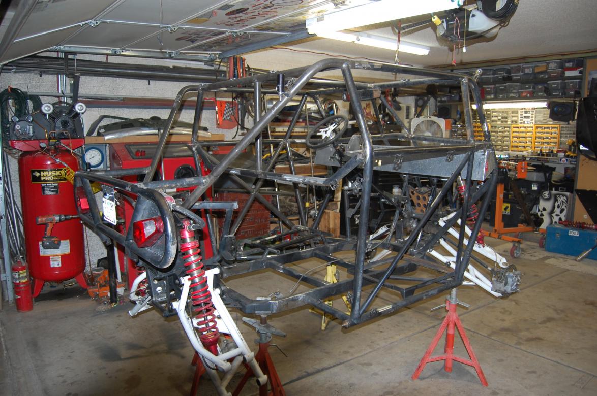

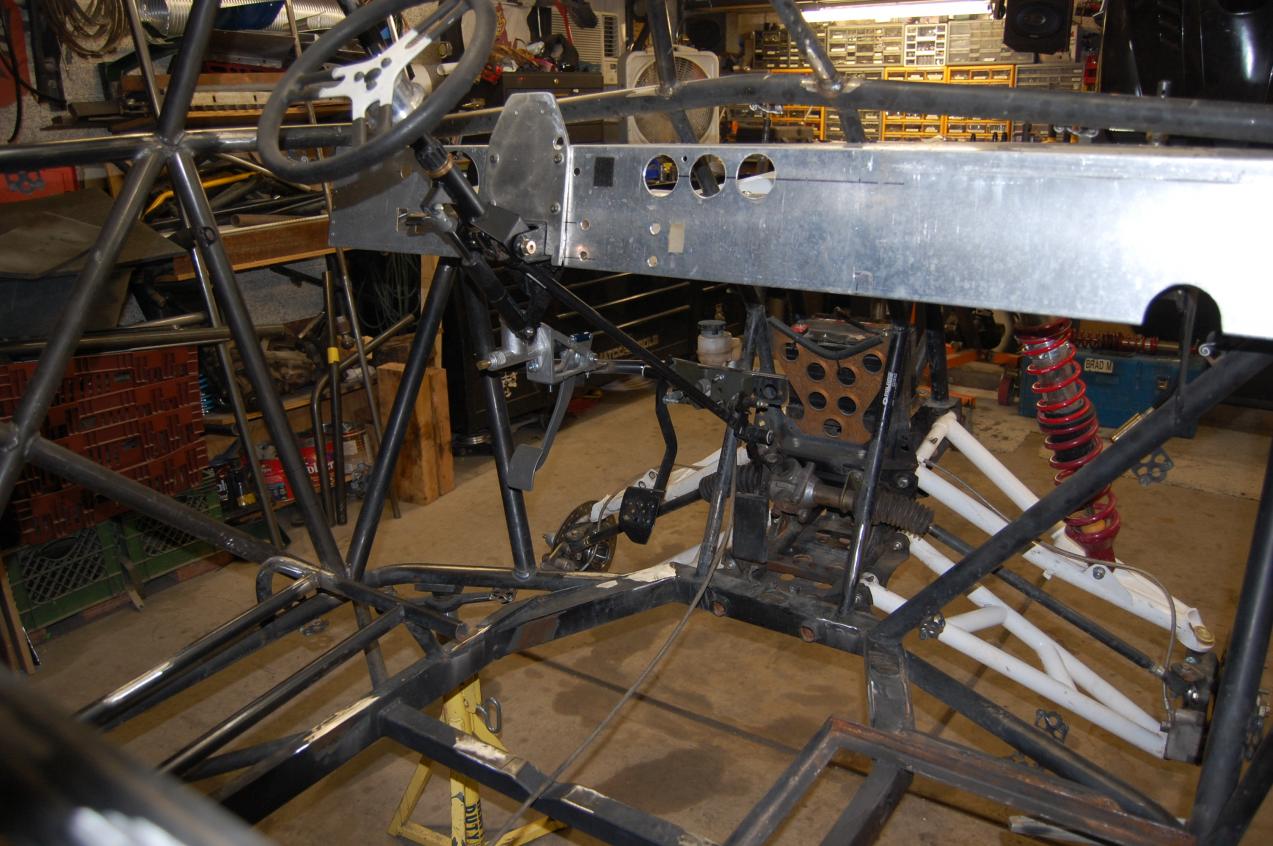

next was to add the clutch pedal
Good start. Glad to see you went with a reverse hanging pedal. Just never understood why people do these motor swaps and let the clutch resi. hang out in the wheel wheel just waiting for a rock to hit it and the limited sire size.

yeah i was worried about the resivoir too thats why i did it. i was looking at the dual cylinder reverse hanging brake pedal but $330 was not in the budget this time. that along with paddle shift is on the to do list when i have some extra dough.

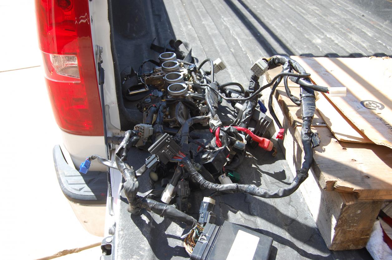

motor comes in freight tomorrow and i will drop it off at wellers for mount mock up and take the wire harness to peter d motorsports.

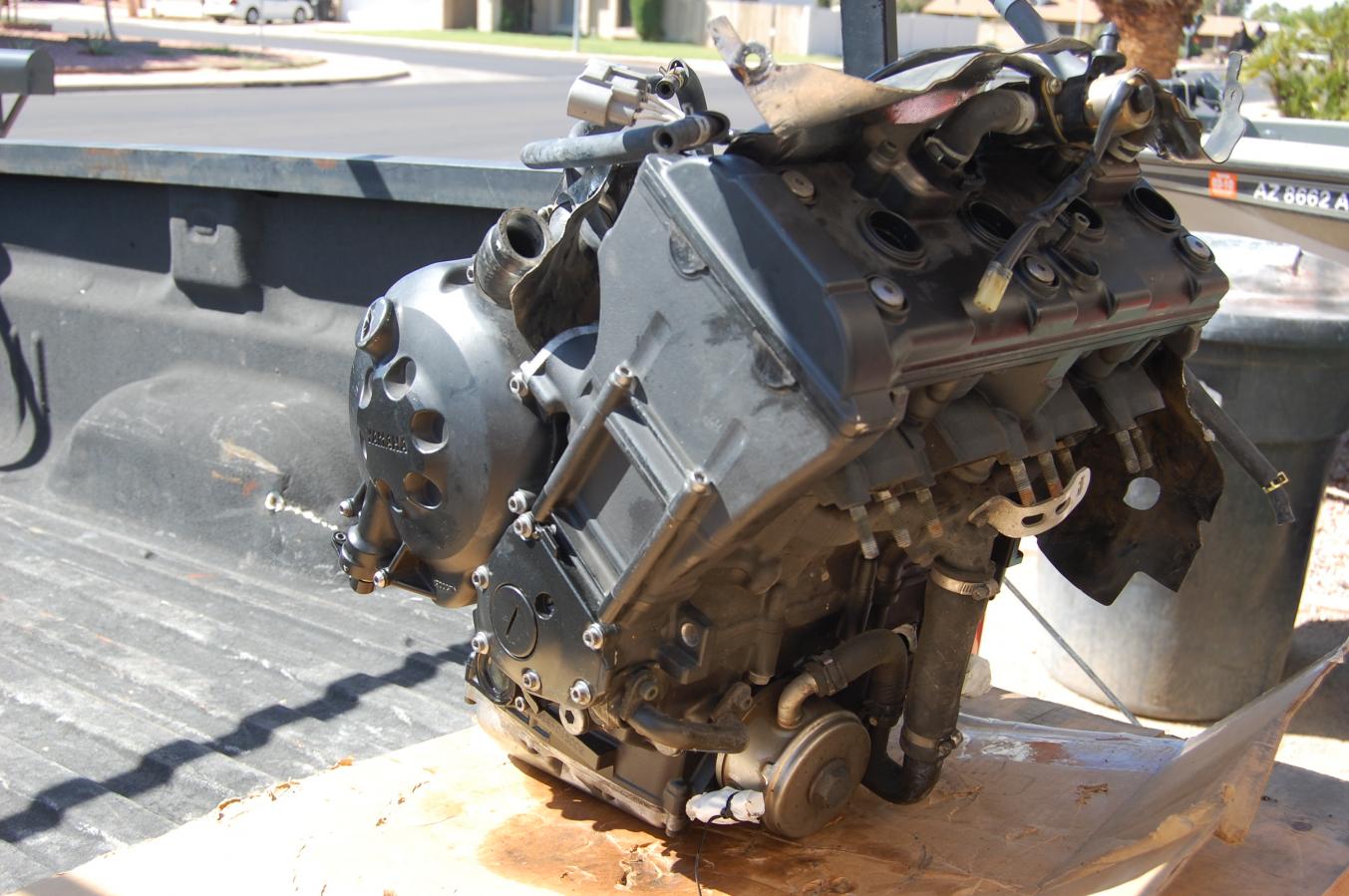

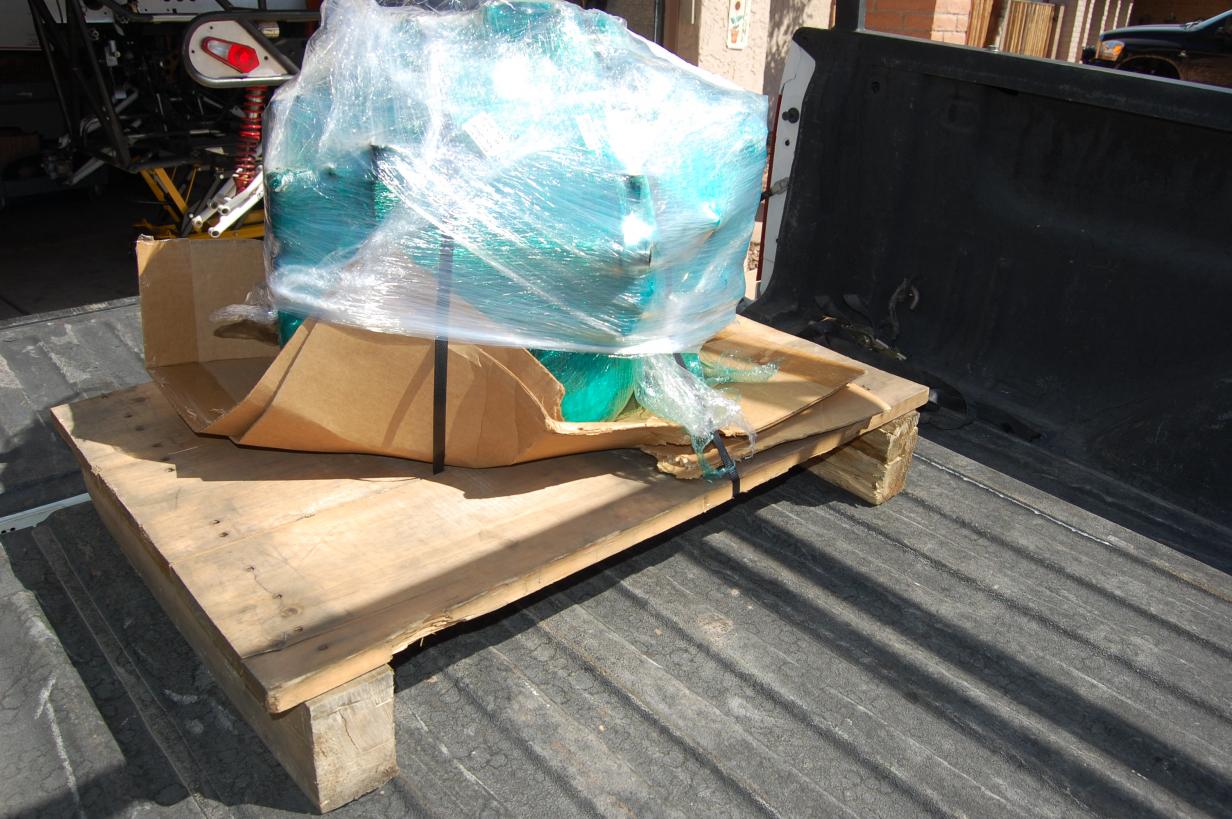

i finally recieved the motor i had it in my truck for about an hour then dropped it off at Wellers. gotta get engine mounts made, they look alot like the 07, 08 mounts but Jason had to make sure.

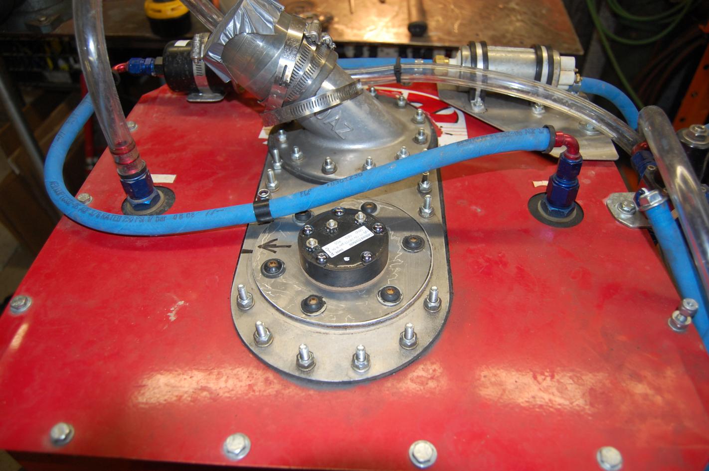

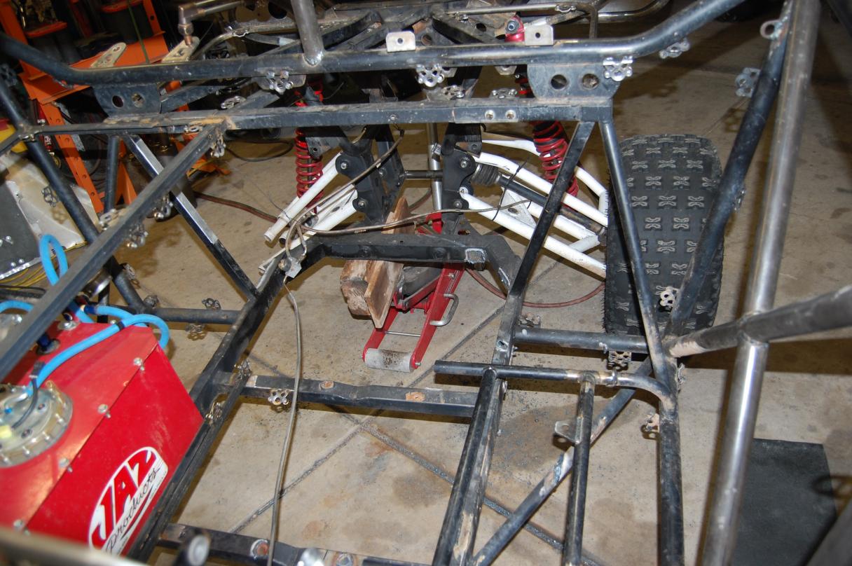

then i installed a fuel level sending unit for my new Dakota Digital 4 function gauge. the stock polaris sending unit would not work with the new gauge so i ordered a sending unit from Black Rhino.

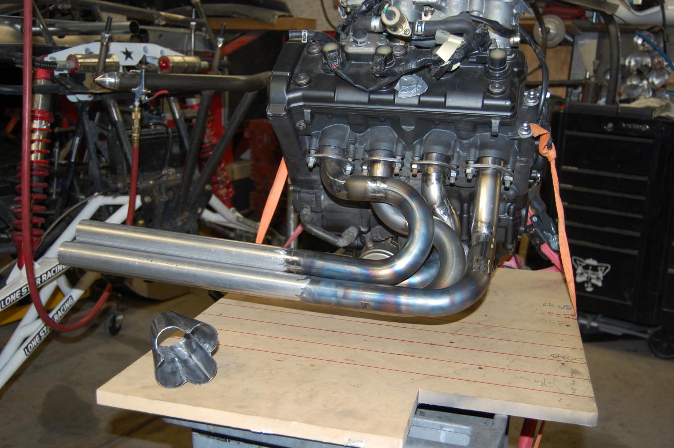

my update for this last week. made a header from scratch what a pita!!!!! i have to wait untill i mount the motor to cut the header tubing and 90 them to the rear.

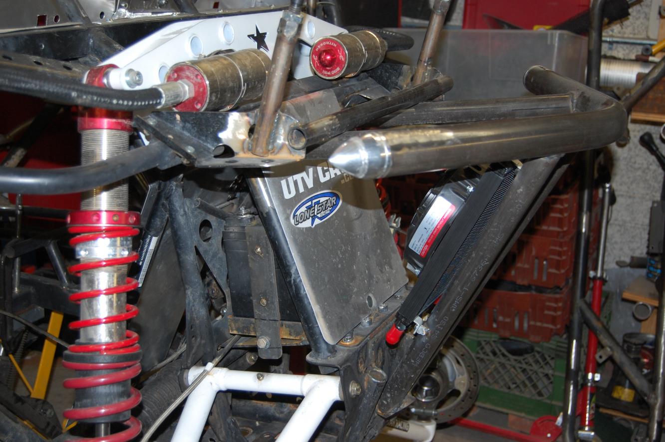

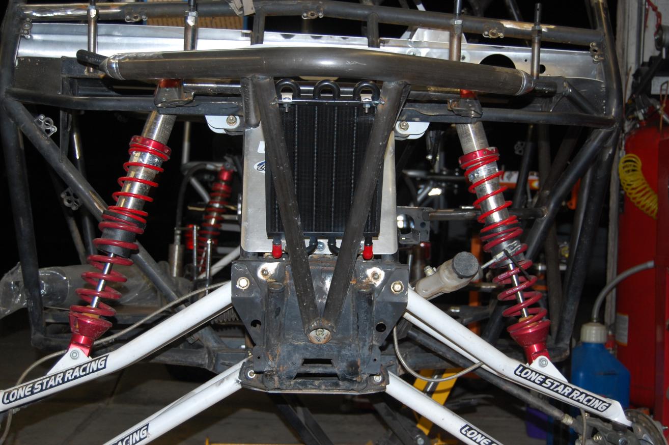

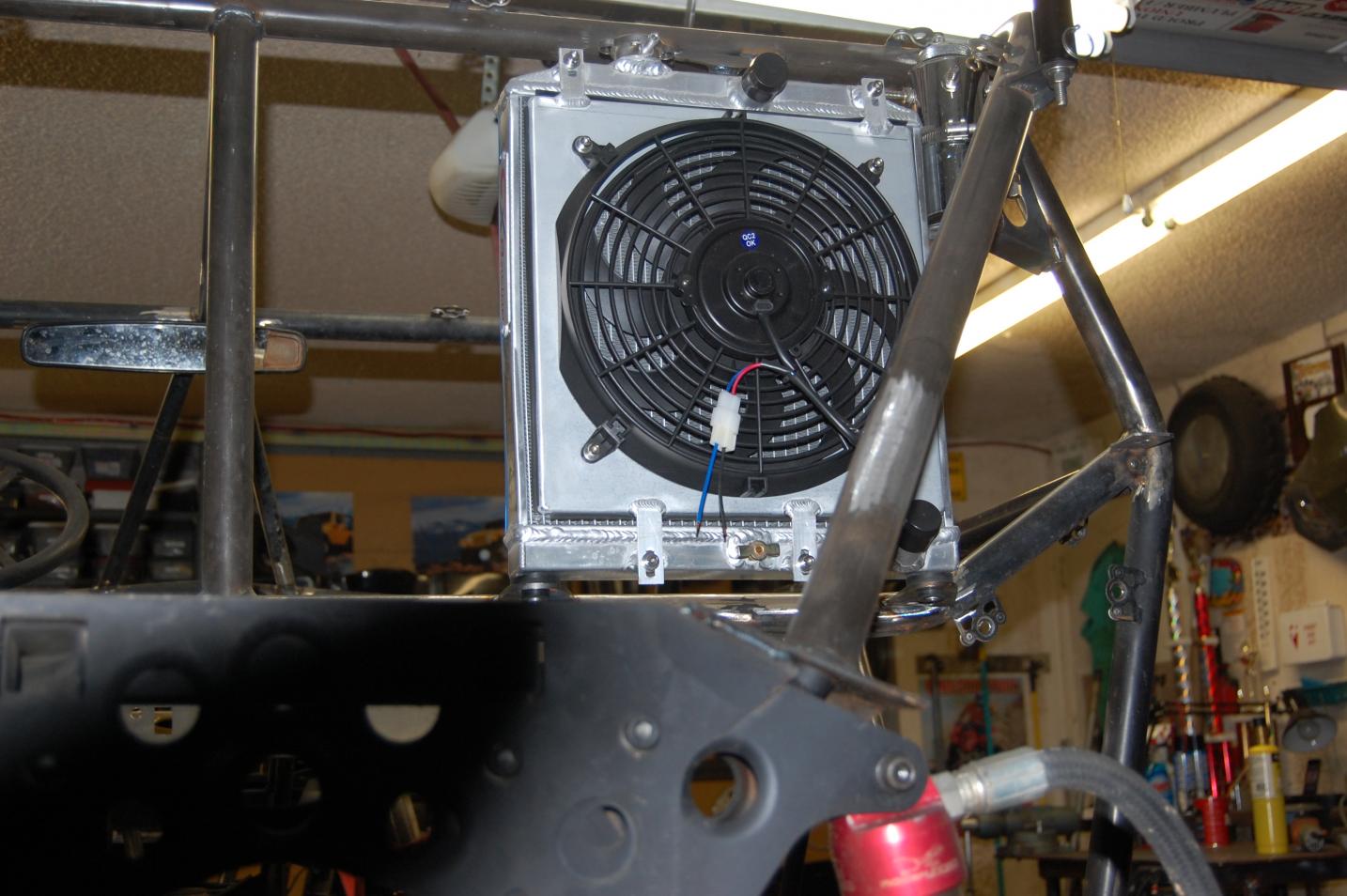

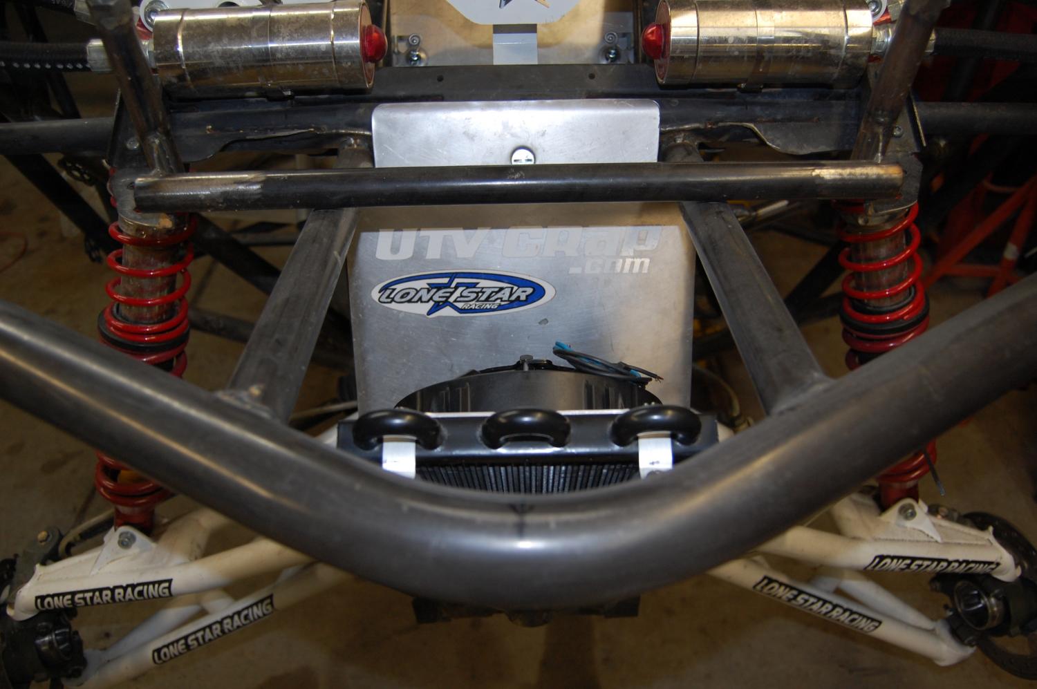

i also mounted the radiator. which is a 2 row Honda civic racing radiator with shroud and fan for $150 shipped to me. damn UTV tax for the stock replacement huh?
i also cut off the rear bumper so i could mount it further rearward and add a wheel to it for a wheelie bar. haha no really with the 26" 16 paddle tires at full compression they would have hit the bumper.

you could not afford it. trying to make them both 31" long is the bad part. i am not running a passenger seat so i dont have to worry about the clearance there.
when in doubt when ordering u bends order long turn and 2x what you think you wil need. i could not even bend a 45* in straight pipe with my bender due to wrinkle on the inside of the bends.
