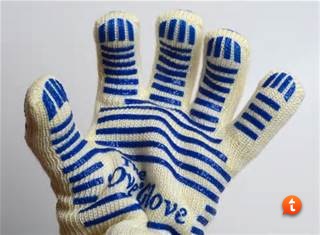

Can you use the oveglove to change a belt on a hot clutch?

...I'm stealing Rusty's idea of the Ove-Glove
