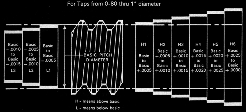

It's classroom time. School me, because I'm self taught, and only an armchair machinist. What class threads are tapped in the aluminum, and how do you address the galling issue from dissimilar metals, galvanic corrosion and atmospheric oxides? Black oxide? Teflon coating? If I just flew over your head, maybe Big Jim can chime in. He's a grizzled old veteran when it comes to machining!

we normally tap Gh3 and we like Nickel Anti Seize .. aluminum isn't that bad with galling on the larger 3/8 and up but the smaller stuff and using hand tools instead of power tools helps .. oh boy if you wana see some galling go with chrome plated bolts lol
we don't do it but even a coat of carnauba wax will stay off oxidation on fresh machined or polished aluminum

It's classroom time. School me, because I'm self taught, and only an armchair machinist. What class threads are tapped in the aluminum, and how do you address the galling issue from dissimilar metals, galvanic corrosion and atmospheric oxides? Black oxide? Teflon coating? !
We use Antiseize in all bolts going into dissimilar material (steel bolt into aluminum / brass, cast iron, high stressed parts). On all aluminum to aluminum connections (AN fittings, shock cross overs) we spray with teflon lube. Even anodized AN fittings can gall if dry (fighting a galled fitting under a full aircraft fuel cell is not fun).
