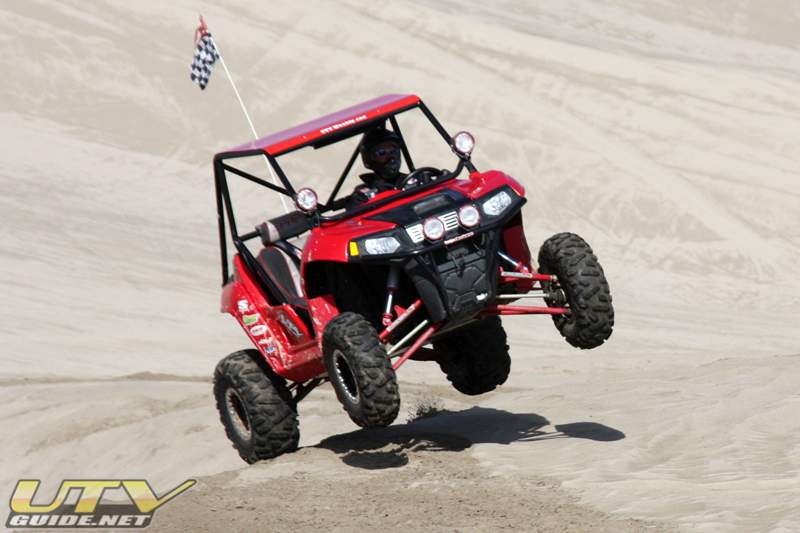

Brings back memories of my 2008 RZR build! Started out looking just about like that, and ended up looking like this:
Here are a few parts that I used on my build that I really liked:
SSV stereo rocks
Fox shocks
OMF beadlocks
Baja Designs Fuego HIDs (you will love them)
PRP Seats
Simpson harnesses
Fullbore plastic
Holz/Kroyer Stage III engine
Muzzys exhaust
Factory UTV skid plate
Rugged Radios!
