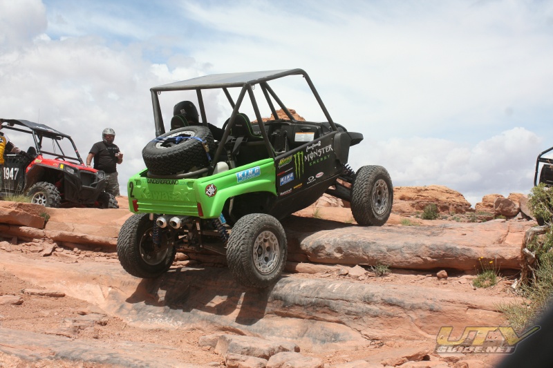

I would hope that Jagged's setup is in the 55 lbs range. The picture above is what I am running - 31X1150-15LT Growlers mounted on 15" OMF billet centers. Bigger than Jagged's setup (taller and wider) and this is 62 lbs.
that is alot of unsprung weight to be pushing around. :eek:
