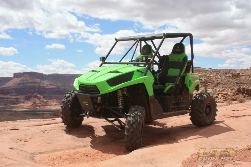

I just got back from 4 days of rock crawling in Moab. My new Teryx performed beyond my expectations. I am running 26.5" Pit Bull Rockers and they grip real well on the rocks, but I am seeing more and more UTVs running LT tires and would like to explore this a bit more. Pit Bull was originally going to make 27.5x14 Rockers, but they no longer have a timeline on making them. The 26.5" Rockers are basically a 27" tire, so I would like to look at something that is 29" or 30" tall.
Here is my current setup: 26.5" Pit Bull Rocker XORs on 14" wheels.

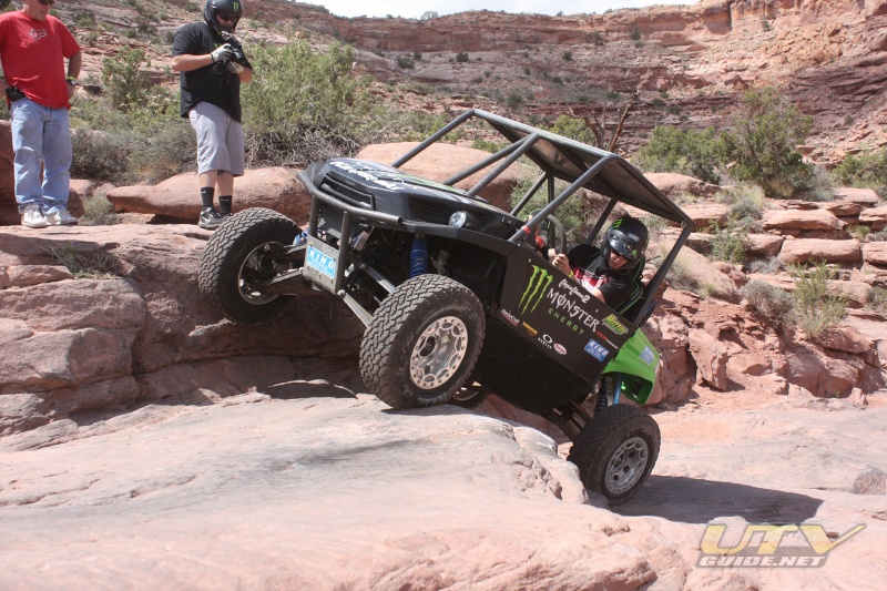

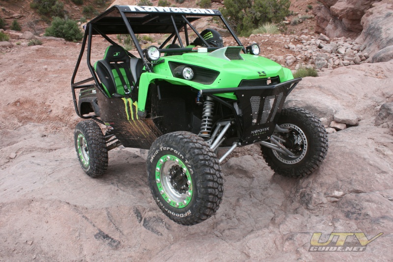

Reid is running a BFG Mud Terrain. I think he said 28" x 15".

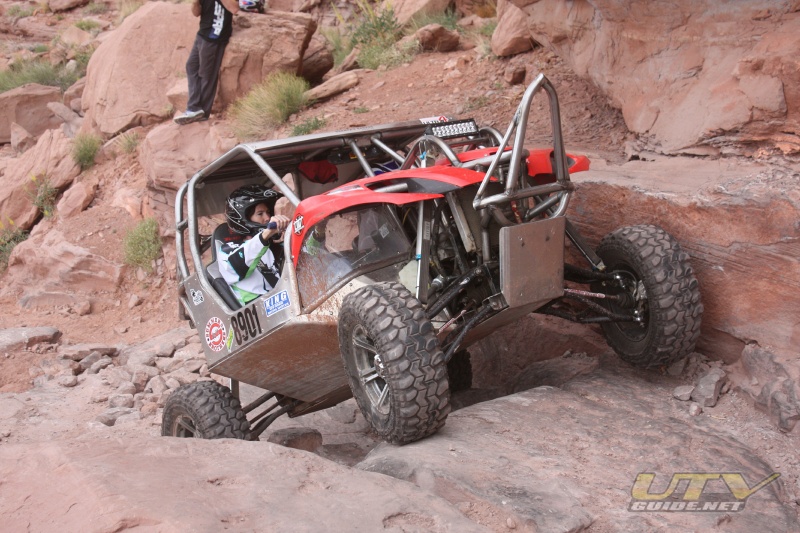

Casey Currie is running 27x14 General's. Looks good for desert, but I'd like a little more height for the rocks. 14" is cool though since I could use my DFR Baja Cripplers.

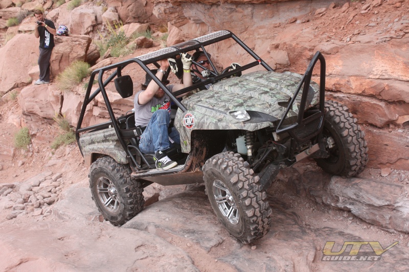

Jagged is running 30x9.50R15 BFG KM2's. Really like the look of these. Wondering how they would do for rock crawling on a light vehicle like a UTV. Maybe some cutting and siping?

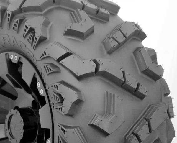

Raceline came out with their SxS MT last year, but I haven't seen much about these. They are available in 28x10-14, 28x12-14, 30x10-14, 30x12-14.
Other than Raceline or a mud tire, it sure doesn't look like there is much available with a 14" wheel.

Reid was running pretty high PSI in his BFGs the first three days (he didn't check until day four at Area BFE). I followed him quite a bit and I wish he would have had something below ten for the first couple of days so I could have observed more. From my perspective, my Pit Bulls had better traction for sure. But his BFGs had the edge in tire circumference (crossing the Golden Crack) and ground clearance. Reid is running 15" OMF beadlocks. If you want a beadlock, I think OMF is about your only option. Thankfully they are good as well!

* Raceline Wheels new SxS MT Tire - Available in 28" and 30"

I am sold on the tall LT tires! Reid's aka Team Green's BFG's worked awesome in the rocks and he didnt even drop the pressure all that low I dont think? Casey's aka IM0T0's General Tires started to hook up really good as they began to break in.
Not only do the BFG's look awesome but they worked great!!! As the power increases in UTV's I think we are going to start seeing the use of more of these LT and taller tires.
I am planning on using the same KM2 and OMF wheel set up that Jagged X has on my next build!

The 30X9.5-15 KM2 weighes 41lbs. Not sure what the OMF weighes....
