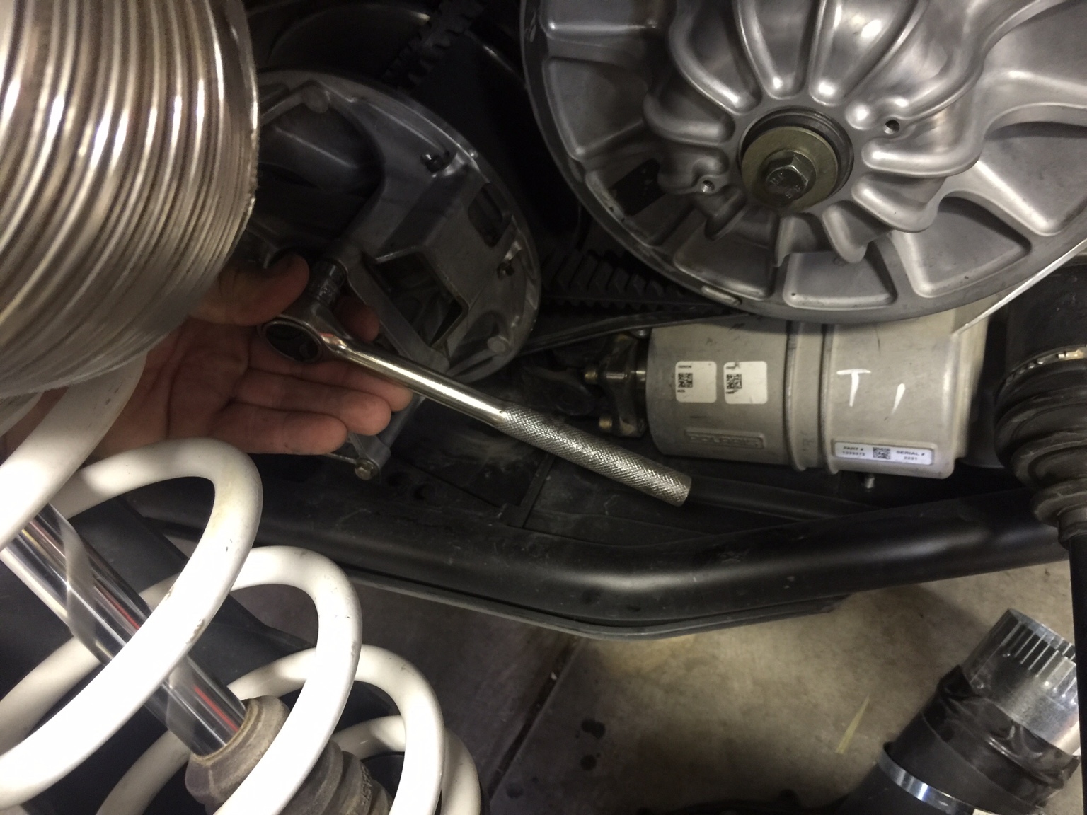

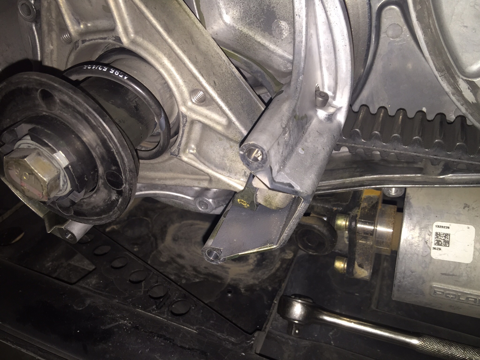

XPT Primary wearing out
Thanks for your input Glamisfan! Yeah in those pics your clutch looks like it's moving all over the place... Keep on them and make them fix it! Another guy on here said he can't drive the turbo without hitting the rev limiter all the time, even pussy footing it. Is there a problem with that too, or is this because maybe he's just not used to the turbo car?
I sent 4 emails over the weekend to popo and called this morning. Im riding them hard!

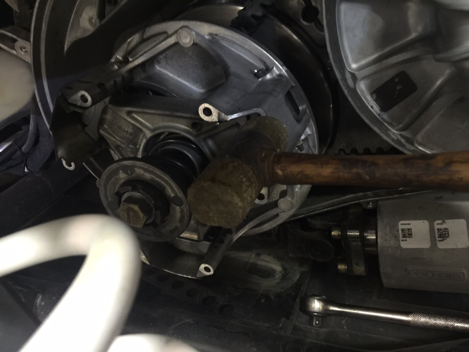

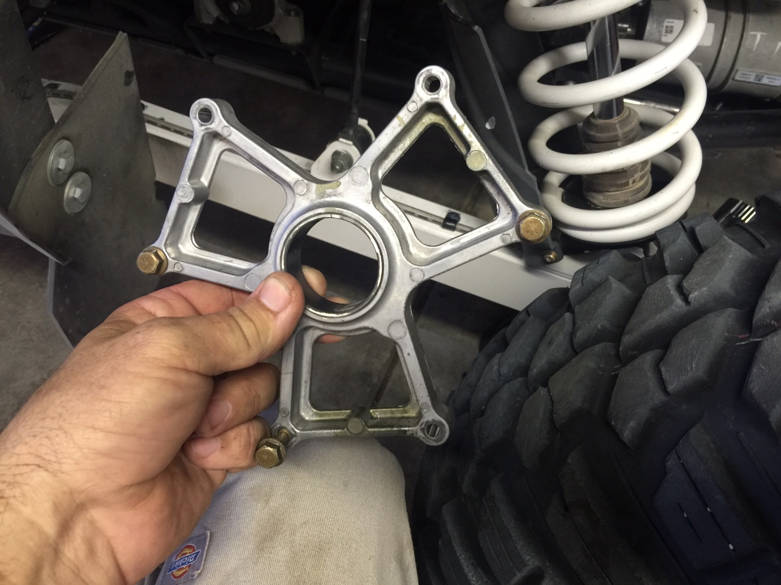

finally got this thing to upload a pix.
glamisfan send me an email lets chat. adam@airdamclutches.com
again this was a machine with only 55 miles on it. the dealer was supposed to get it warrantied, but not sure on whether or not it actually was. at the race, i had to sell him another clutch because i didnt have any other choice. this wouldnt have made it thru a race.
View attachment 12676 View attachment 12677

pretty sure they are still working on secondary. But your problem will be the same with an STM primary just way more expensive piece. STM works great on high HP for short term, great tuneability, great selection of springs, but they weir out in long term/desert racing anybody that drives the snot out of there on trails 3-5k miles on unit.
i have some super cool new parts about to be out for the desert racers to give them a bullet proof race package. i already have the average trail rider figured out. yes we use STM clutches in many of our applications. they are a good clutch for what they are designed to do, if you race full throttle with them you will need to rebuild them. they have a lot of moving parts and these parts wear out and need to be rebuilt if you plan to race it. not every application uses the STM clutch, sometimes we use stock clutches, sometimes a mixture, sometimes we have our own custom parts. regardless of what you do or how you do it i try to figure out what works for each type of riding and usage and sell each owner a kit that works best for them.
i have been working on the XPTurbo clutches since august and i am super super close to getting the desert race package fully dialed in to a bullet proof standpoint.

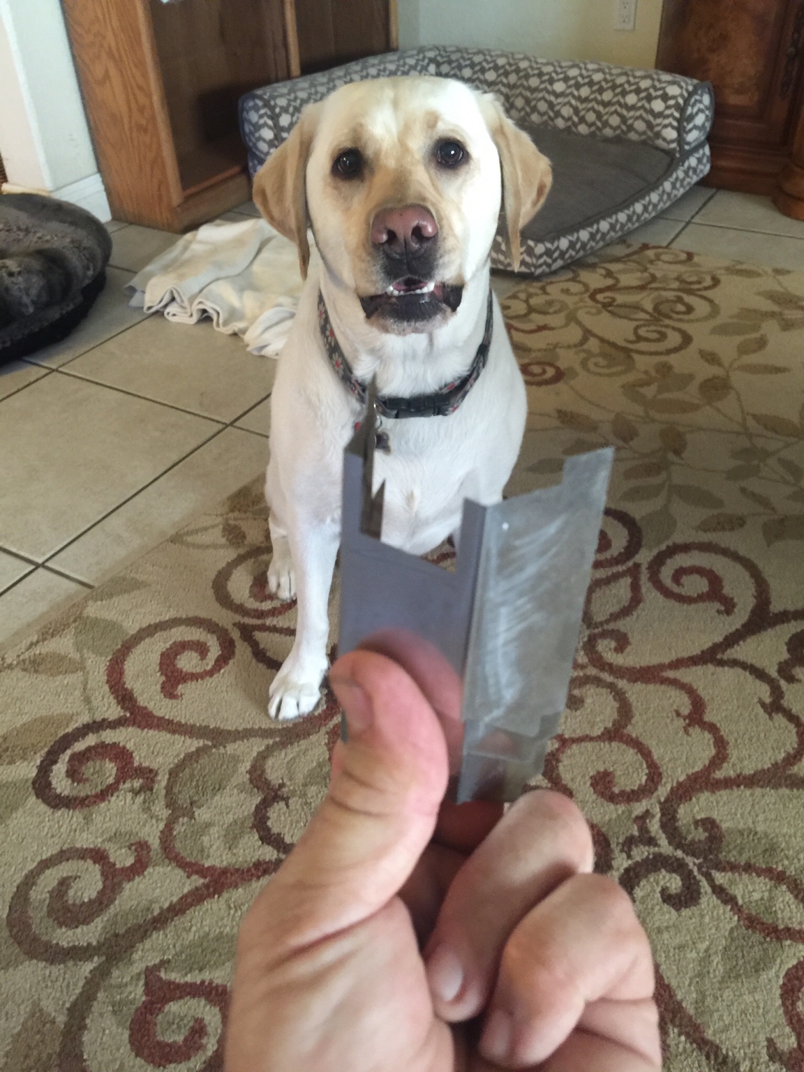

We are also about to have a different material slider that's not so hard and abrasive. I also have my own version of slider plates that go into the primary as well. These are all ideas to try to make the stock primary be more reliable and hold up under long races.
