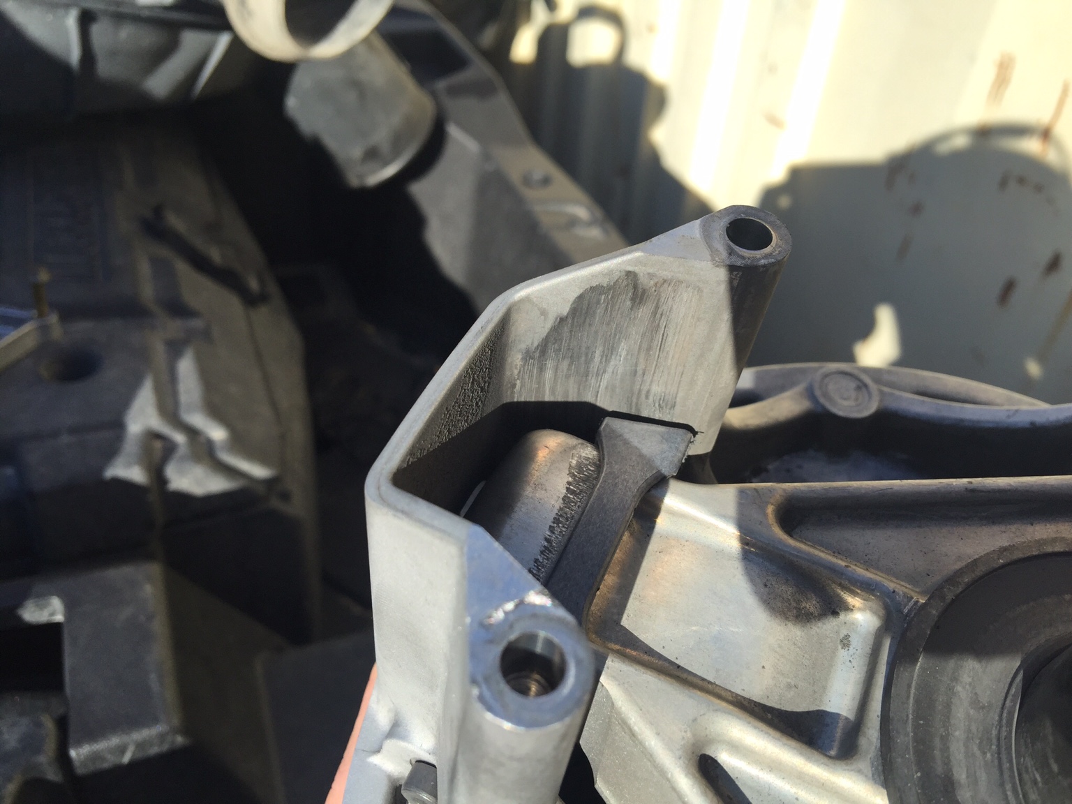

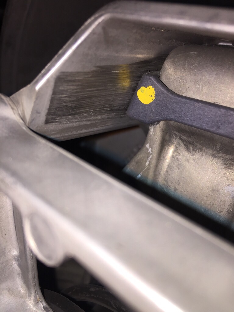

Just giving a heads up that the plastic sliders in the primary clutch are wearing out the aluminum on the primary where the sliders rub. Below are pictures of mine with 500 miles on it. I saw one at the dealership today that only had 104 miles and 10 hours on it and it had noticeable grooves in the aluminum that you could feel with your finger. Polaris seems to be sticking their head in the sand about the issue so far. Polaris denied my claim for a new primary, but then said that they would on good faith replace the three plastic sliders. The dealer and I looking at my primary and talking about it, he said that replacing the sliders will only probably last 100 miles because of the gouging in the primary.
Has anybody else noticed the same thing on theirs? Anybody have any solutions for this? Are any vendors working on better sliders that will self lubricate as they wear and that are actually softer than The aluminum so they'll wear out and not the actual primary?

i saw one at the races this last weekend that had that plastic triangular shoe broke in half on a new stock car with 55 miles. i hope its not an issue once we get the clutches sorted out. yours are clearly full of belt dust and sand. are you running with the cover off or on? that much abrasive grit between the shoe and the aluminum is clearly not the way to go

Adam, the plastic wearing the aluminum is going happen no matter what tuning you do! It's a design flaw, IMHO.
And yes, all that crap sitting in there is very bad. Thing is, centrifugal force holds it in there. So the only way to get rid of it is to take the cover off and blow it out all the time! I was wondering if it would be possible to drill a couple holes in that part of the primary so that the dust could sling out instead of accumulating?

well originally when i looked at the pix it appeared as if they were melting, which they can and will do if you start slipping a belt badly and dont let out of the throttle. i have seen them melt. which clutch calibrations can fix all the slipping.
yours is definitely full of dust and sand which has turned black from belt dust. the abrasive mix is definitely hard on aluminum parts. maybe its simply beacause of the sand you guys ride in out west we arent seeing the exact same things on the cross country racers back east. belt dust is common but i havent seen one wear out the clutch yet.
with how that tower of the primary is built i dont really think it would hurt it to drill 1/4" holes opposing each other in the side of the tower to let all the belt dust sling out of there. i cant say i have done it or will do it but i dont think it will hurt the clutch. there is a ton of meat there and the engine harmonics isnt as bad with this engine as the older XP1Ks so i dont thing you will have any additional harmonic distortion or resonance in the clutch with drilling a little weight out.

I am going to give my opinion. It is just that, an opinion and not an accusation. This damage looks as though someone spayed your clutch with an oily lube at some point for some reason. This would cause any duct or sand or debris that could enter the clutch housing to stick to that oily lube. Once any debris sticks to lube whether it is aerosol, clear or what have you. With a clutch that constantly slides throughout the rpm range this is going to cause damage.
Your clutch must remain dry and oil free, especially in the desert. If you go out in the rain or while it is very damp. Moisture is going to be in the clutch and that can collect dust and sand. It really sucks! I feel your pain and I am not taking Polaris side. All of us must share information and that is all I am trying to do.
Check your clutch before or after you ride. Get a clutch cover pin set to ease removing the cover. On these clutch checks all utv owners should be doing; make sure the clutch is clean. Remove the belt, wipe down the sheaves and ensure the primary and secondary are oil and grease free. Check the clutch exhaust for blockage and never spray any of your clutch parts with tap water. The sediment and calcium is such a bad element for your machine.

I assure you no one sprayed an oily lube on the cvt system. The 3 channels that the sliders ride in don't let the dust escape due to centrifugal force.

One more thing. There's only a handful of us with verified primary wear. And then yesterday a guy with 670 miles posted a pic of his primary, and it looks good. And it has a much different wear pattern then mine. So now I'm really wondering if it's just a bad batch of soft aluminum? Here's the pics. Top is the other guys that looks what I'd guess Popo expects them to wear like. Bottom pic is mine.
