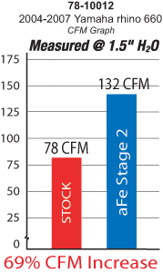

this is the intake you need for that exhaust to maximize air flow
an aftermarket stock replacement air filter isnt good enough for a 175 main jet.
i prefer the afe its a Little nicer with the aluminum intake but yes 175 main with air intake and a cdi is what is needed

the stock replacement filter you have will work, but not with a 175 main jet. to get the max power out of that exhaust you need to upgrade your whole intake system from the stocker to either a K&N highflow or the AFE highflow as turbo stated. the K&N will not suck sand if oiled properly and used with an outerwear.

I chose the AFE because it has the same cfm as the k&n but this is the selling point kit runs 200.00 just like the k&n but you get 2 intake filters one oil less and one oil filter a outerwear prefilter and replacement air scoop that is really good looking for the center console ..it also has a better way of mounting the unit and it alls has a deflection box to keep most sand out and its quieter than a k&n less intake noise
