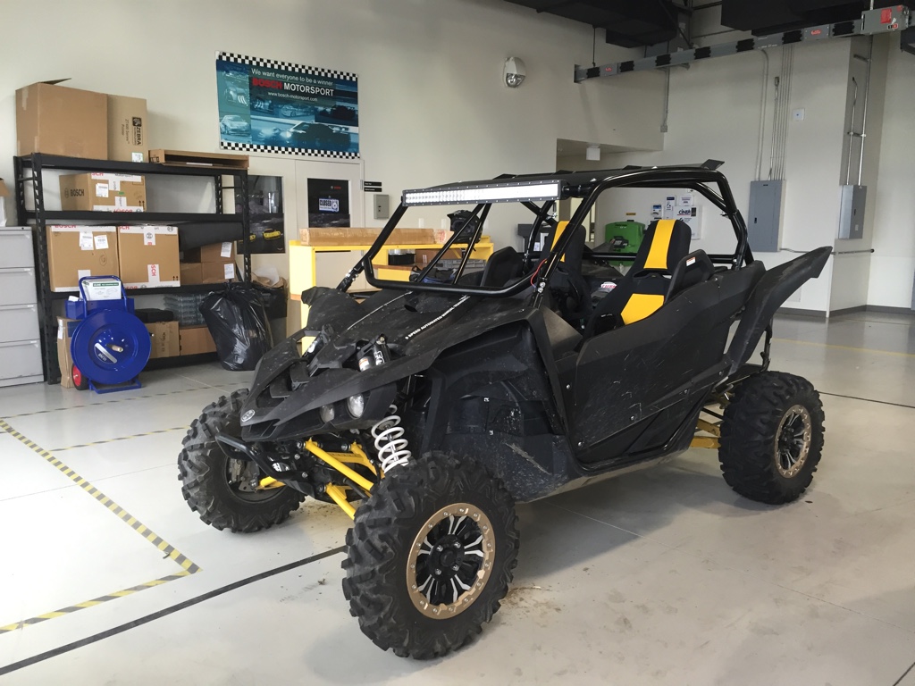

TIred of failing CVT belts - What do you think of an Automated Manual Side by Side
Does any one have the capability to measure how fast they can shift the stock trans?? Measure engine speed or clutch and shifter position we dug right in and didn't measure this for comparison. Perhaps a slow mo I phone video of the driver shifting could be a crude way of base line time to beat.

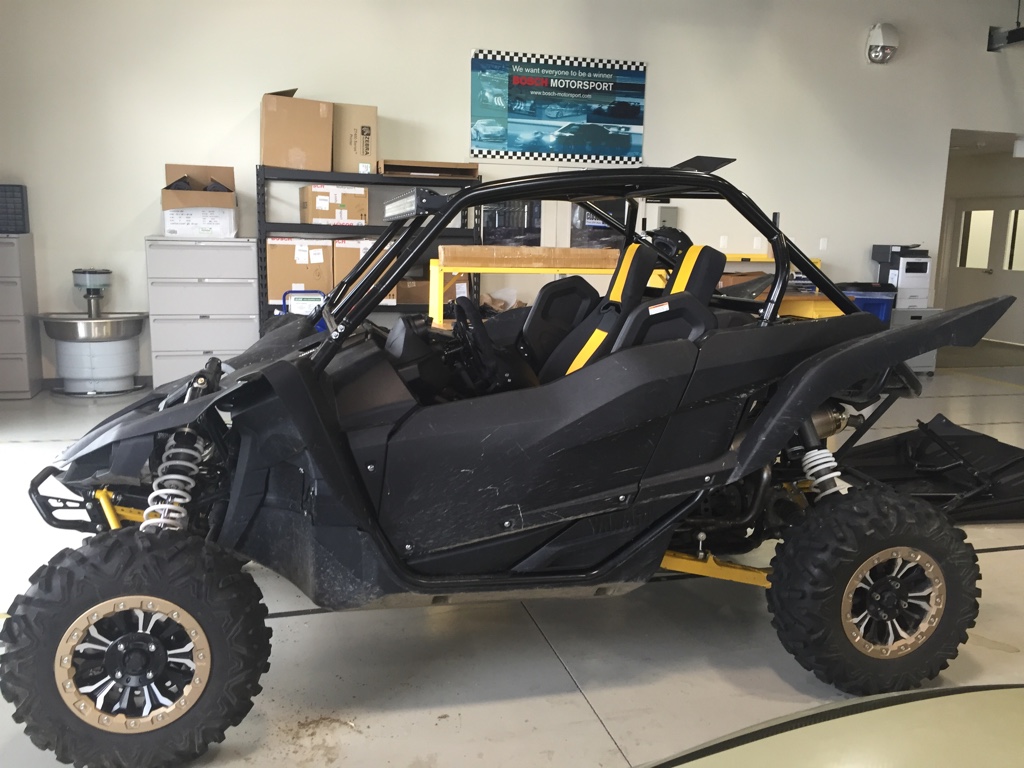

Shift actuator location directly below oem shifter location
No clutch pedal!

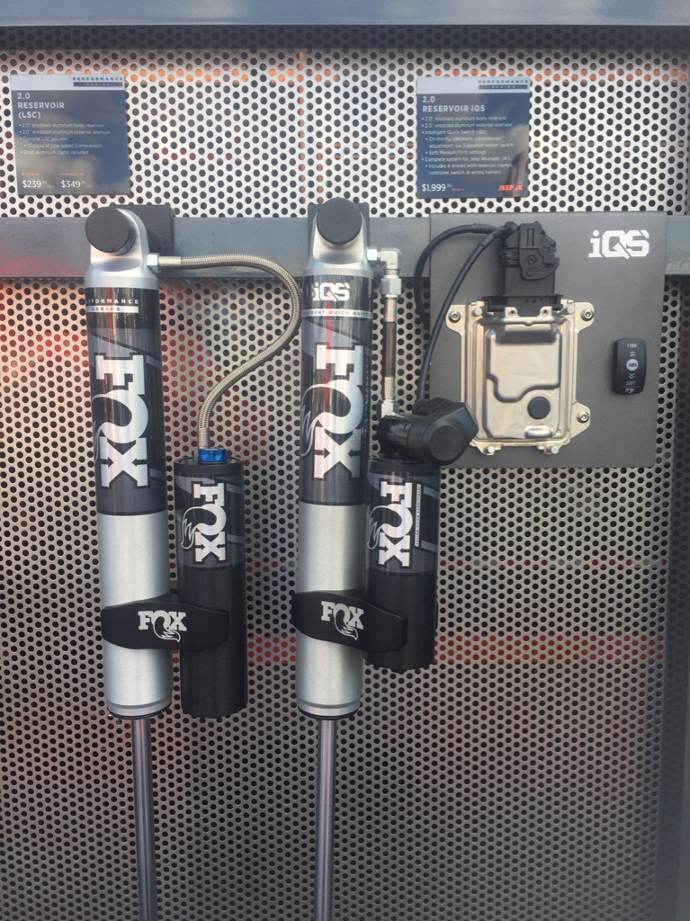

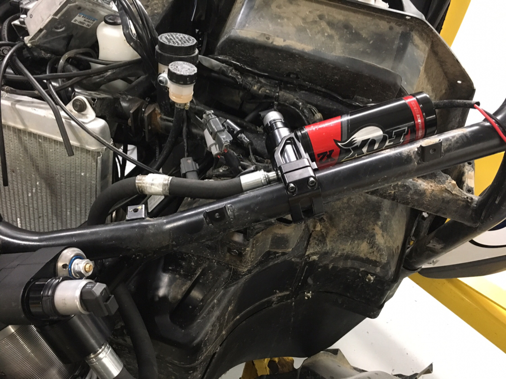

Been awhile but we have made some new developments. We are converting the Yamaha yxz1000 to a Bosch engine controller so we can have a better torque management during launch and shifts, updating the transmission control software with more intelligent shift map selection, and adding custom shocks with semi active damper controller( rebound and Compression controlled electronically). Here is the new engine controller roller running in the test bench.
We added rebound and compression control with suspension modes that can be switched via an app on your phone on the fly. You can also view the settings live on your phone.

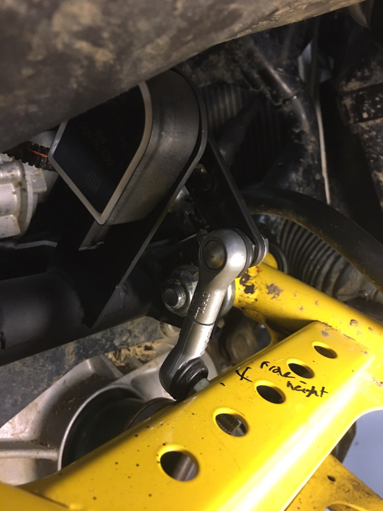

The control has steering wheel angle and accelerometers for controls and ride height to help us with the calibration.

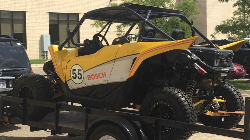

Been awhile since the last update, since our last demo we have made some good steps towards improving shift time and always gandling the gears to fit the situation.
Most of this is with new software for the engine controller and transmission controller.
The engine controller is getting tuned with in cylinder pressure sensors. It’s pretty killer set up. It allows us to look at cylinder pressure real time to optimize the spark advance.
This will allow us to have more accurate torque numbers when requested by the driver and the transmission.
With Bosch engine controllers on Polaris or-can am utvs the pedal requests a torque value not a throttle angle. So when the driver requests torque the engine controller tells how much throttle fuel and spark is needed to produce that. The more precise that is the better job we can do banging the gears when the transmission asks for torque reductions or torque increases for up and down shifts
Being able to automatically shift and shift sub 70 ms is our goal.
