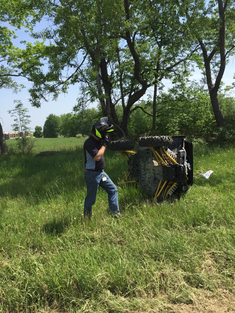

One of the investors was having a little too much fun with the paddle down shifting into a turn hooked a rut and flipped it 1.5 times.
Cars ok cage is not!
Any recommendations for a aftermarket cage???
