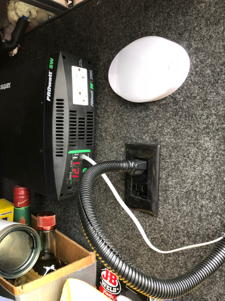

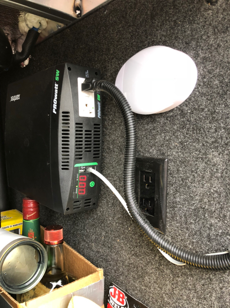

So far as the solar It came pre installed different than Joeys. I have several plugs that you can use with the inverter or shore power. All four TV outlets, a outlet in the kitchen, one in the bedroom and another in the outside compartment near the central vac. A simple unplug from the shore power to the inverter or inverter to shore power. I can leave mine plugged into the inverter while the rest of the trailer is on shore power. I leave mine plugged into the inverter all the time. I will try and get some pics. later. So far as the batteries I installed them myself.
A side note, My second toy Hauler I installed every thing myself solar inverter and batteries. The way it was set up, if I had my inverter on and plugged my trailer into shore power or used my generator I would have fried the inverter just like Joey was stating. The way my new trailer is setup is awesome.
So here is a picture plugged into the inverter and a picture plugged into shore power/generator. So the cord you see is on its own breakers and dedicated to all the plug-ins I explained on previous post. So either place you plug it in is not conflicting. Now if you had the cord plugged in to both outlets at the same time (inverter & shore power, which you cant) you would fry things.
So here is a picture plugged into the inverter and a picture plugged into shore power. So the cord you see is on its own breakers and dedicated to all the plug-ins I explained on previous post. So either place you plug it in is not conflicting. Now if you had the cord plugged in to both outlets at the same time (inverter & shore power, which you cant) you would fry things.
So essentially is a extension cord that feeds the outlets and you have the manual option to switch from shore power or battery. Sounds easy enough if all the outlets run off the same breaker.
Yes
99.9 percent of the time I am dry camping so I just leave the cord plugged into the inverter with it on until I pack up for home. I would say if you are only using one 12v battery turn the inverter off at night, when you go to bed or when not in use.
