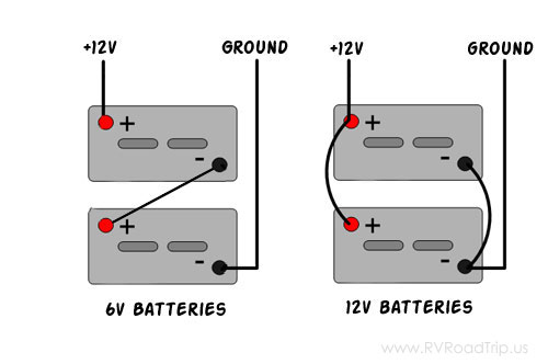

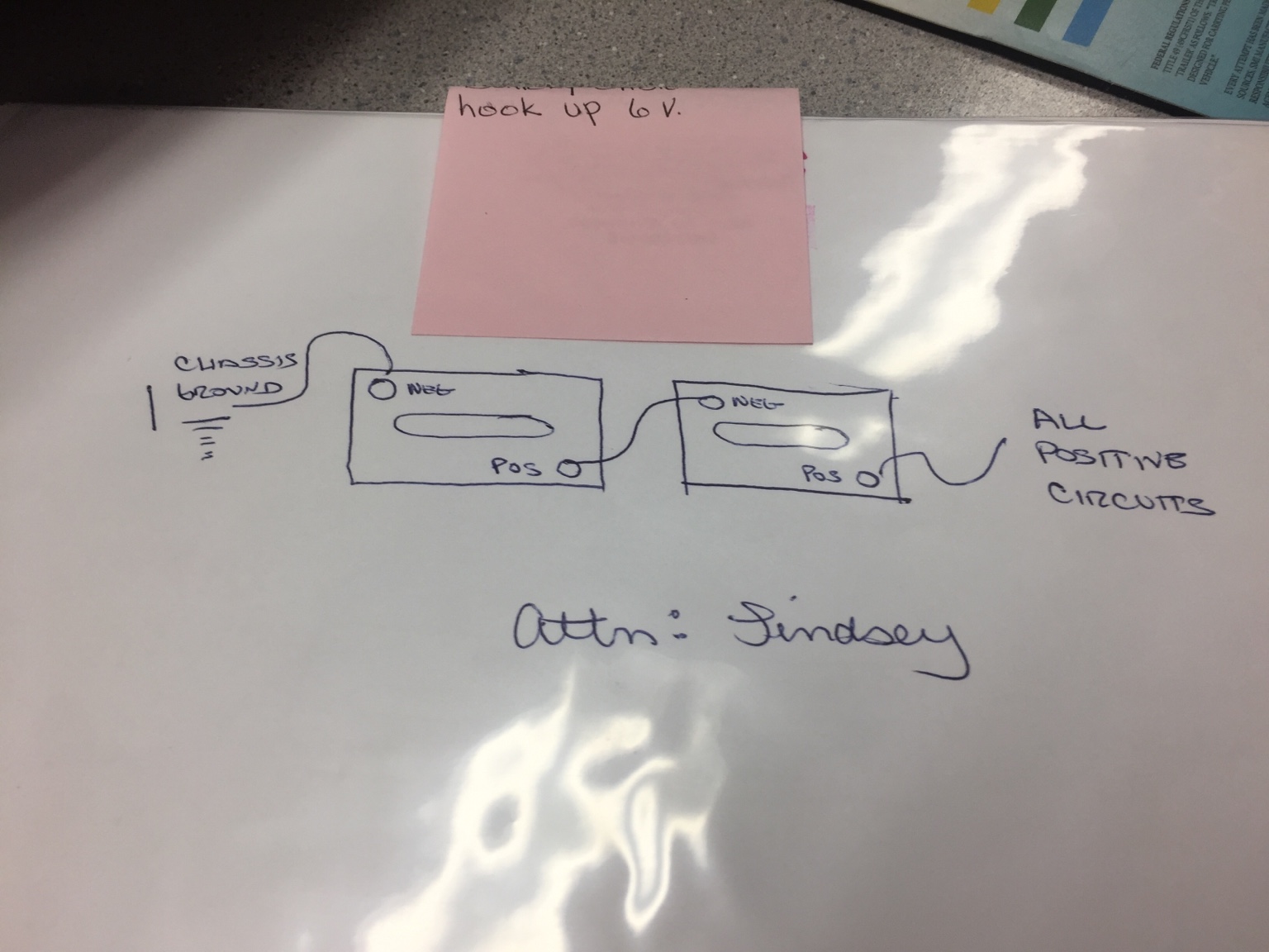

I am looking to install two 6v batteries into my new Attitude 5th wheel. Currently this monster has only one 12v so you can imagine how good that works lol.
Anyway, I am looking to see if anyone knows where to get a kit for wiring the two batteries together in series as thats what I assume is the best set up??
Any input or advice?
2 batteries positive to negative.

It is pretty straight forward. I just switched to 2 6volts.
I've had good luck with the 6v batteries from Costco.
The only thing you need to buy is one battery wire to connect the positive on one battery to the negative on the other.
