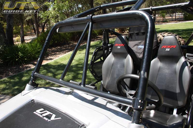

A GOOD SOURCE TOLD ME YOUR GOING FOR THIS LOOK JIM :D

how tall is the top of the cage from the floor?
not that it matters but your pillar names are messed up.

Thanks... The bottom of the roof bar is 50"s from the floor. The reason I was calling it a "C" pillar is because the will be another vertical tube right after the "a" pillar.... Real similar to the one on my old car.
And yea.....after my corn dog I really thought about the placement of that bar.....If I had ever side rolled..it would have been over.:o
