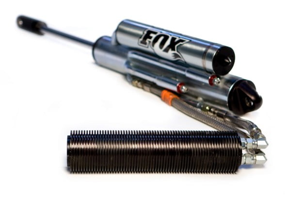

FOX Racing Shox has just released the “ECS†External Cooling System as an option on all new and existing FOX bypass shocks. The ECS is our latest development to come out of the Race Application Development program (RAD) that works with top motorsports athletes to devise and develop new technologies under the most extreme racing conditions.
The ECS cooling system, code name “cactus coolerâ€, effectively drops fluid temperatures up to 100 degrees. The ECS does not use any pumps or fans; it uses the normal motion of the shock piston as it cycles up and down to pump the fluid through fully adjustable, bypass check valves into a billet aluminum and stainless steel heat sink. After excessive heat is allowed to escape, the cooled fluid continues back to the shock completing the cycle. The faster the shock works, the more fluid is pumped through the cooling system.
