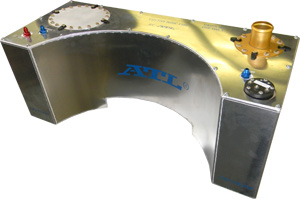

So as for the fuel cell, I assume there is going to be a standard can/bladder racing cell and it's going in the rear cage behind the engine?

Would love to see some more pics. Especially of how the fuel cell is going in there. I pulled the trigger on an X3 RS and figuring how to safely put more gas in this thing for prerunning is high on my to-figure-out list.

Maybe mount a fuel cell in the bed (not my favorite over the engine) spare tire mount above the fuel cell, and with the lower profile of the X3 you could do a roof rack and not look or be too top heavy.
Thanks! I don't want to sidetrack the thread, but I was thinking something like this in the back with a spare and cargo on the roof.
