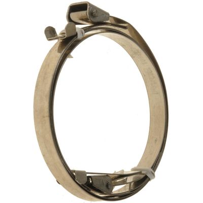

THANX GUYS FOR ALL YOUR HELP I JUST ORDERED SOME CLAMPS FROM KARTECH HOPFULLY THEY WORK....
HERE IS A LINK TO WHAT I GOT LET ME KNOW WHAT YOU THINK?
THERE THE ONES ON THE TOP
Kartek Off Road - CV Boot Clamps
Those look nice ,but I don't they would work on the front of a RZR because you have the A-ARM bracket in the way , but I don't think your using them on a RZR anyway . I like Kartech they got cool chit .

well if the kartech clamps dont work i will be trying these great idea's i just want some thing that i can work with in the field in a pinch.
The Kartech ones should be just fine. It is similar to a hose clamp and much easier to tighten then the normal clamps. Just make sure you have the clearance.
