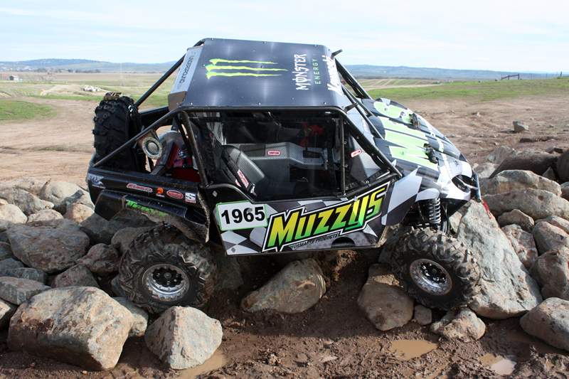

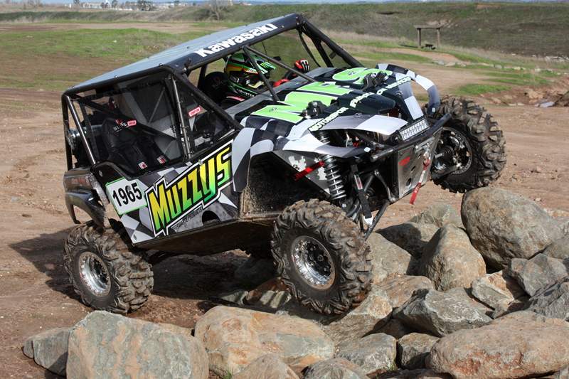

a couple years ago i had my rhino wrapped, see below. it didnt stick all that great, but i am sure the material and prep has come a long way since then.
Is it the lighting....or was your logo pink???
Can you give us a ballpark price?
Thx
MP

oooohhh its like that ehh? red, looks like the sun washed out the red in the picture.
Hey...Hey...calm down now....it was a question...I knew you chicka used to roll that rig out.....I thought maybe you did some pink :D:D:D:Dya ya...thats all I was gettin at:D:D:D:D
