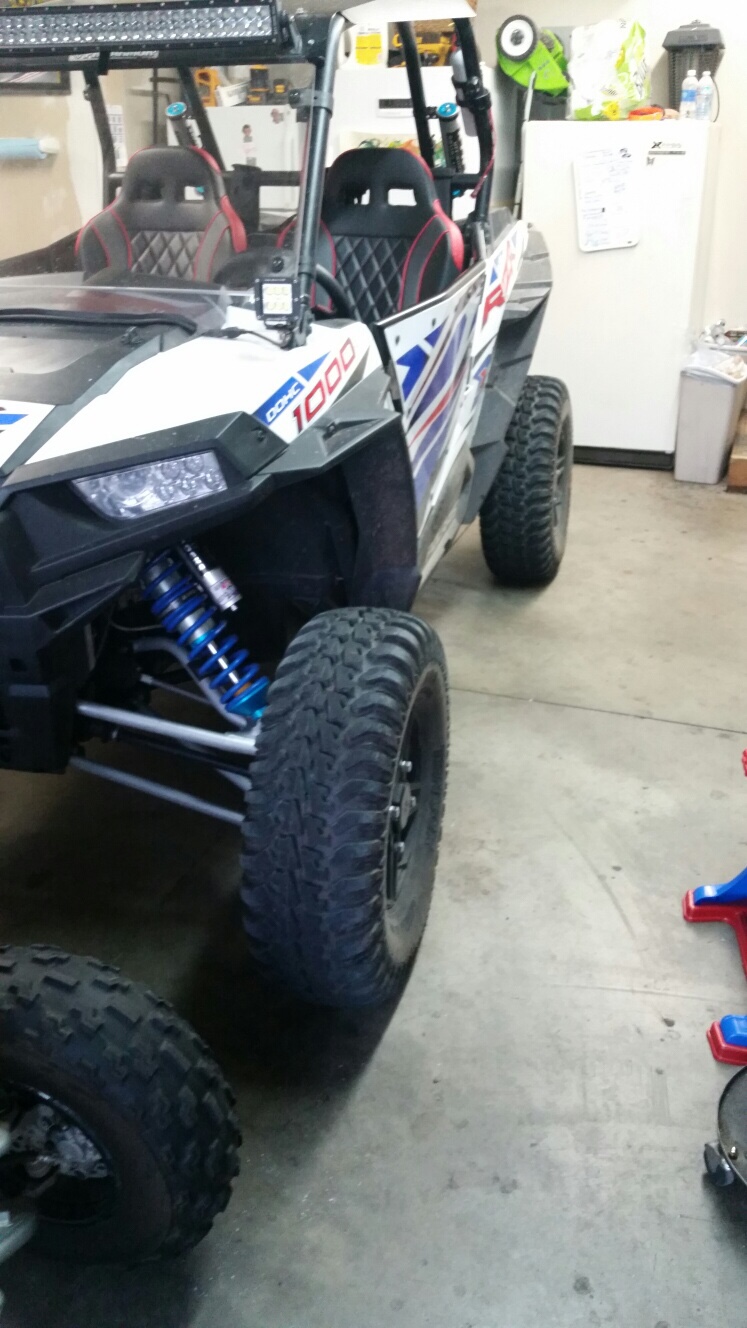

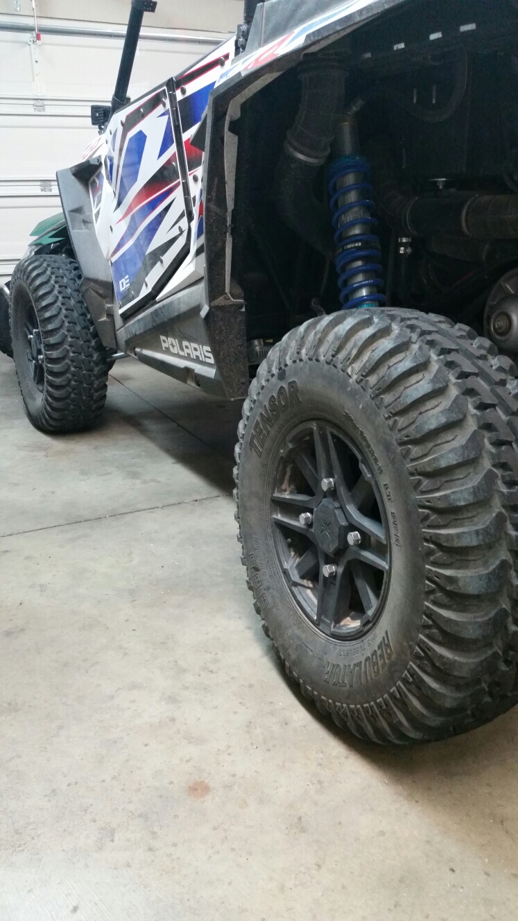

Does anyone have experience or opinions on mounting 32" tires on stock XP 1000 wheels? Obviously people have run 32" tires on aftermarket 7" wide wheels, but curious if anyone has run them on the stock widths (6" front, 8" rear)?
Not mine, but here's the Tensors mounted on stock wheels.

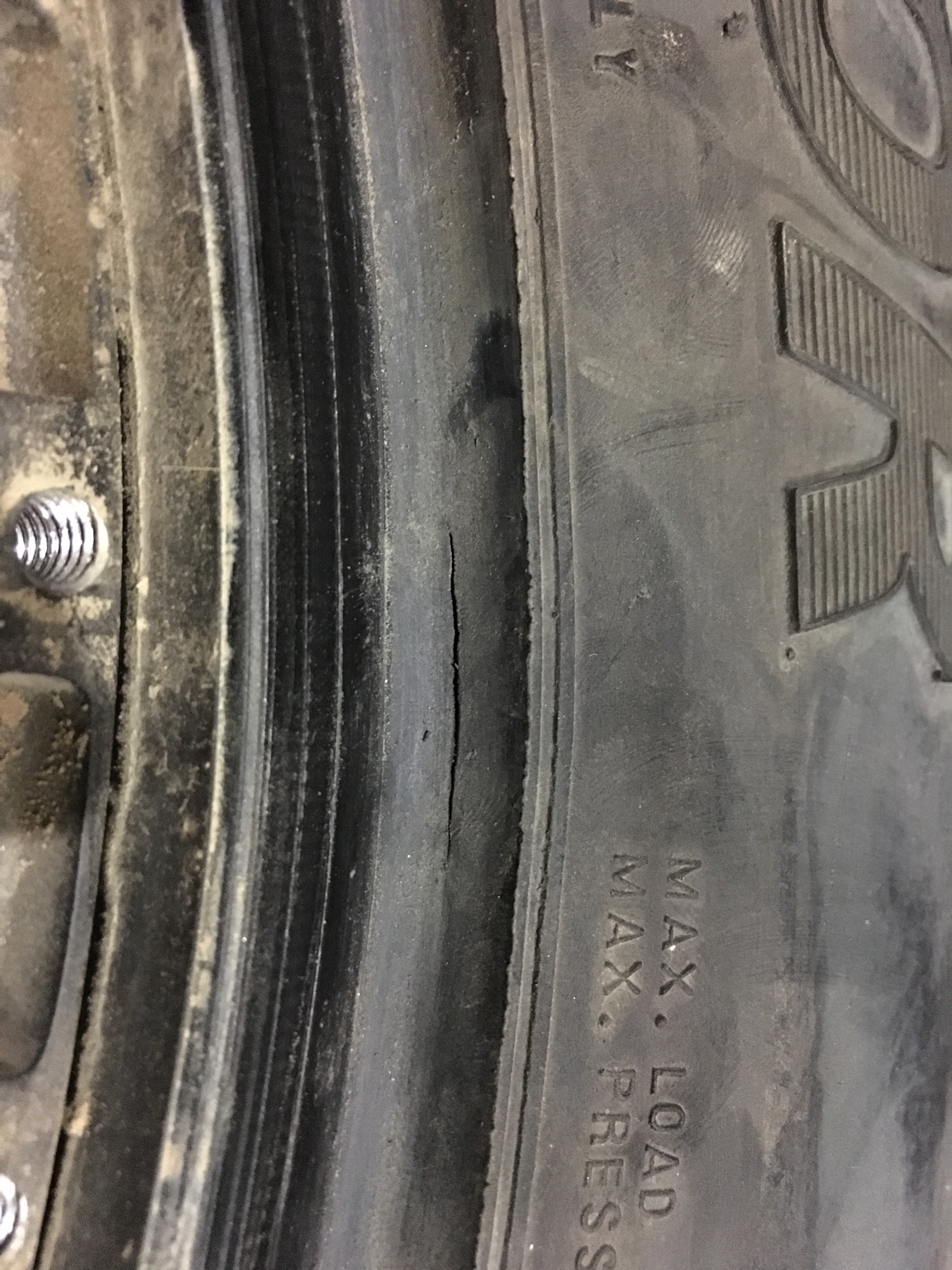

I rode with a guy with the tensor tires this weekend. He had them on his 4 seater. He had a flat pretty quick into the ride. He did not seem overly impressed with them.
Strange place for a cut! The picture is pretty zoomed in, so its hard to tell, but it looks like that is a beadlock wheel and, I would think that cut is very close to the rim lip or beadlock ring? I'm I correct? How old are the tires?
