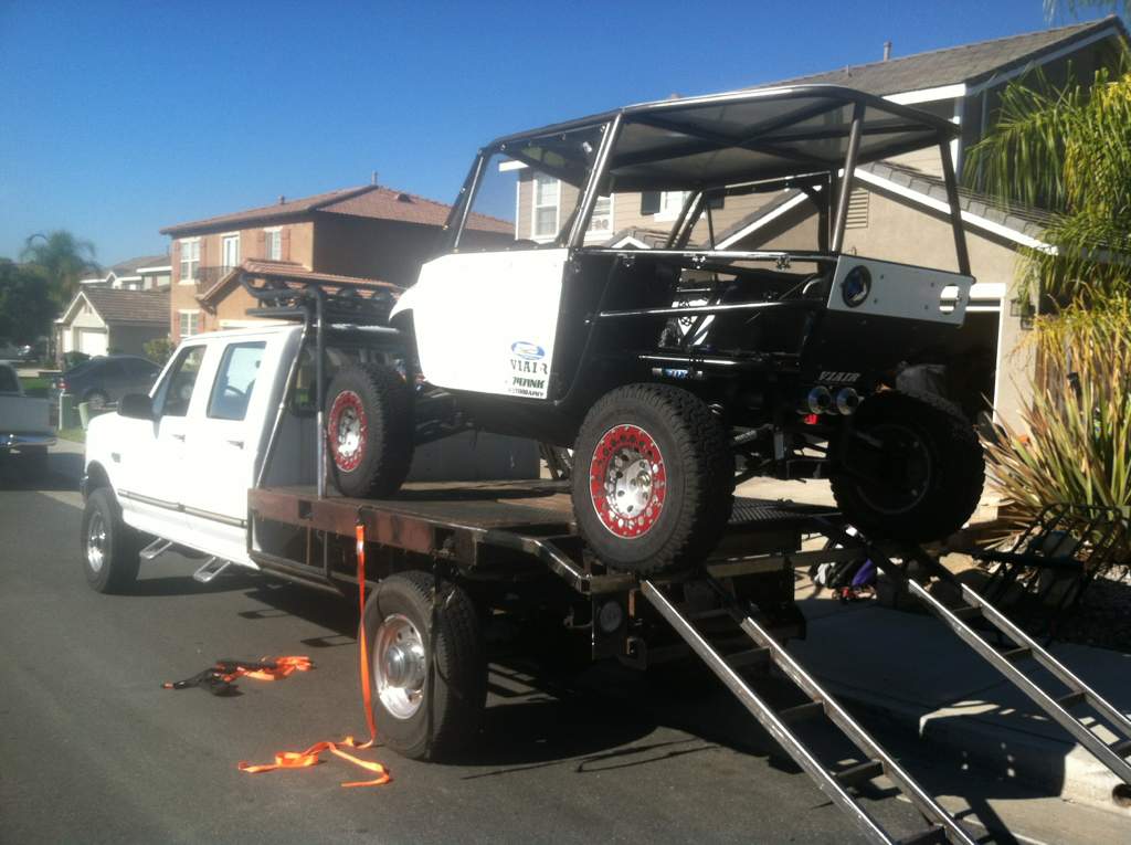

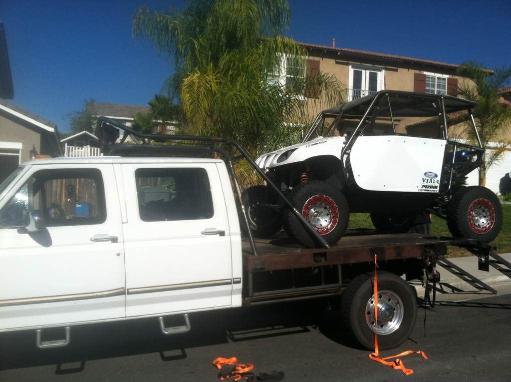

Well the Rhino did not fit. The track width is too wide for the rear support bars of the chase rack. I will be modifying these bars ASAP.

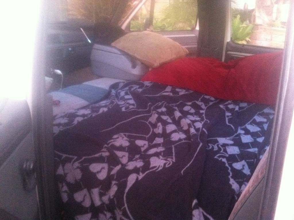

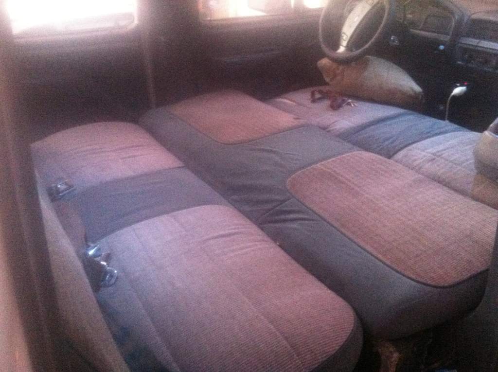

This past weekend I ended up at the frozen tundra race in Jean NV. The sleeping arrangements were less than ideal. I slept in the race trailer with a door open because it broke. At 19 degrees you can't get warm with a door open.
So when I got home I started working on the chase truck to find a way to build it into a sleeper. Basically I moved the front bench seat all the way forward and I modified the seat back to fold back and lay flat by the back seat. Now I I have a nice warm space to sleep at any race.
Looks comfy :cool:
nice work Rusty...been many a cold morning I have woken up in the desert where that setup would have felt like the Hilton
