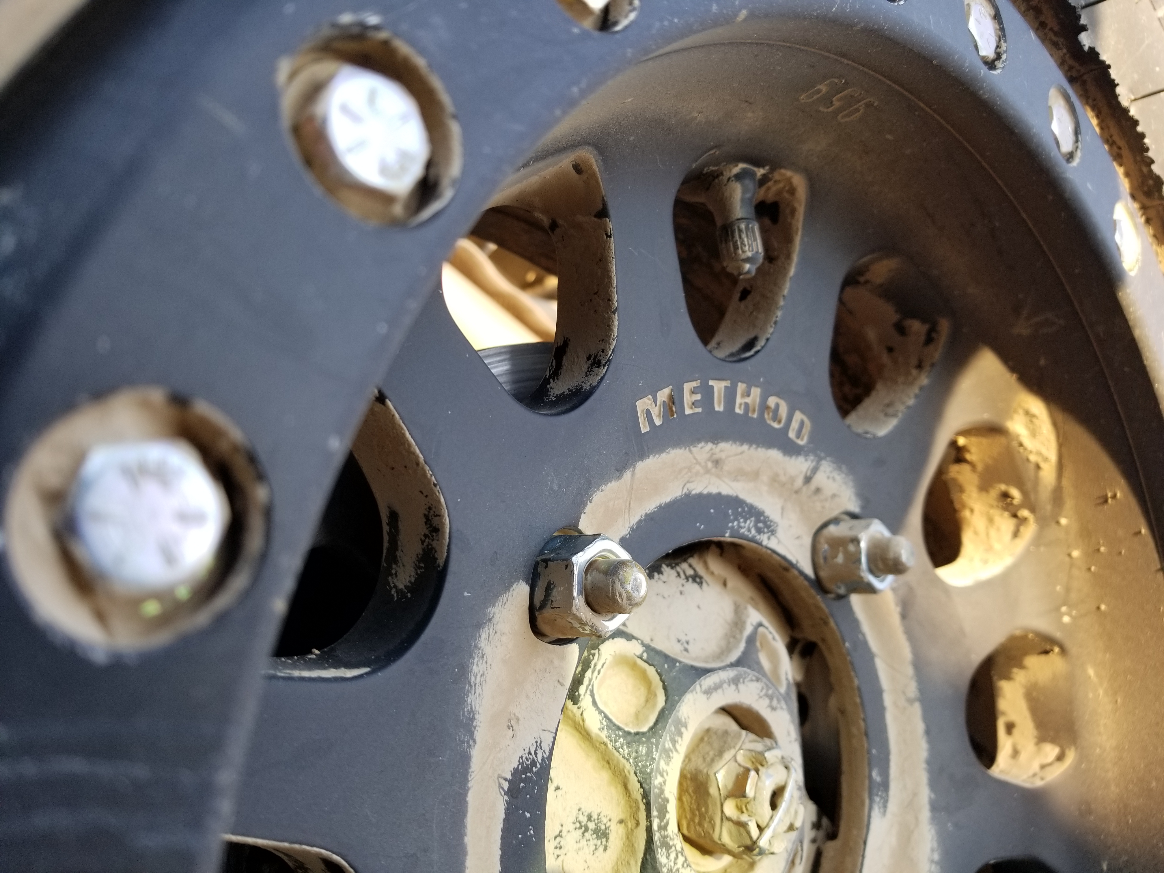

I have 2016 NA xp4 1k car all stock. I really like the 15” Method 401 but they only come in 4/3 offset and from what you guys are saying it’s a bad combo and to heavy of a wheel.

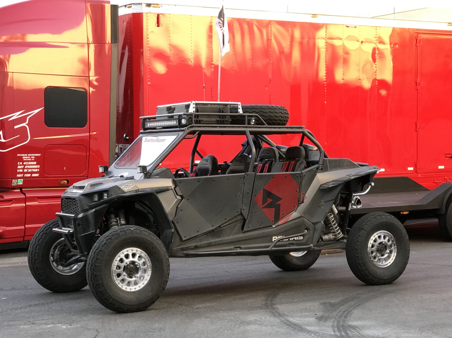

I think way to many people are getting hung up on this offset thing. IMO, very few people can drive the difference in the offset and there are so many factors going into how a car handles. For the every day driver/rider it makes no difference whatsoever. Go with what you want and what you think looks good. For what its worth I use the 15x7 4+3 on my race car with no issues. -Kyle ~ XLR

32's are just fine with proper clutching. I've run 32's for the last couple of years on all my machines both turbo and NA XP 1000's.

I have been running the new 32" BFG that just won the Baja 1000 and the final BITD race on our XP1000 SE Rock and Trail edition with excellent results. I did 500 miles of Baja and some pre running at the King of the Hammers and you would have to pay me to give these tires up.
They do rub slightly on the front fenders but not enough to bother me. We stick with as close to stock offset as possible to keep the steering geometry in its happy place.

I went with the 401 15” 4+3 with a 30” tensor.
