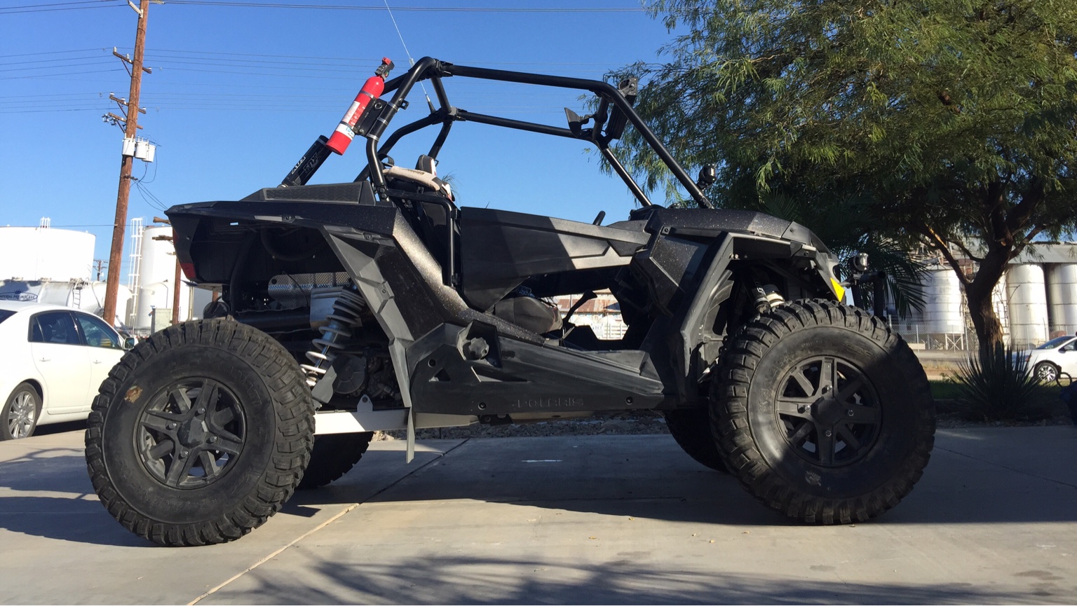

I ran them at 17 psi this afternoon at Superstition. Did desert, washes, rock climbing, and sand dunes. I mostly followed my friend, who has a stock xp1k with stock Bighorns, at 14 psi. They did everything that his car did. I was especially surprised that they compared to the Bighorns during some low range crawling that was 75% sand and 25% rocks. They felt great in the washes. They felt great everywhere!

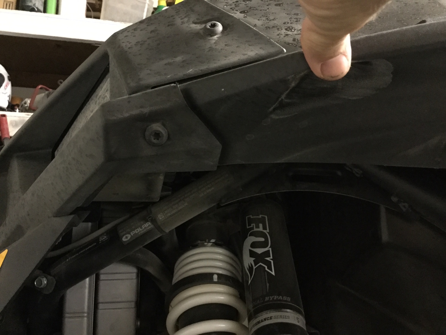

I mounted them on the stock wheels. The fronts did rub 2 or 3 times over a couple hours of riding. Top front of the inner fenders, just behind the lights. No biggie.
