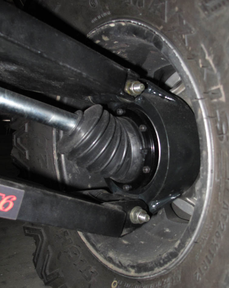

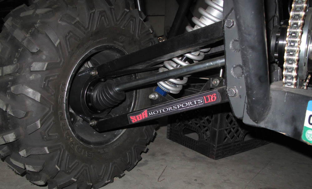

Today, the man in brown delivered the remaining pieces of my SR1 setup, a sick set of Weller centerboard hubs, and axles! Barely took them out of the box, and ran them over to SDR for installation. Should have a runner early next week, and be ready for testing by the weekend.
Still need to do some wiring, some aluminum work, and put a sway bar on.
I'll try and snap some pics next week, and of course some video at the track!
Oh, and by the way, the new Weller centerboard hubs are SICK. Very nice piece of equipment, especially for the price they are selling them for. There are some pics on Wellers site, and I'll shoot some more once they are mounted up.
Yep, SDR is really stepping up this year, and is going to take this car to the next level, so we can be really competitive in the SR1 class. I'm definetaly looking forward to an awesome year of racing thanks to SDRs support, and Weller for coming up with such a great class.
My rear suspension droops a lot more than the standard SDR setup, and these hubs took all the angle and more without binding. I do need to check them to make sure they are within the max recommended angles.
After this race we will be going to a longer rear shock, and maxing out these hubs for sure!
