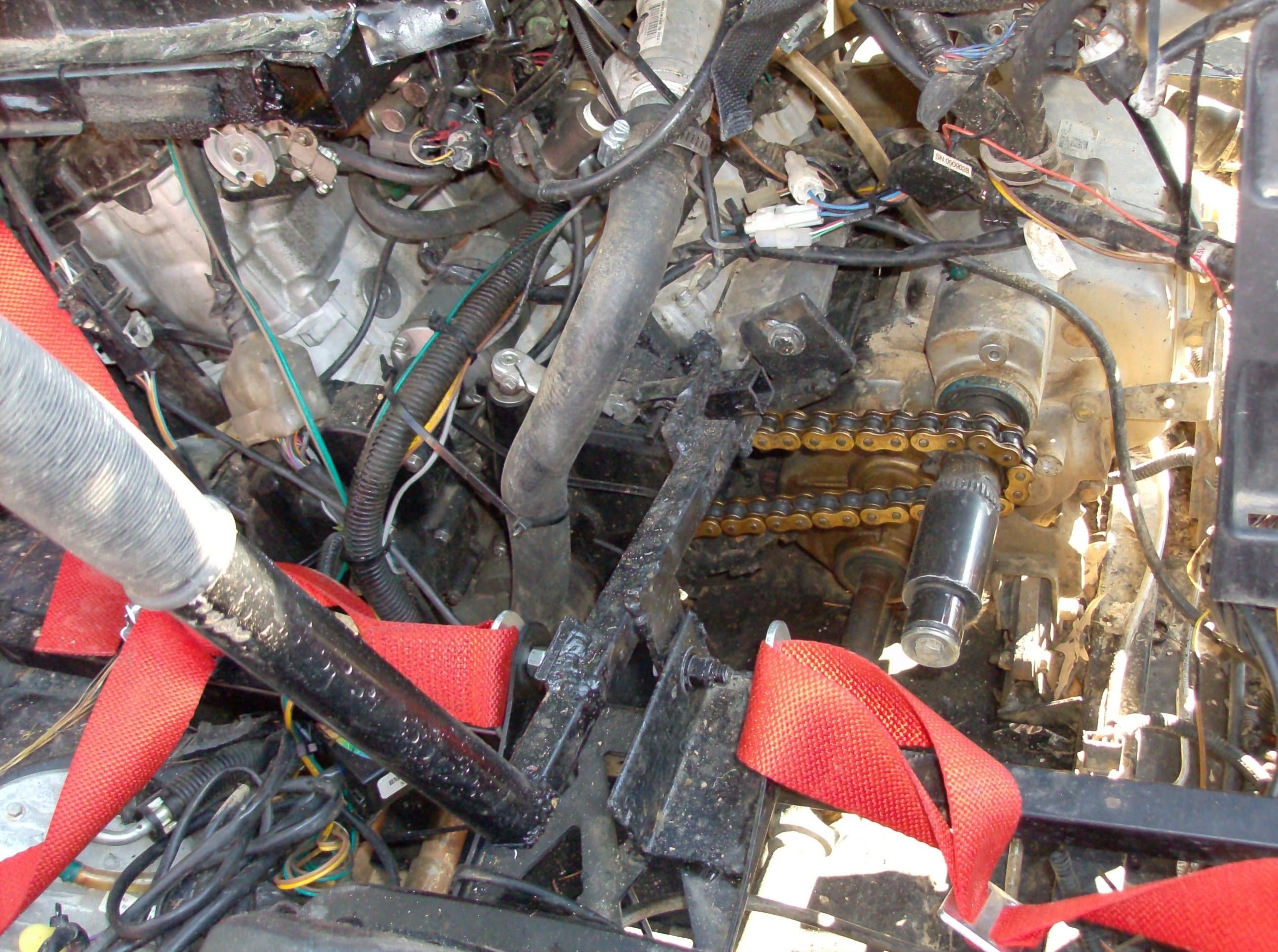

id also like to get the opinion the the setup. here is a picture the seller sent me.
Small sprockets and short chain might lead to high chain temps.Plus is doesnt look like he is taking very good care of that chain.
my gear ratio is 5.5:1 it can creep slow... i mostly ride the dunes with mine and some fields it will do ok in really rocky stuff but where a r1 rhino shines is wide open places... but the power is very smooth and capable of lower speed driving it just all depends on the gear ratio... i dont race mine and wouldnt want as high of gearing as the weller kit i have herd its around 3.5:1 thats great for racing but just all around driving i think lower is better for me...
I have A hayabusa powered arctic cat prowler and I love it and the only maint issue I have had is to replace both sprokets a the chain every season, But I would rather deal with that than all the cvt issues...... good luck
