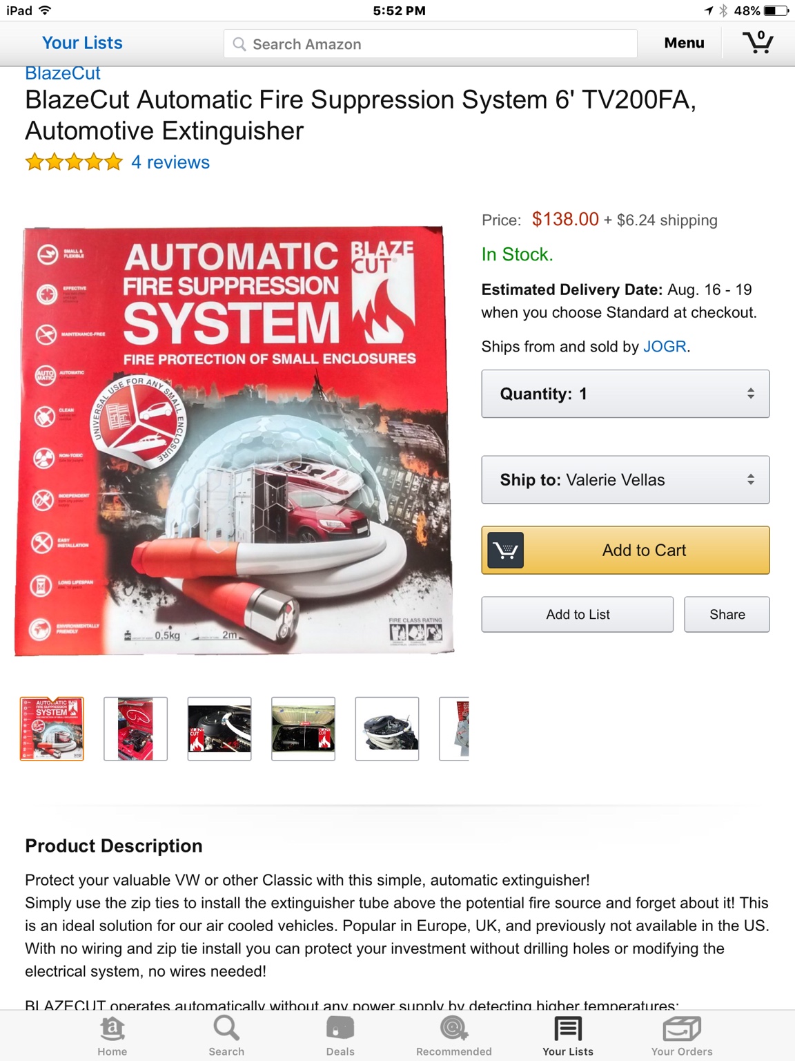

I found this on Amazon. You simply zip tie it over the engine, and if a fire breaks out it ruptures from the flame and sprays fire retardant on the Fire. BlazeCut Automatic Fire Suppression System 6' TV200FA, Automotive Extinguisher https://www.amazon.com/dp/B00D7M3E7O/ref=cm_sw_r_cp_tai_hX8QxbXY7JQKZ
