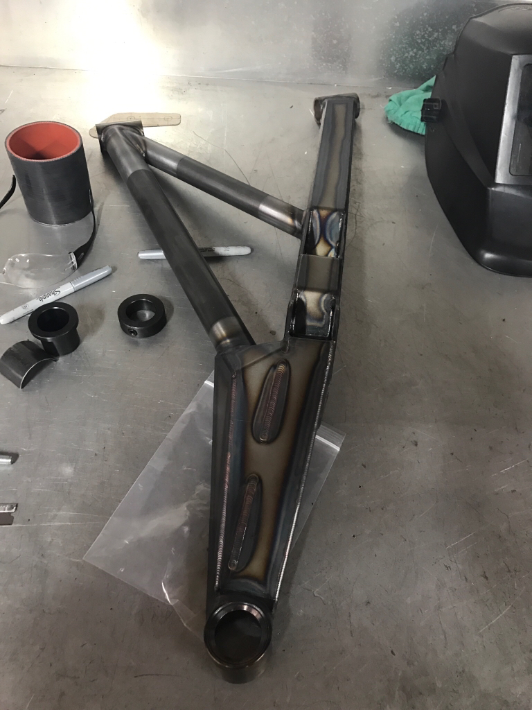

Will the steering rack be in front?
Hey kornfed, I was wondering if you were going to run stock-sized cv joints and hubs, as it appears that is what is currently fitted at the end of the rear trailing arms. I assume you are running a center steer rack mounted in front of the front axles. Is there a target GVW weight you guys are hoping to make? Like the other member commented , I too have been a long time fan of what the Pehnalls race. Their cars are always clean and capable. I have reservations though about the application of stock differential housings, and their ability to perform in an "unlimited" environment. Also, it is kind of hard to knock the performance of a CVT system that is dialed in. I'm not sure manual shifting can climb gears as fast as the cvt's do. Looks like a few teething pains lie ahead, but when aren't there? Hope you run it at the world championships. I'm glad to see someone going all in with a custom build (or, all out as one might say). The class deserves more than what most bolt on accessories offer.
You are spot on about the steering and good eye on the CVs, but those are just mock ups. We have a custom set up that is pretty slick. Car should be under 2000, but there is a lot of steel here. The diff housing has some up members that actually support it. Also an alternator on the driveshaft like the Rustfish.
Like anything this will have some issues to work out, but when it works, it should fly. Also we are waiting on doing he motor work until after we get the car sorted. We will then bump it up. Step by step...

I think under 2000#'s (race ready) is extremely optimistic with 8 shocks. I only point out race ready becuase i see lots of folks talking about weight and 9 out of 10 times its dry, no spare, no tools, no ???
No it will be much heavier at the line. The Rustfish is around 2000 dry and race ready is close to 2500. 32 gallons of fuel, tools, spares and the like. 2000 is the dry weight goal. With me and my co-driver we are close to 3k. You don't get the nickname Kornfed for nothin'. ;-)
LOL!! I know all about it brother...I have a shirt at home that reads I eat cornbread!

Optimistic to say the least! I'll go out on a limb here (or rather a sturdy metal pole) and add that anyone claiming a wet weight of under 2,000 lbs. at the dropping of the green flag is either lying to you, or not prepared to win that race. With that being said, I don't feel that a well built unlimited UTE that comes in just under 3k wet (including occupants) couldn't be competitive. It looks like kornfed may be one of the first entries in the unlimited class (Speedcats excluded) that truly lives up to the classification. I'm on your side Jim about the extra shock. I think its value is questionable given the weight penalty attached to it. Thanks for sharing details kornfed. It all comes out in the end anyway. Secret-smeakrit!

Never said wet weight under 2000. Just pointing that out. I know weights and we got a lot of it. Dry weight goal is 2000. At the line will be close to 3000. Since Kent and Craig will be doing the driving, it will be less than Jason and I, but still close.
