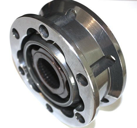

I wonder if there is enough material on the Polaris cup to machine some cooling fins on it, this is common on the 930 cv the 1600 guys use.

For those who dont know what BroncoBoy is talking about. Here are two 930 CV that have been machined to not only lighten rotating mass, but to cool the joint & axle.
930 CV joint with machined fins
Machined out 930 CV joint
