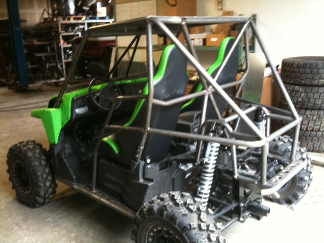

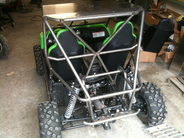

Just picked up my Teryx today from Roggy Enterprises. Custom roll cage, bumper and rocker skids are done and ready for powder coat. Goal on the cage was to narrow and shorten the "bed", add good cross bracing, tie in the rear shock tower and make it all bolt-in.

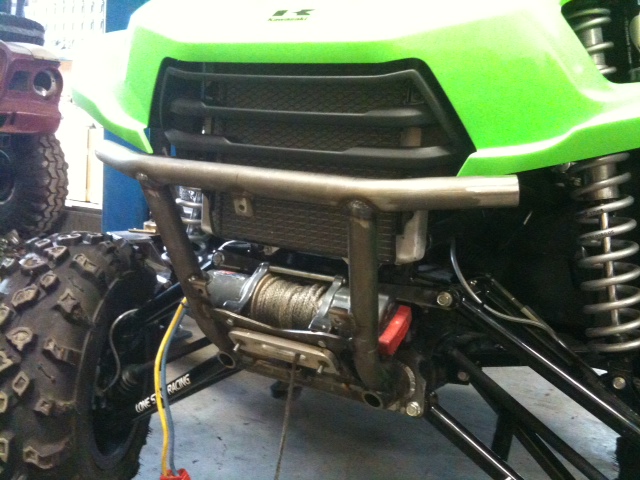

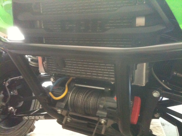

I wanted a small tight bumper with the diving board cut off and a mount for a Warn RT40 winch. Frame up front was also sleeved and bumper is bolt-on.

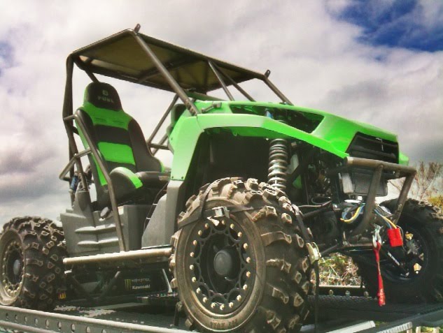

Factory UTV added their 1/2" UHMW skid plates and also did up some custom rock sliders. Came out awesome. Going to pick it up today. Then lots of work to get it ready for Moab next week. Just need to find a truck to get me there. :D
