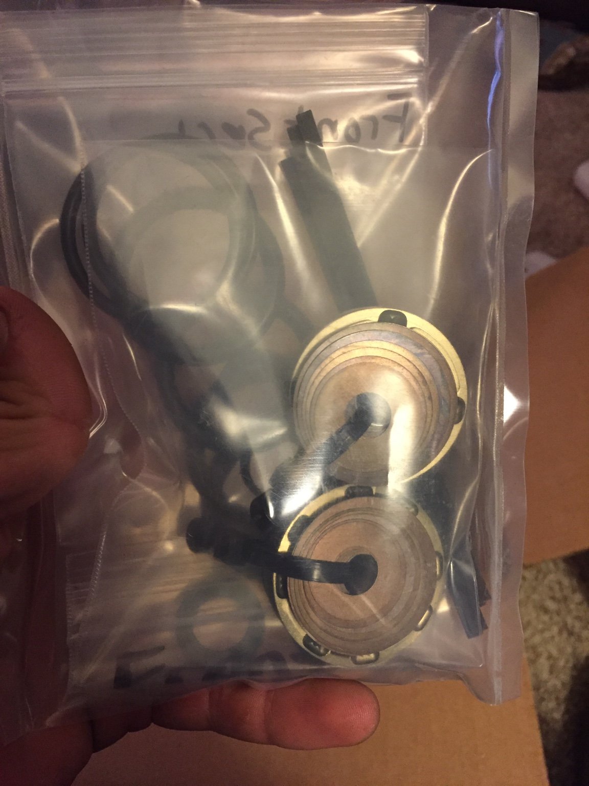

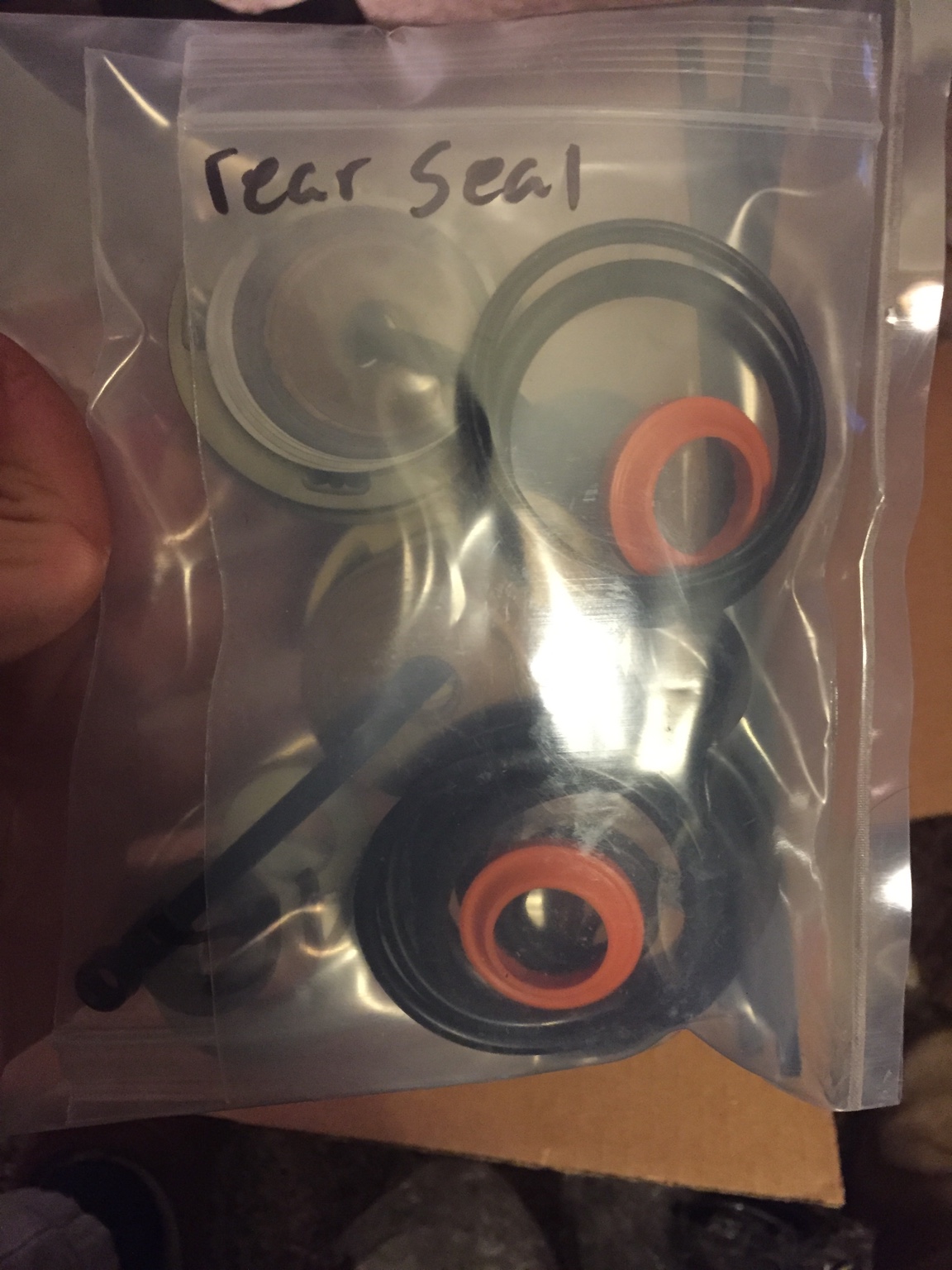

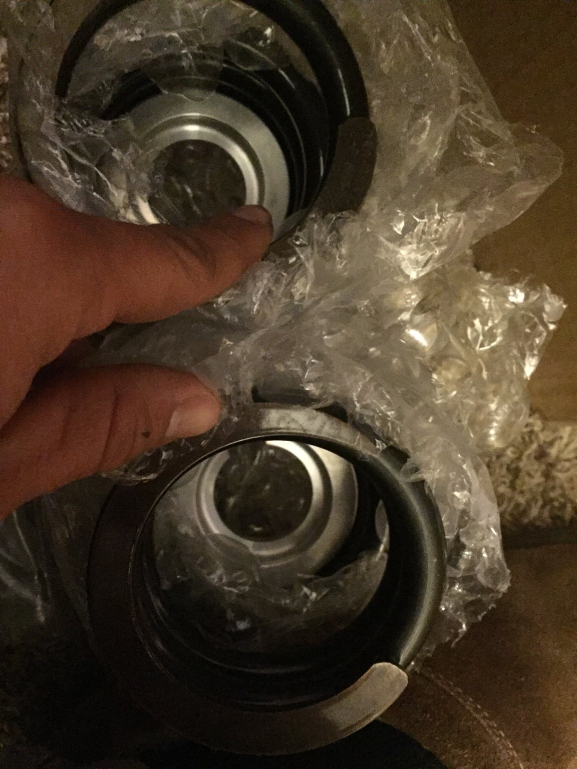

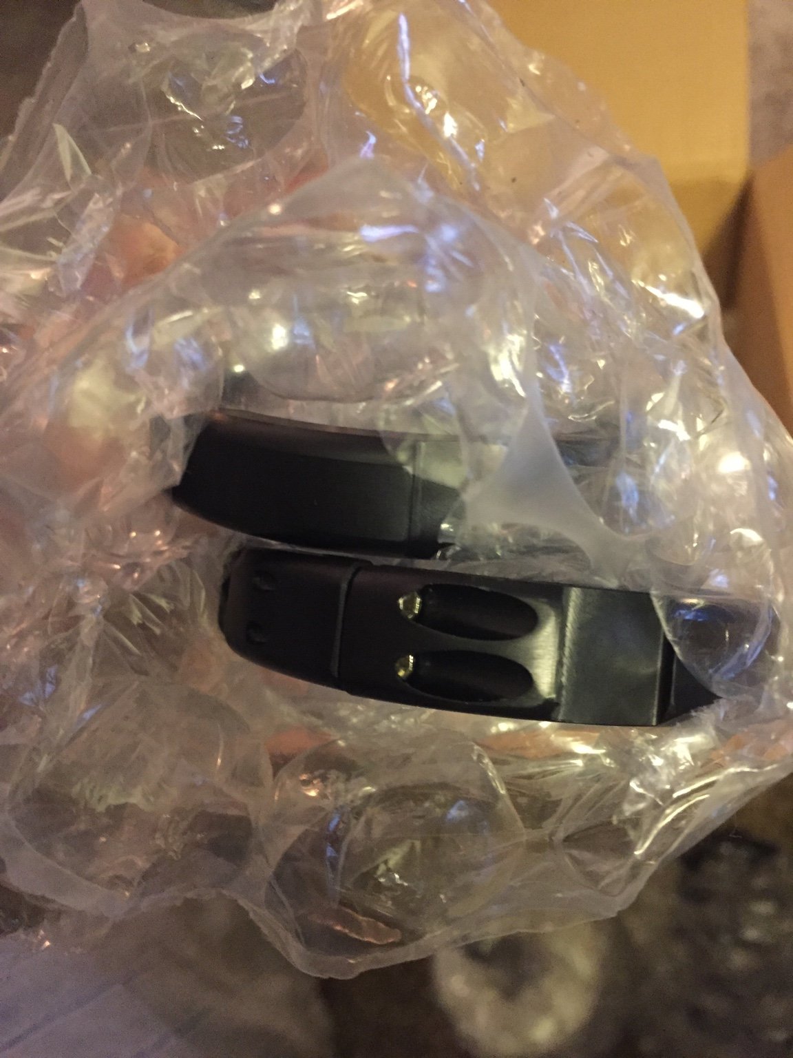

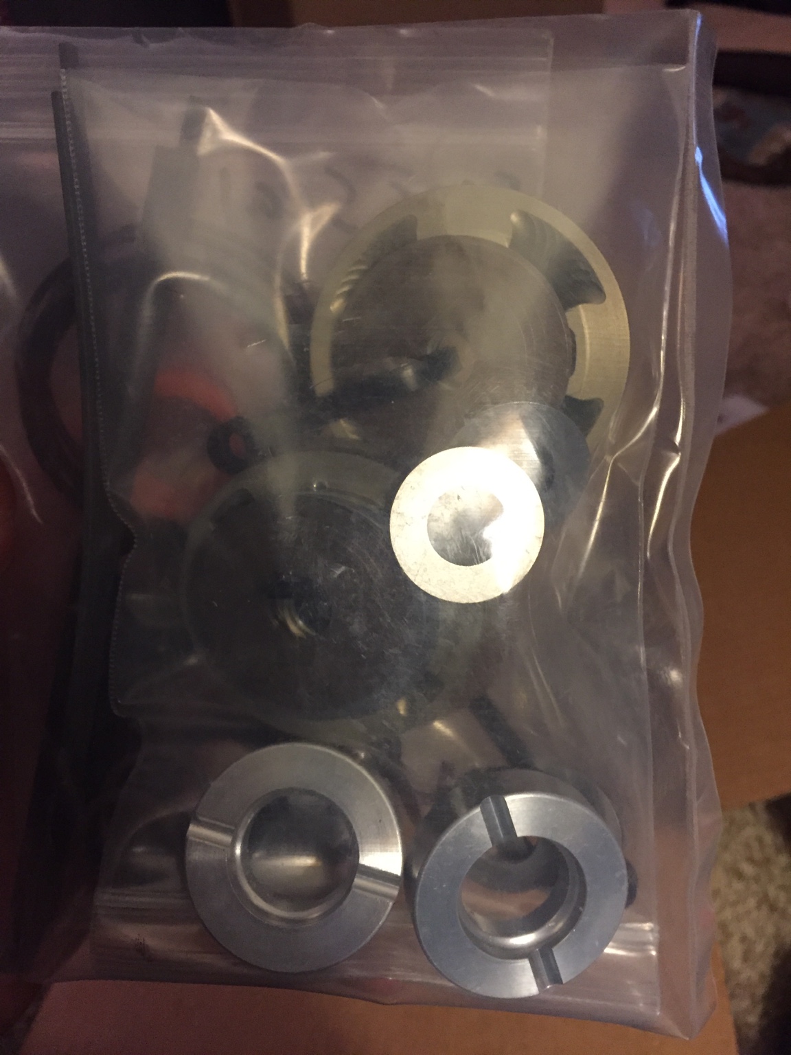

Showed up from FedEx on Wednesday! Everything looks pretty nice! Just have to get some time to pull the shocks off and do everything. Have a huge pile of parts for my rzr snd no time to work on any of it

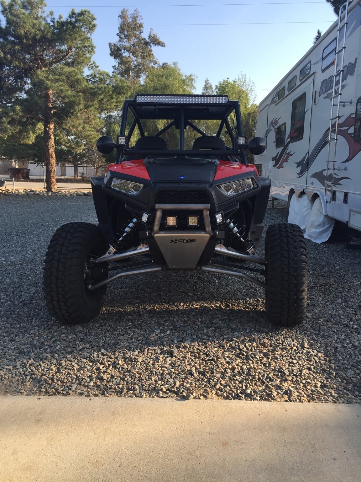

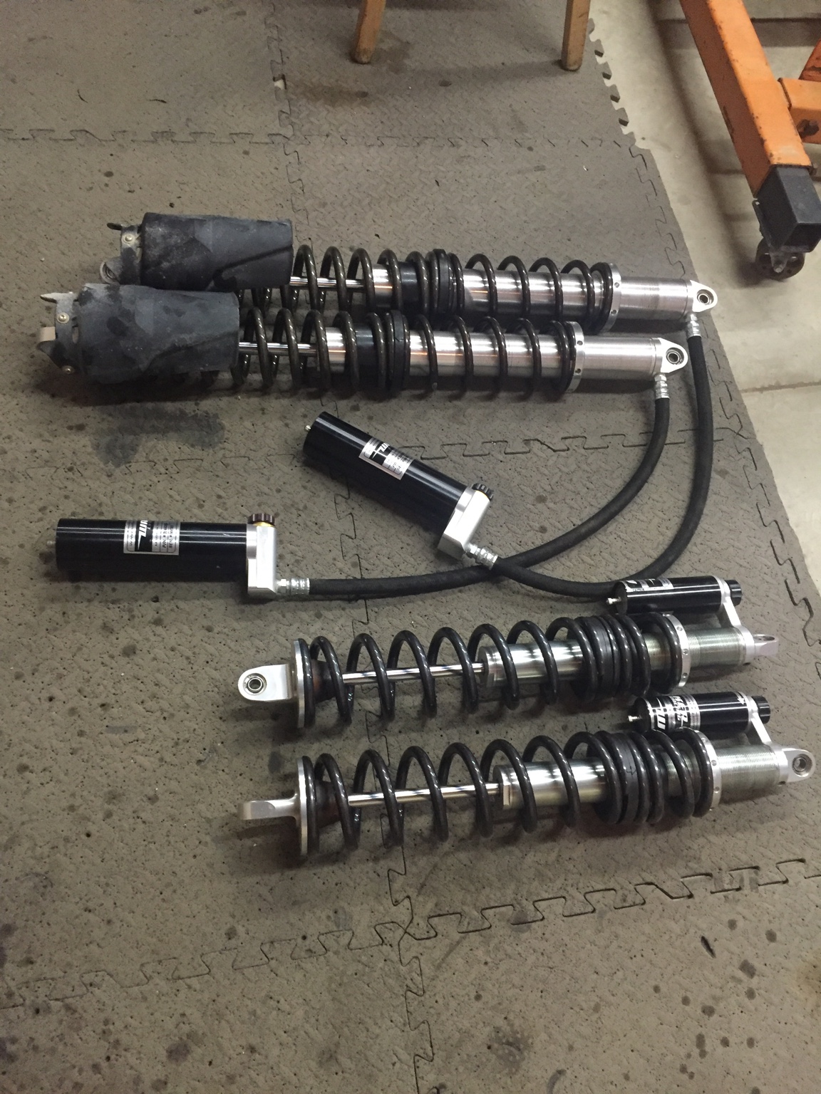

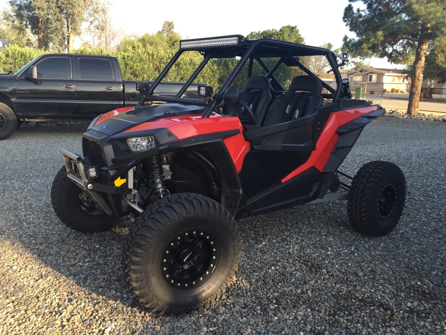

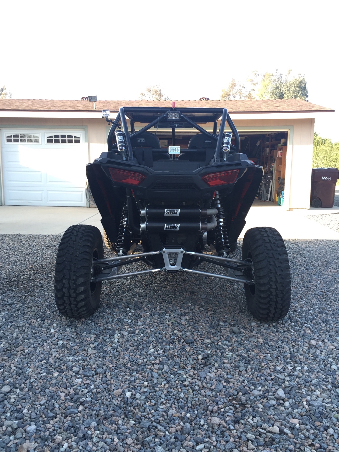

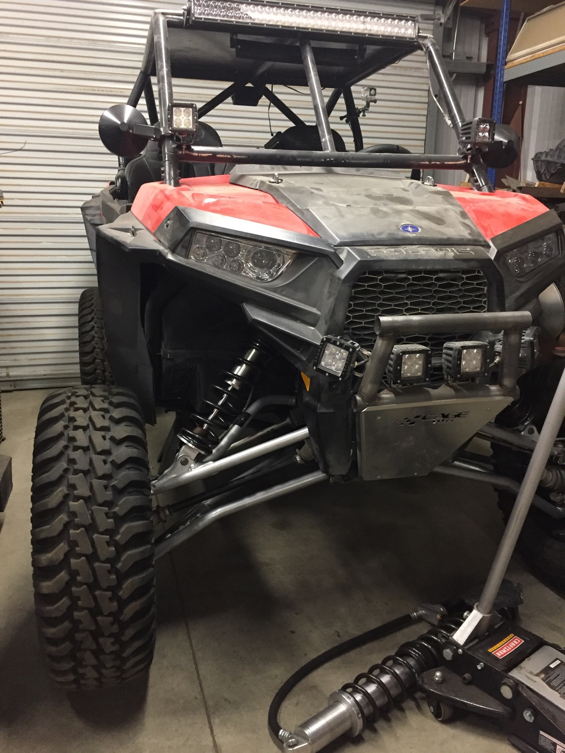

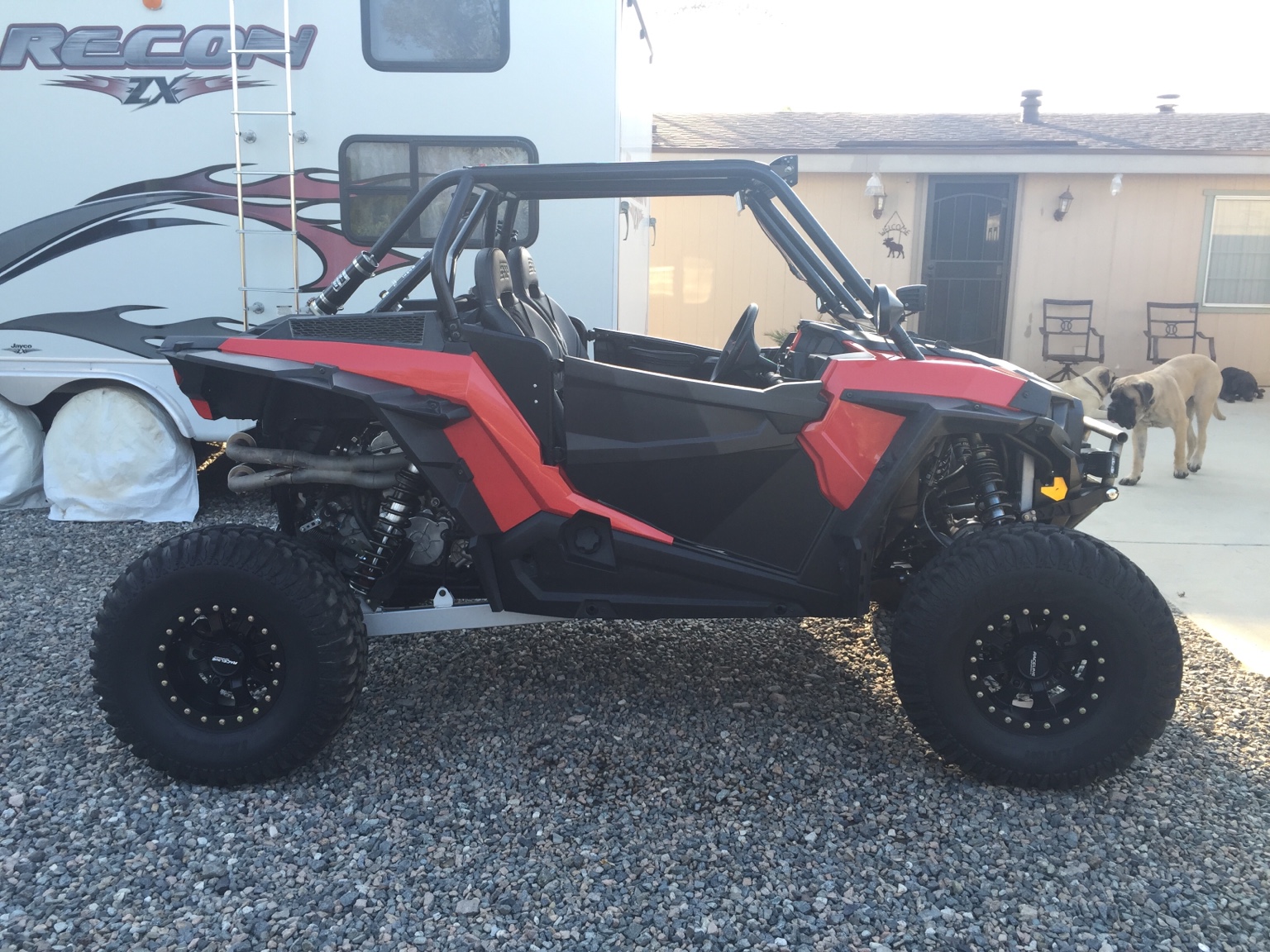

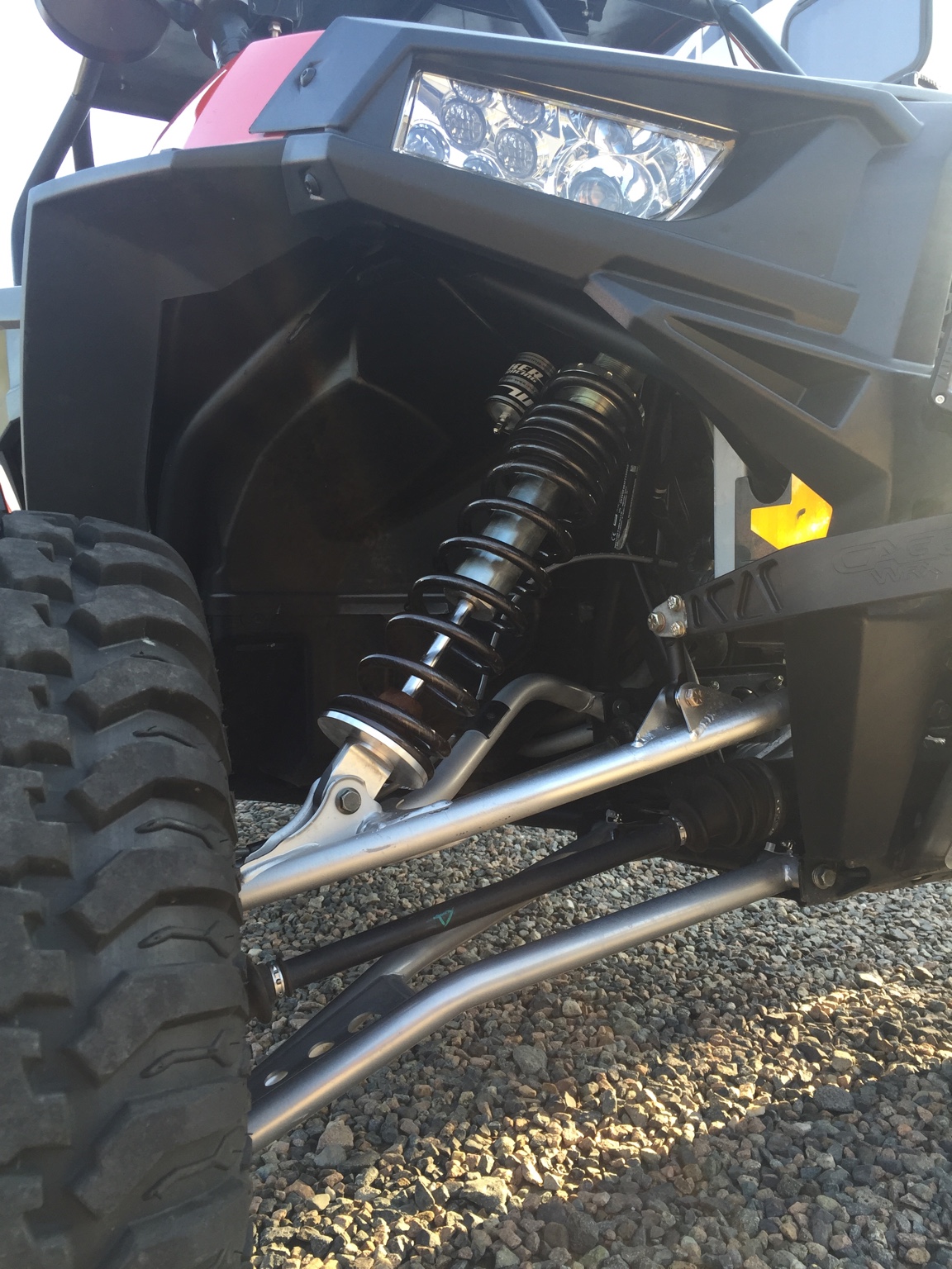

Finally got everything put together. Haven't had much free time this year so far. Overall the install wasn't too bad. The instructions that come with them are kinda vague, especially if you have never built a shock in your life. Luckily George from double E was able to answer all my questions and help me out. The ride height is a lot higher than stock, even with the preload nut only touching the top spring and not cranked down. Going out this weekend to test it out and see how it does! Here's a couple pics
How does it ride?
Did you drive it to let the ride height settle after letting the jack down? If you did, they run a pretty heavy rate.
It rides pretty damn good! Way better than stock for sure. There's a ton more compression in the shock. Doesn't bottom out on anything anymore. The ride height settled some but there is still no preload in the springs and it's still higher than stock. I actually really like how it sits now. The front sagged a ton before and would drag over everything. I still plan on playing with the set up and get it dialed in better. Right now the rear compression adjuster are all the way on soft, and the front is 2 clicks off from all the way soft. Overall I would recommend the kit
How much clearance do you have now in the front between the arms and the back in between the radius rods?
