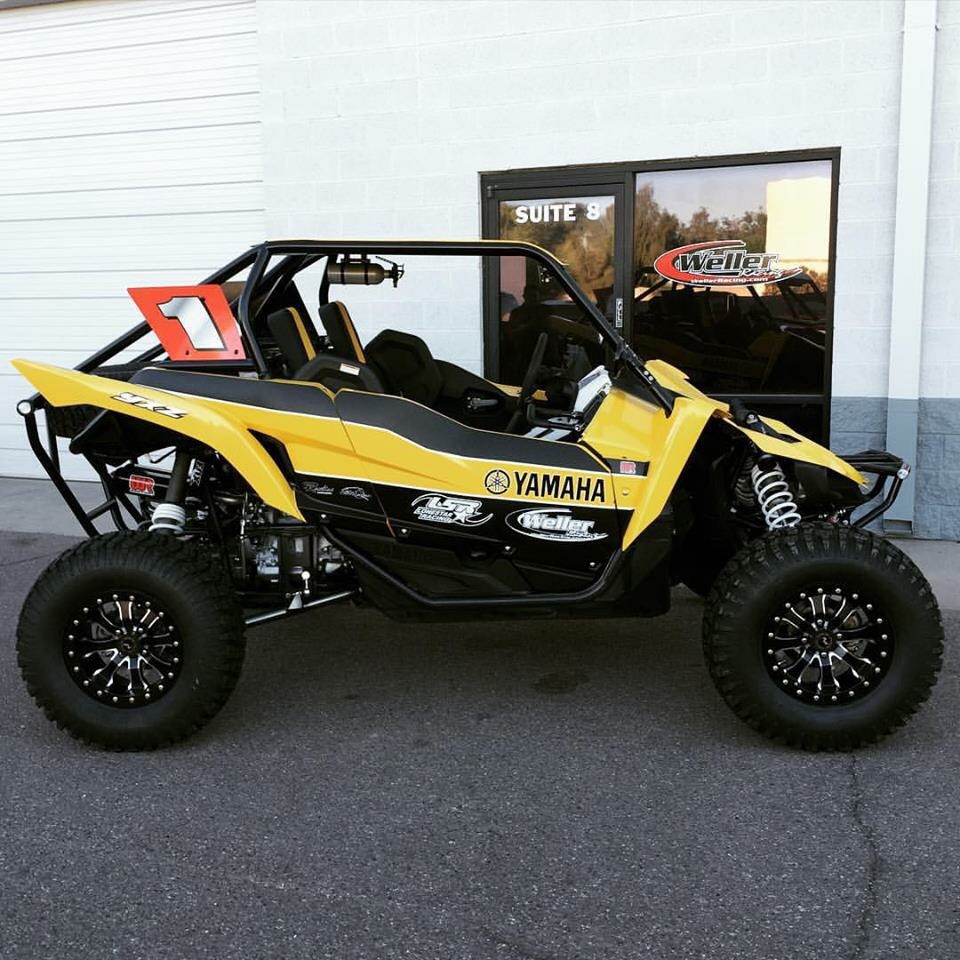

Sorry for my absence. I have been busy moving, and my desktop is not hooked up. I hate this mini keyboard tap talk shit. I'm too old for it. Good news is I was contacted by a member, and he gets his yammy on monday.i really need to get a mental head start. Kind if wrap my sloshy brain around the car. Just seeing the chassis in person will afford me a few key decisions. Will the mods for a front steer conversion be overly extensive? What real estate is available for upper shock mounts? What does the factory cb joint alignment look like, and does it favor extending the wheelbase? That's what sucked about the polaris is that you couldn't extend the wheelbase without sacrificing drive train reliability (well that amongst other things). I'll try to chime in Monday after seeing the new baby ute. This is an exciting time for me and our sport. I'm anxious to exercise my brain because it surely ain't happening at my 6-2:30 union job.
Hey Reid,
How about a visit with some cold Stouts to enjoy. Shoot me a message and I'll bring the cold ones. Can't wait to see the new project get the BADASS treatment applied to it
Mike
