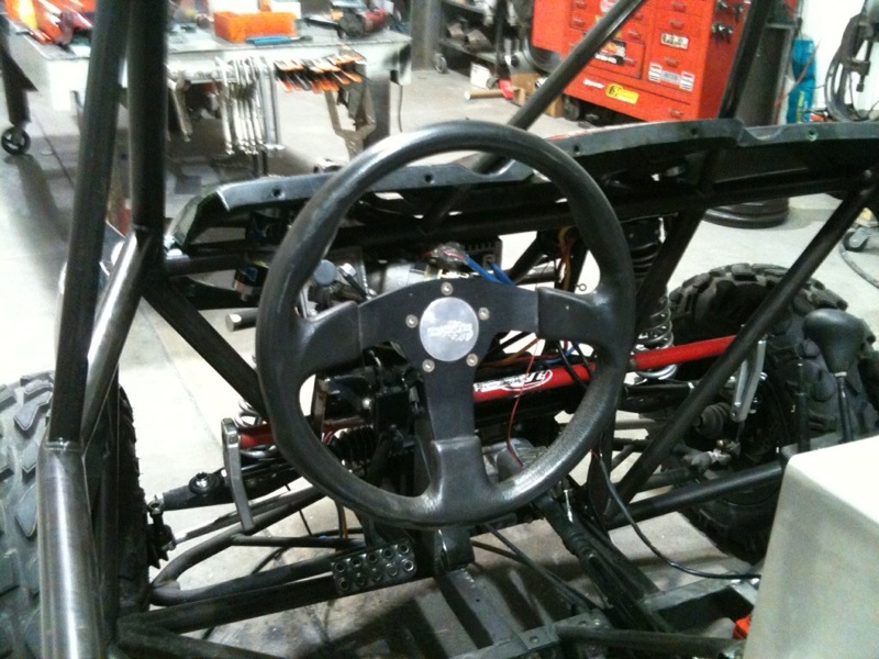

Can you get a pic of how you mounted the sway bar? I am dealing with body roll myself and I kinda want one of those sway bars. Just not sure it will work on my ride.

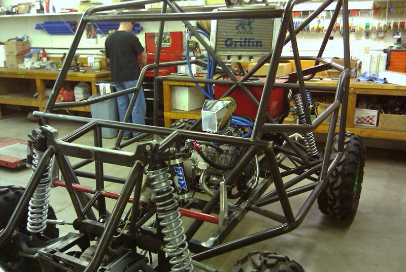

The rear sway bar mounts to the factory location, and in the front, we welded the bar right into the frame. It is the red tube in this picture. I just pull the bar and arms off when not in use. :D
For most normal applications, the rear is all you need. I just knew that I was going to sit a bit higher than normal and wanted to help control body roll more.
