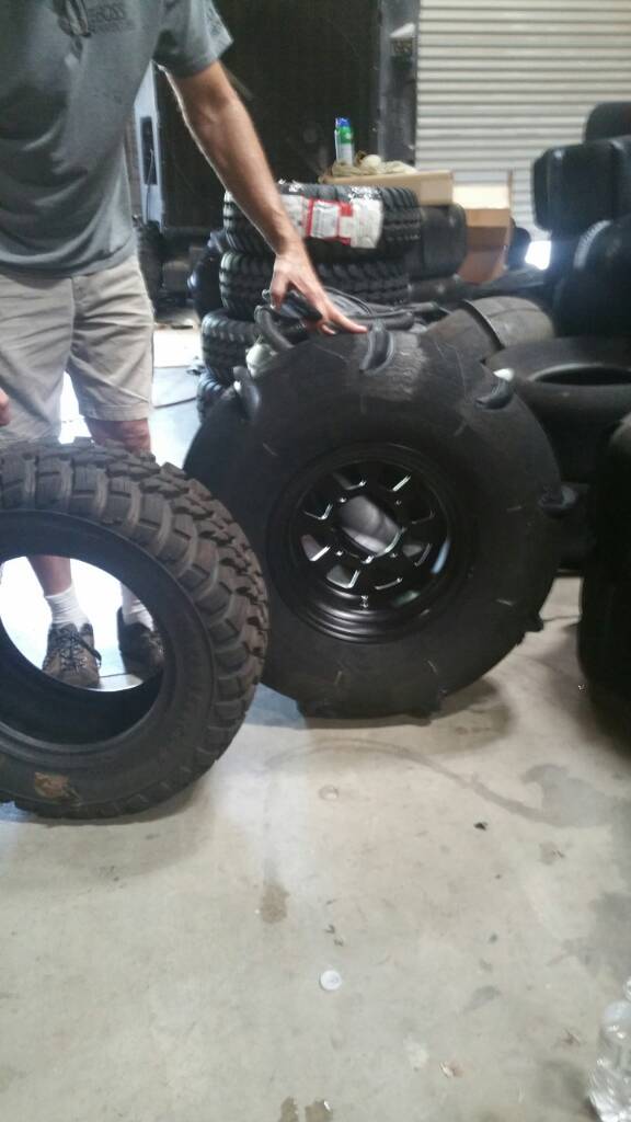

SKAT-TRAK WARLOCK BY EXTREME TIRE 30X11X14

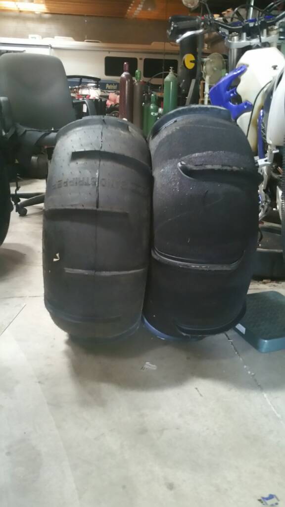

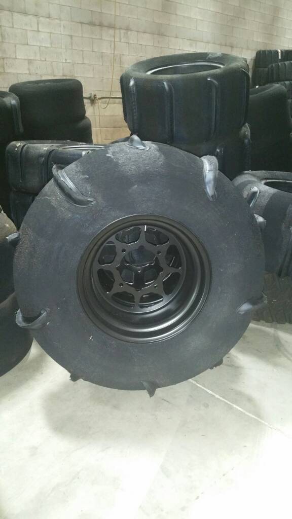

I went by Xtreme tire today and Tim had some new Xtreme Skat-Trak 30x13x14 mounted up next to a Tensor tire 30 and a sand stripper 28x15x14.
Sent from my SM-N915T using Tapatalk
I am tonight when I have time to stop by Tims

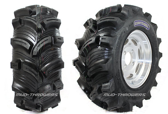

Now my Kenda Executioners (Considered Medium Class Mud Tires) are sized & weighed at: Not counting Wheels
27x10-12 @ 31 Lbs. ea. X2
27X12-12 @36 Lbs. ea. X2
Total weight 134Lbs. Total @ 72 Lbs just rear.

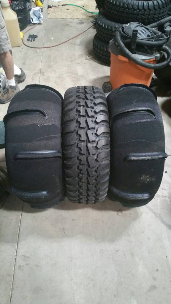

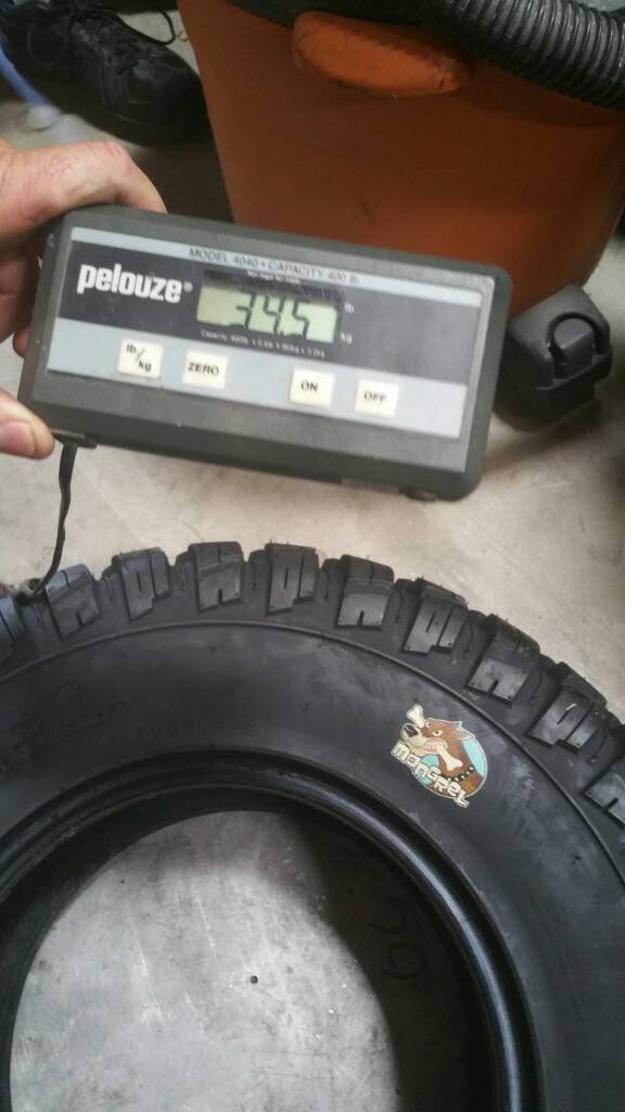

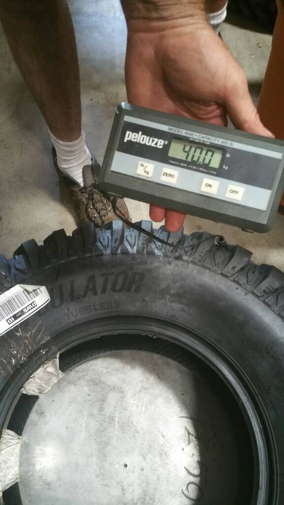

That looks like a big tire. Put it up next to the 28" Blaster so we can see the size difference.

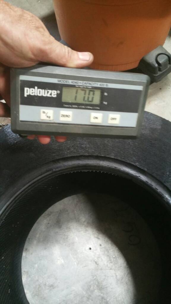

Hey Sandy Blaster STU. Skat-Trak on a 10" wide rim at 15 psi , STU on a 10" Rim at 15 psi also.
Skat-Trak 30 x 13 x 14 (94" Rollout) weighs in at 27 lbs on rim.
STU 28" (88" Rollout) Blaster on Method Beadlock weighs 43. lbs.
Also weighed the Skats 30 on the GMZ Venomous 10" wide wheels weighed 30.75 lbs
That is a big light ass tire! Now throw them on the method rims and weigh them.
The 94" rollout should do well in the sand. Can't wait to check them out at the sand show.
Now back to your rotating mass - shouldn't we all be looking at the lightest rim possible? Seems the popular beadlock rims weigh a lot.
So to be fair - mount those blaster on the rim you use on the skats and lets see the weight difference. I am sure the skats are still much lighter, but I am guessing it won't be a 16lb difference..
Thats a great idea sandy but for anything other than straight forward running on the STU they have to pretty much have to run a Beadlock wheel. Many many moons ago Sand tire was sued by a family whose son had a bent rim and stuffed a rag in it to help get the tires bead to seat up and as he was airing it up the rim came apart and killed the poor guy.
So afterwards Sand Tire runs there beads a little bit looser so they seat up at a lower air pressure. Well when the tires seat up at about 7 to 8 psi which is low it then means the same for coming off the beads which sand tire is known for. Skats seat up over 15psi and they are very tough to get back off the beads. That's why STU tires run the bead lock rings cause they come off easily. So yes it would be nice if a guy could run a light weight rim on the STU but most guys run them under inflated like 8 psi range. Running a paddle tire of any make under 15psi is not good because these cars are in the 2000 lbs range and with the G-Forces involved bottoms the rim. Out as it crushes down with low air pressure. People air paddles down thinking it runs better because the tire slips more. Airing a paddle tire up makes the paddles more ridged and bites harder and if you have to many paddles it will feel slower.
