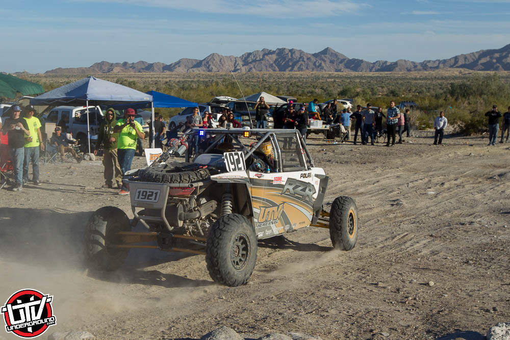

Scott McFarland, in a Polaris RZR would take the win with Polaris Factory Racers Johnny Angal finishing second in his Baja 1000-winning, No. 1921 UTV Inc.RZR XP 4 1000, and Matt Parks in his Jagged X No. 1932 RZR finishing third. RZRs finished the day not only filling the podium but with the top four positions in the class.
