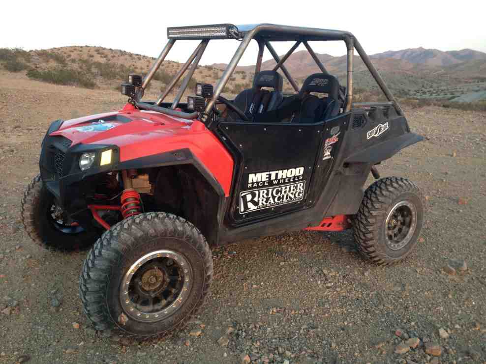

Here's a picture of my XP900 with the new setup next to our customers brand new XP1000 we just finished. Unfortunately the 1000 didn't look that nice at the end of our video shoot. I only put around 10 miles on mine with the new tires but so far it's a night and day difference and believe it or not, quicker off the line than the 1000.
Sent from my iPad using Tapatalk HD
Another angle.
