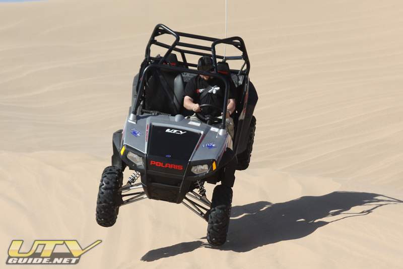

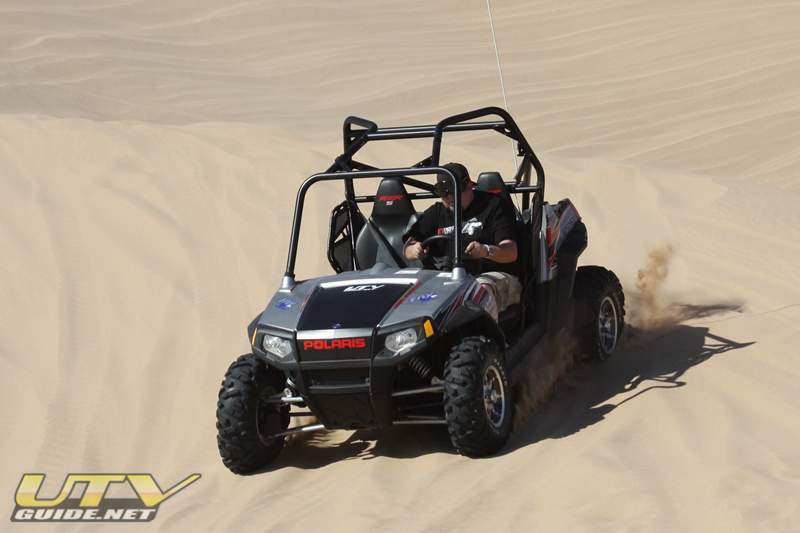

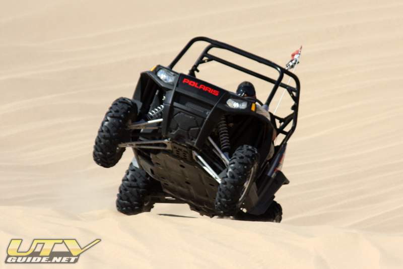

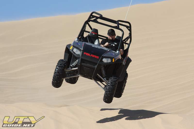

Fox 2.0 Shocks are the way to go: Polaris RZR S Shocks - UTV Guide
Here is what Joey D had to say: http://www.utvunderground.com/f38/utvunderground-com-polaris-rzr-s-fox-rc2-shocks-review-936.html
Here is Joey D. trying testing them last March in Glamis:
