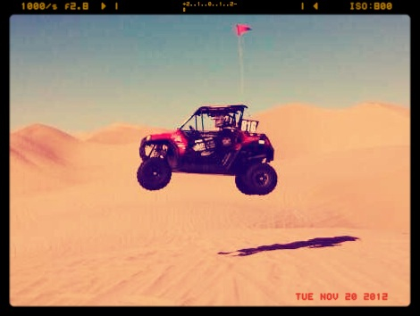

RZR570 in the Dunes.
That 570 was RIPPING!!! COde and I were having a ball with the rest of the crew shredding the dunes of Glamis for our Camp RZR Pre run weekend. I couldn't believe it was Code's first time in the dunes, what up with that DAD? hahaha He didn't look like no first timer, kid had style!
What can I say, not really a sand guy. Actually we quit going to the dunes and started going to Superstiton when Cody was about 4 so he could ride his 50. Sand and 10" wheels dont really mix.
