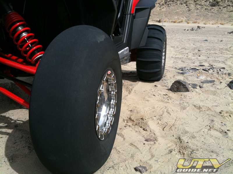

Here is a pics of the wheel:

I prefer the STU Sand Blasters in the rear which require a wider rear wheel (maybe a 12"). The picture above has the full width paddle which my RZR XP and 999cc Teryx pull well. But I also tried a stagger cut paddle and it spins up a little faster. I think the full paddle is fine for my 999cc Teryx and the stagger is best for the RZR XP.
