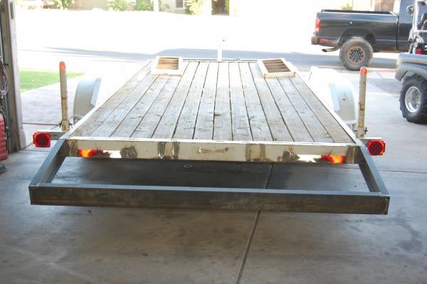

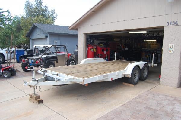

finally getting around to extend my 16" Carson carhauler. now my Rhino and RZR1 will fit without removing the Rhino tailgate. i plan on doing alot of preventative work to the trailer in the next few weeks. stay tunned.

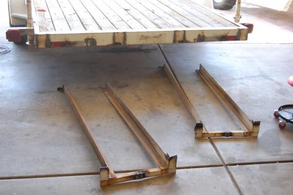

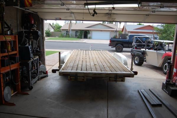

i started on my dove tail install today and it went faster and easier than i thought it would.
i cut off the ramp storage angle iron and cleaned up the rear of the trailer. then i cut the side extensions to give me a 4" drop over 27" with 13" of ground clearance. i beveled all of the new metal to trailer and tacked it on and checked for square. hopefully tomorrow i can weld it out and install the fish plates to the side splice area. could not have had better weather for a AZ weekend in June.

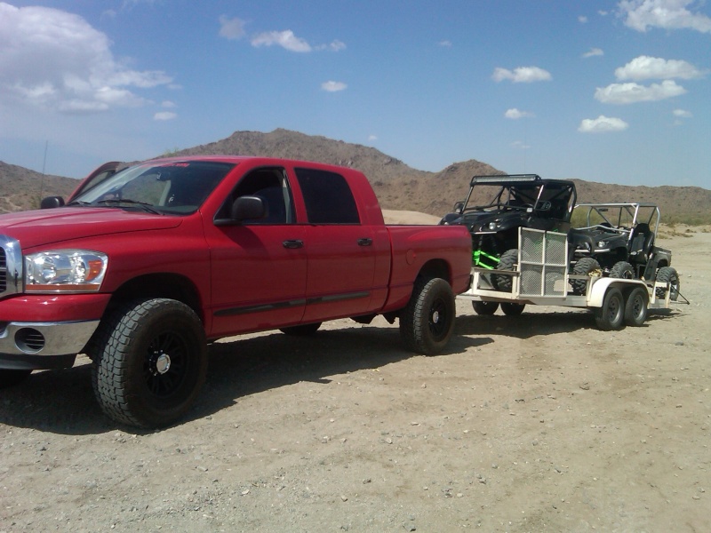

careful mike- when we put two on my 16ft carson with the ramp down in the rear(like an extension)- the damn thing starts swaying at 60mph. not enough weight up front.

careful mike- when we put two on my 16ft carson with the ramp down in the rear(like an extension)- the damn thing starts swaying at 60mph. not enough weight up front.QUOTE]
i have extended the front of my hauler so my Rhino front tires are 12" forward of the deck. with the new extension i might back the rhino on to give more weight up front. will see.
cool. just something to think about. it sucks only going 50-55 when we have two on there
We had the same issue as KJ...took a nice 16ft trailer with 7000K axles...extended it 2' so we could haul 2 SxS on it and loaded it sways pretty bad above 60-65....no matter whats pulling it
Not to be a smart ass here but from the looks of this image you need to bring the front of your trailer down to get your trailer level. This will help, maybe not solve your issue but having the trailer tilted will put more weight on the rear axle.
Just sayin'
Just sayin'
its how i parked-I wanted the rear of the trailer as low as possiable to drive off.
and yes it has the right drop hitch and is level when on flat ground.
Anytime you extend a trailer you need to move the axles. The reason they sway is because the axle is to far forward now. I have a 16' that I am going to be extending also and if I remember correctly i need to move the axles back about 14.5 inches. I'll check and see for sure when I get home as I have already figured it out. Now if you have the room up front you can also extend the front and rear of the deck in the right proportions so that you don't have to move the axles. Just depends if your tongue is lon enough. Love the dove tail you added though. I was originally planning on doing a dove tail it I won't be able to make it up my drive way if I do so I have to stick with it being flat
MFD is right guy's. 60/40 front to rear is how you want to load it. Backing both machines on the trailer will help a little bit too. With 2 machines on that size trailer you will never get the weight right on it even if you move the axles back. If you have to keep this trailer, move the axles back, back the machines on the trailer and install sway controls & make sure it is level.
