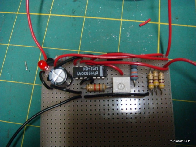

For the past week or so I've been trying to figure out a way to make the Rhino's stock tank fuel sending unit communicate with the R1 cluster. I realize the R1 cluster doesn't have a fuel level gauge, but it does have a low fuel "dummy" light. Well, I finally figured it out. I used this circuit
http://www.bcae1.com/temp/lowfuelindicator01.swf
but I had to modify the value of the resistors a bit. Here is a picture of the finished circuit
I spent a bit more time today organizing the components on the board.
I added a relay to the board and sealed it.

What's nice about this circuit is that as long as you're using the stock fuel tank you can trigger a low fuel light on any gauge cluster that has it. Or if your cluster doesn't have a low fuel light, then you can just mount a 12 volt LED (like the type used with car alarms) somewhere on the dash. Anyone with an R1, Hayabusa, Rotax, or any motor swap can use this , again, as long as you're using the stock fuel tank.

Well. I wouldn't say it was a lot of work to build it. Kinda easy. The hard part was figuring out the components, mainly the resistor sizes. But now I've done all the "hard" work and can supply the parts list to anyone that wants them. It's another thing that I can say "I built," and didn't just buy online. Gives me a sense of personal satisfaction. How much is a add on fuel gauge anyway?
