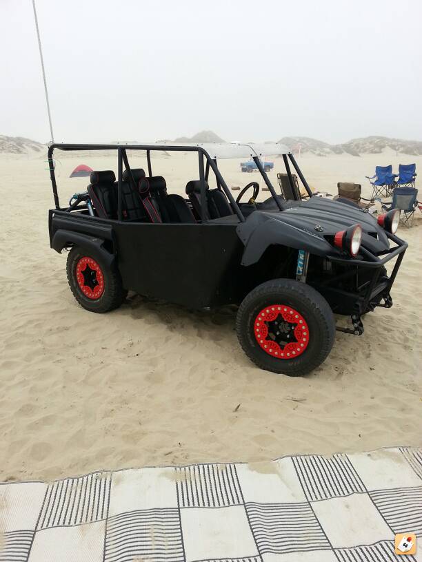

I am still not happy with it scratched easy and rubbed off easy on heavy use spots...Also everything costs more in socal. Its almost 9.00@ autozone here. I was pressed for paint before a pismo trip or I would have imported some auto satain black paint and done it right..
I will post if it lasts better:D
