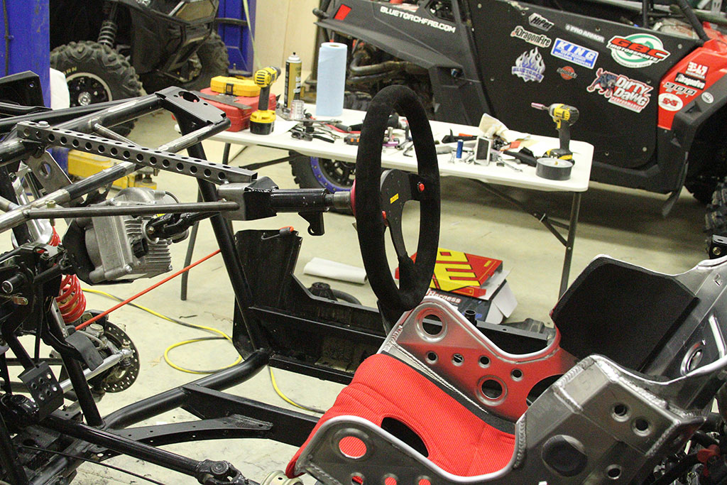

The new Kirkey seat came in today. I'm pretty sure the shipping box weighed more than the seat. This thing is very trick.
I was able to spend most of the day in the shop yesterday getting work done on the center seater.
Seat pan is done and mounted to the chassis.

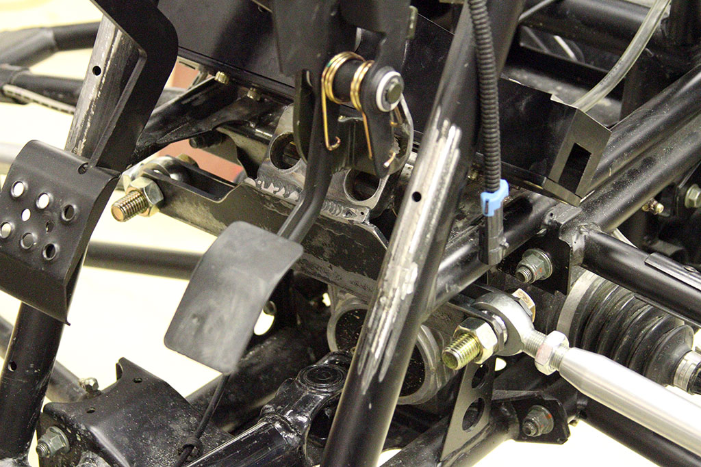

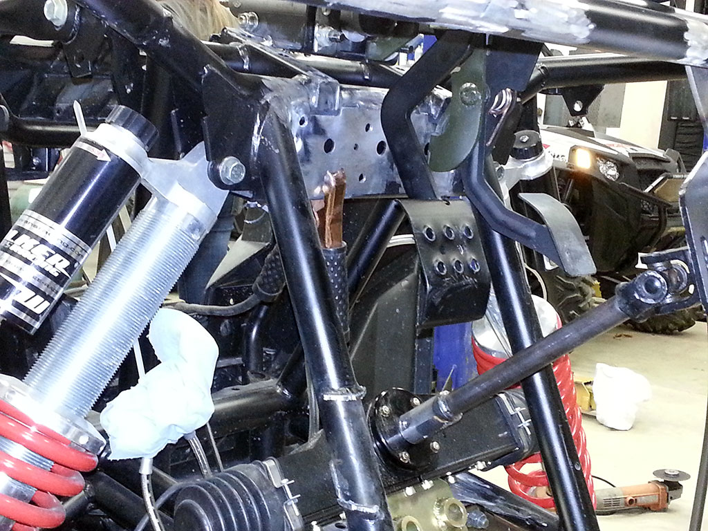

I chose to mount the pedals up high in the chassis. I'm fairly tall (6'2") for a UTV, so the extra leg room gained by moving them further up in the chassis should work well. That combined with the slightly reclined seat angle should make for a very comfortable driving position.

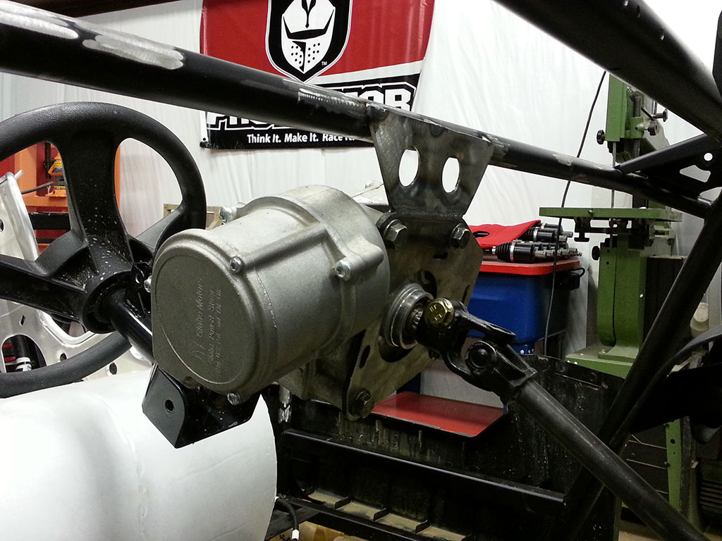

I was also able to mock up the power steering mount. It is only tacked together at this point, but I'm really digging the mounting options there. I shouldn't have to add a lot of metal to keep it solid.
Hopefully, I'll have some more time to spend on it this evening.
Steering tacked together.

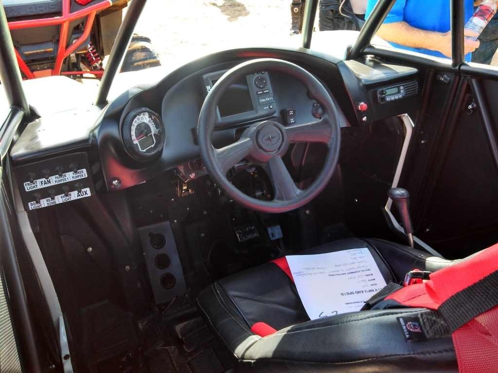

Cool build! I have built 2. I will have one at the FSA drag races in Glamis on jan 19th. Hope to see some of you guys out there..

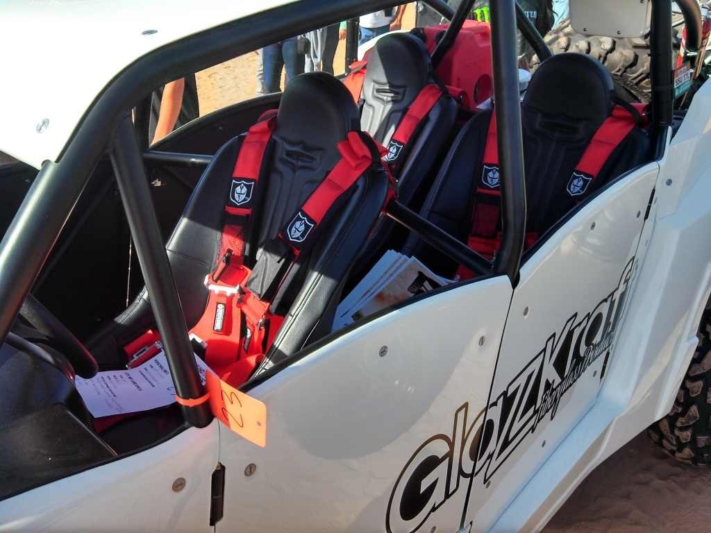

Here is a sneak peek of the 4 seat one I built. It is done now, but owner does not want me to share too much.. I dont want to hijack this thread also! Let me know what you think..

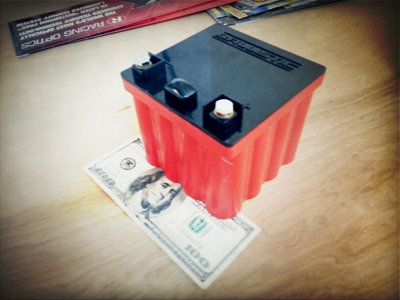

Octane look up anti gravity batteries, it is a lipo racing battery that you can save another 10-12 lbs with and actually have more power.
I decided to move the pedals down a little. The driving position isn't nearly as comfortable, but it will alleviate the problem I was having with the master cylinder reservoir and the issue of lengthening the throttle cable.
I'm still shooting to have this car ready for WORCS round 1, so time is running short, very short.
This weekend, I'm going to build the fuel cell and get the SACO box connected to the tie rods.

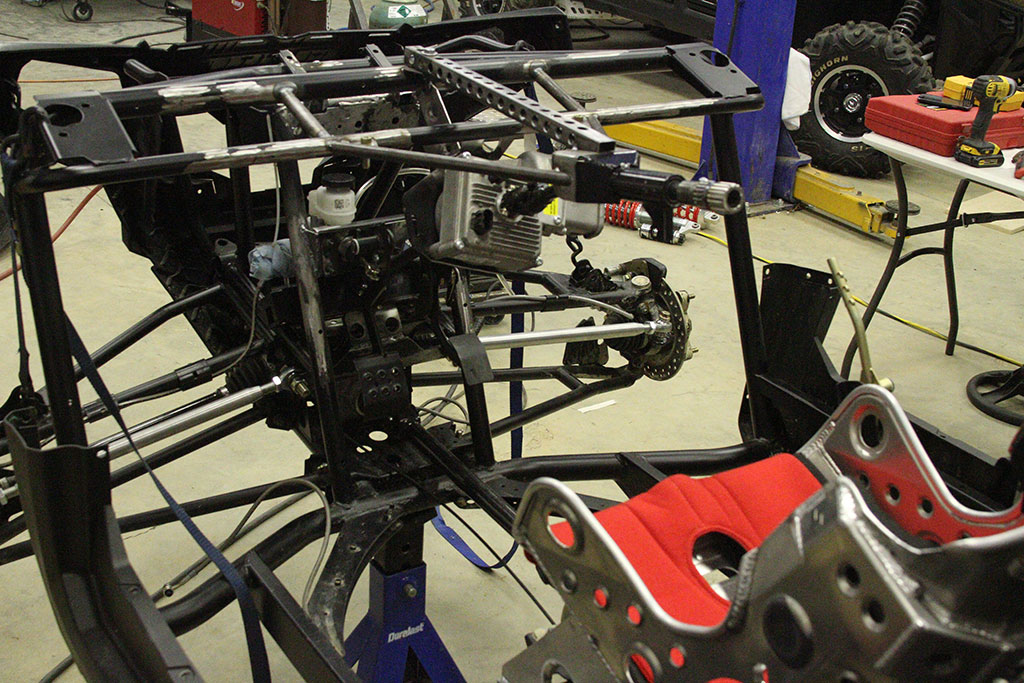

Made some good progress today.

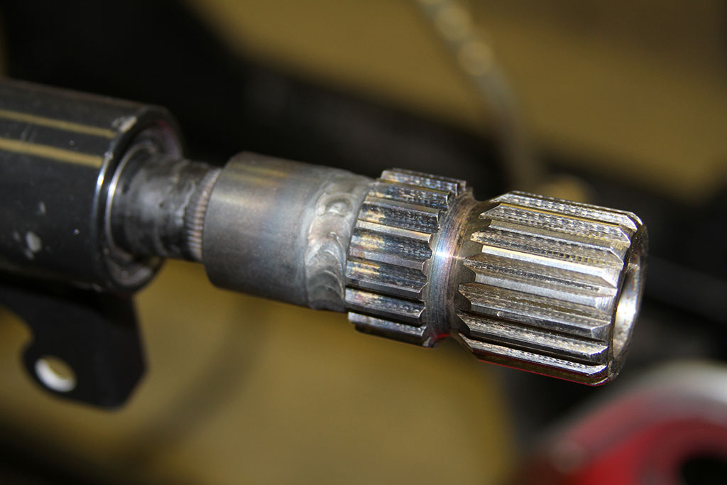

OEM steering shaft cut and welded to a 3/4" shaft.
Quick release steering wheel adapter cut and welded to a splined coupler so I can still disassemble everything if needed.
Complete steering assembly.
Steering rack modification.
Another view.
