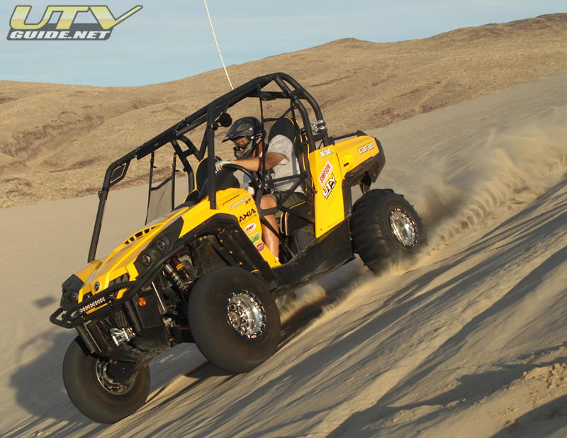

Next up was a trip to Sand Mountain. For this trip, I had installed several aftermarket accessories to customize the Commander to my liking. These items include, Elka Stage 4 shocks, Muzzys dual exhaust with DigiTune, Fullerton Sand Sports paddle tires on OMF beadlock wheels, Baja Designs 10" Stealth LED, PRP seats, Simpson harnesses, Factory UTV skid plates and harness bar and Axia Alloys mirrors.
Right from the start I was in awe. The transformation from a really nice UTV to "WOW!" was amazing. The Commander was climbing everything but the steep back side with ease. The extra power from the Muzzys exhaust was great and the fuel delivery was spot-on. The Elka stage 4 shocks made all the difference in the world. Nice ride in the chop, but firm over transitions and g-outs were handled without even coming close to bottoming out. The PRP seats were super comfortable and the Simpson harnesses gave me a little more sense of safety on those fast dune rides. I even had a chance to use the Stealth LED light during a night ride. The Commander high beam lights are pretty impressive by themselves, but you can never have too much light. The tight package of the Stealth LED fit right in the XT bumper and gave me just enough extra light to feel comfortable driving a bit faster. And I got to use my Axia Alloys mirrors quite a bit to make sure I did not leave the others too far in my dust....Hah!

Stage One Upgrades: So far, I have bumped the power with a Muzzys dual exhaust, Elka Stage 4 stock replacement shocks, dune tires and beadlock wheels from Fullerton Sand Sports and OMF Performance, Seats from PRP, Harnesses from Simpson, Stealth LED light from Baja Designs, Mirrors from Axia Alloys, Skid plate and harness bar from Factory UTV, Seat belt sensor delete from Turnkey UTV and 26.5x14 Pit Bull Rockers to replace the Big Horn 2.0's.
