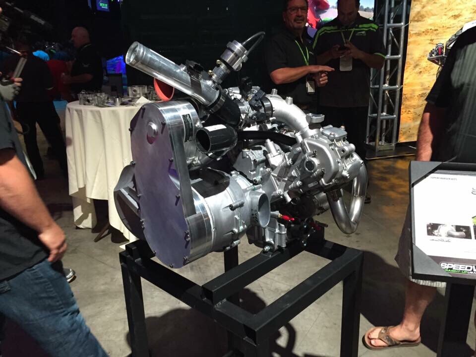

They have a supercharged 150hp+ motor on display at the show. It is build by Speedwerx, but perhaps this is insight into what the next Wildcat will have.
This is the same wildcat that's at the show that the dealers will get to drive this week I was helping speedwerx break it in 3 weeks ago , the 150hp supercharger pump gas setup makes the wildcat shine and gives a bad case of perma grin.

Factory option?
Not sure , I know speedwerx was invited to the dealer show , and they have both a na version of the wildcat x, a supercharged version of the x and a wildcat sport that they setup but I'm not sure if it'll be in the ac accessory catalog or what the deal is.
The na is clutched, has their quiet exhaust and fox shocks
The supercharged got the full treatment featuring the L2 exhaust. I can say the power is immediate and pulls like a freight train.
The sport has clutching and a stainless trail exhaust.

And a speedwerx supercharger is a terrible idea. Cause that means they're gonna still be using the crappy team clutches. And have a huge gaudy supercharger hanging off the side of the clutch cover. Which will make changing a belt an even harder job considering you already had to take the shock off to get the clutch cover off. Now they turned a 40 minute job into an hour and a half job. I am sure it's gonna have the same shit clutching it's always had. And 150hp it's still gonna be a turd wagon. Freaking morons. The video showed a current wildcat with the plastics off. Which appears to have the exact same rear differential as always. Which has a short stub shaft that breaks when you land under power. I sure hope the machine the guys are talking about in the video, is something different. With a different engine and a divorced trans. Good heavens why didn't they copy what Greg biffel is doing. Jesus let's hope they make some changes cause this was depressing.

And a clutch kit won't fix the crappy secondary clutch they have in the current models. I built every helix I could think of. Used every spring available on the market. There is nothing you can do to make it adequately backshift and hold the right ratio all the time. Putting more power to it is just gonna make it overheat the belt faster. Good luck to all of those who do purchase it. I will gladly wait for a 2017 to arrive.

Over 300 miles ran wot on the unit that's on the show by myself , Jeremy Houle, Patt Dohr (dirt track guru), and a few others
Not one failure , no problems with back shift, no problems with clutching.
Belt changes are not that difficult , back the blower belt tensioner off , remove the belt remove the clutch cover and it's the same as stock. You can still cut the clutch cover on centerline of the primary and then it eliminates the need for a shock removal.
I'm curious how many of speedwerx supercharged wildcats you've ran to justify calling it a "turd wagon" at 150hp on pump gas? Switch to race gas and run a different pulley and you can get even more out of it before you even touch the motors internals.
