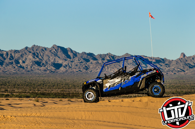

Do I like it? NO - I love it. Why? Because I love the stability and predictability of the XP4. The longer wheels base instills confidence when bombing through large or small whoops. The wheel base remains planted and gives you the ultimate ride when powering through these large bumps at speed. So I get all the benefits of the XP4 chassis, wheelbase and suspension yet instead of 4 seats I get 2 massive big boy friendly seats and 2 kick ass storage boxes! So if you're like me and you love jamming through the desert in an XP4 and a standard XP then this is your dream machine from the standpoint that you do get the best of both worlds.
So let me break it down like this...
Suspension - Same as the XP4, I mean EXACTLY the same. Same shocks, same arms, same everything. Would I want to change anything? YES, I would want to, and will play with the shocks some more. I found myself bottoming out quite a bit with it right out of the box. To Polaris credit the dunes were chewed up and I wasn't exactly driving it like Miss Daisy was with me. I added multiple compression clicks to all 4 corners and it did improve the ride but after feeling what Walker Evans Racing was able to do to my other XP4 by changing the shocks to their aftermarket "needle" shocks I would totally want to do that. Necessary? NO, you could work with these existing shocks but I do see room for some improvement here by way of some more tuning on the consumer end.
Ergonomics - Same RZR interior in terms of the dash layout. Still leaves me wanting something new, something fresh, and yes, a center console of some sort. However, the new PRP seats are amazingly comfortable. They have a sweet mesh cutout that allows water and sand to sift through the seat and they are 5 point harness ready. No more shoulder harnesses falling off your shoulders like the standard XP900 models. These seats allow them to run through the head rest and to keep them tight and narrow on your shoulders and chest. The fit and finish of the PRP seats is the best I have ever seen from them, they did a great job getting these seats just right! The driver seat is on a slider so you can push way back, I am 5'10 and in a standard XP900 I tend to tap my knee on the dash on occasion, with this car that is all GONE! I can push way back and with the seat position you really feel like you are sitting deep in the car. I loved the seating position and I will go as far as saying as this IS the MOST COMFORTABLE UTV on the market now! I let my 6'4 300lb + friend drive it and even he said he loves the seats and the comfort of the machine. The rear storage boxes ROCK! They lock-in with the use of standard XP seat bases which means they are easily removable for servicing your engine. I did not look to see if it was possible to put 2 additional seats in the back in replacement of the boxes. The boxes themselves are big and are lockable allowing for storage of all your essential items such as tools, coolers, and whatever else you wish to include in them. No babies please..
Cage / Chassis - Our units are pre-production so I am always easy on launching an attack on any of the OEM's units they get us before the general public. Our doors were a little out of alignement and wanted to open up on our first test ride, but the awesome Polaris engineers quickly adjusted them and got them working well. The doors themselves look great and the nets never got in the way of my driving like the standard XP's can tend to do. The cage looks awesome for a factory cage and I love the blue powder coat. Pro Armor manufacturers the Pure Polaris aluminum roof that they had on display and it looked great.
Wheels / Tires - Well its got Big Horns, nuff said. Only the most popular, well working tire in UTV history so no complaints there. At 10lbs in the sand this thing hucks roost as you can tell by our photos. I had no problem launching a roost and powering up hills as fast as any other XP with its paddles on. The Wheels are NEW Walker Evans Racing 12" bead locks. The wheels do not come bead-locked however, Polaris installs them on the inner bead like a standard rim. It is up to you the consumer to dismount and mount the bead in between the ring. I was told it was a liability thing? Either way not a big deal. They look bad ass and worked awesome.
POWER - OK, so everyone wants to know, how is the POWER in the H.O. motor? Well, its SICK! or in the case of Polaris' inside joke with me, its GRIP. (I can tell that story another day..) You know you are in a bigger machine then the standard XP, you know it shouldn't be as quick as an XP because you are heavier yet you will run with a standard 2 seat XP ALL DAY! Its quick and right away I could feel the extra grunt when on those long dune runs up a soft hill or bowl. There is something about the power-band in a Pro Star 900 that I just love. It winds out amazingly well and the way it accelerates and puts you back in your seat is phenomenal. Best part is, its still quiet. The slip on SLP exhaust system sounds good, adds power yet still is quiet. The head is painted blue like the roll cage and arms and it just looks bad ass! For you guys who already own an XP900, you can buy this H.O. motor upgrade to put on your XP900 to take it to the H.O. level! Kudos to Polaris for giving their consumers that option to increase the power on their existing 900's. Is it faster than a Maverick? I honestly don't know. I have yet to drive one so I cant say either way, but I am confident in saying that I don't expect a Maverick to flat out outrun it. Once we get our Maverick we will compare honestly and see how they stack up against one another.
Handling - IT HANDLES, just about anything you throw at it. I ran this thing at 60 mph + through the BIG whoops for a good mile long stretch and it charged hard without missing a step. I powered through turns like I was in a car on rails (see our video for proof). I LAUNCHED this beast a good 40ft pancaking the suspension, landing off camber on one wheel, and planting the car rear wheels first and never once felt like I was doing something the car couldn't handle. Rallying through the dunes was a pure riot in this thing and sliding the tight wash trails was nothing short of exciting. The POWER STEERING is sweet! I mean lets call it what it is, its a mini fricken sand rail with a mom thats a RZR and a dad thats a rally car. The thing gets it on!
Looks / Exterior - Blue + Black = WINNING! The flat / matte finish is perfect and just my style. Polaris did their homework here and listened to Jagged X well. agged X has some of the best looking UTVs in the world, Polaris done good with this one!

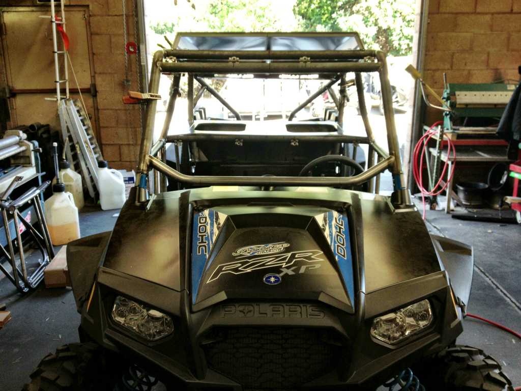

Stopped by SDR today and the boys are cranking! Tins are being completed and we finalized some minor details that are going to set this car off

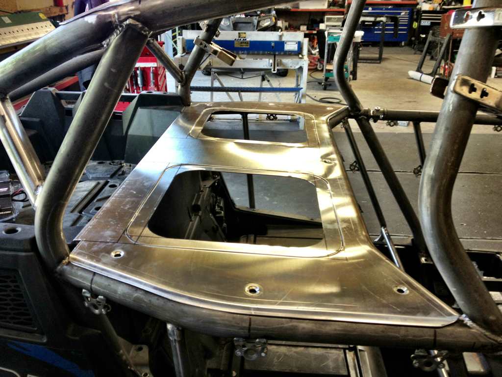

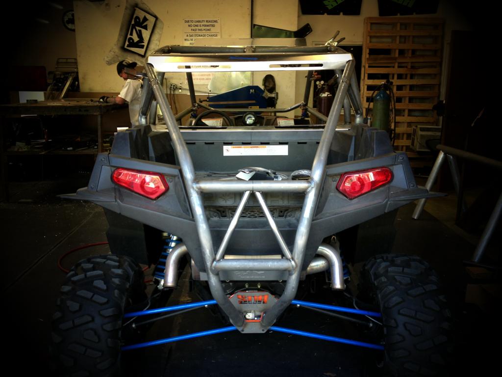

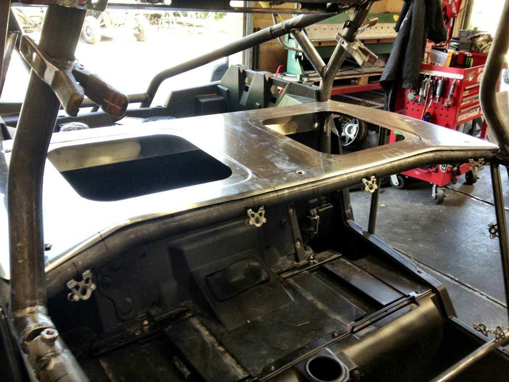

The center tubes of the rear cage will be removed and make way for complete tin work with perf cut outs. Back up lights from rigid will be hidden inside!
Flushed in rear tail lights are going to look sick.

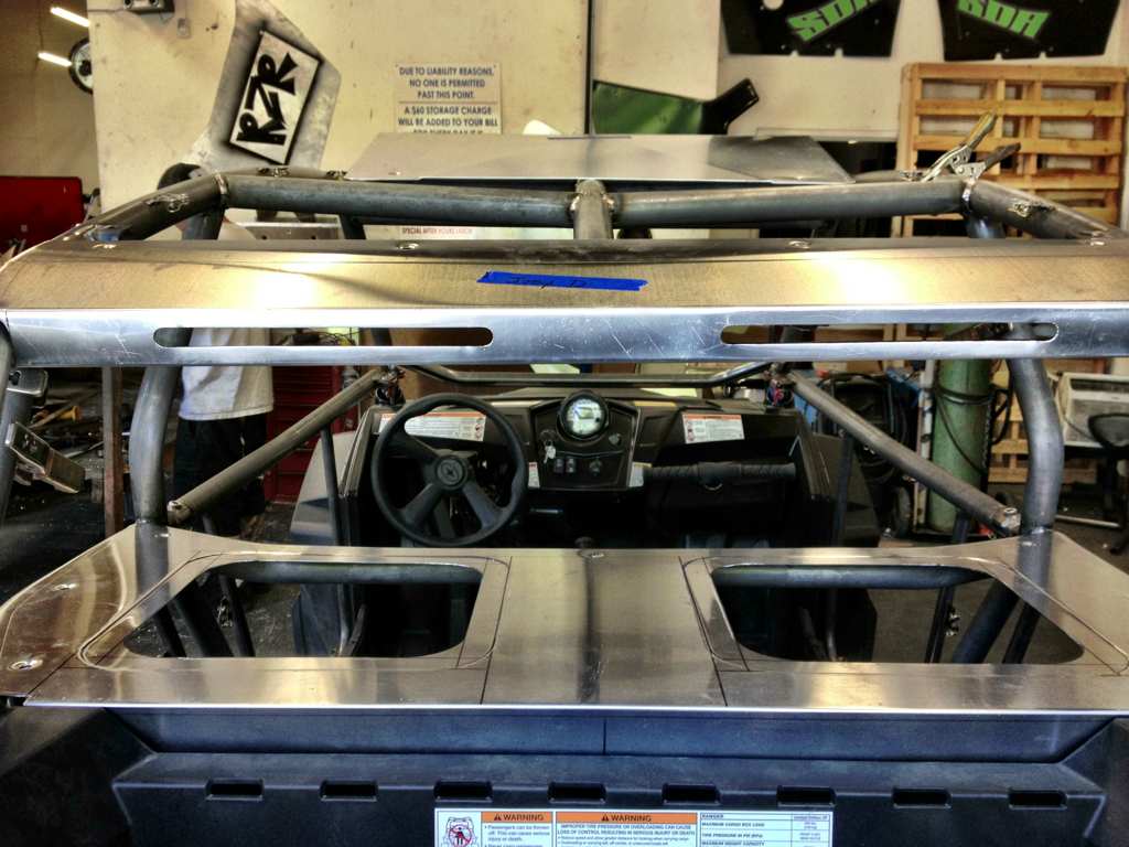

We will modify the factory storage boxes and encase then with a sick aluminum enclosure that will be sealed with custom aluminum trunk doors.

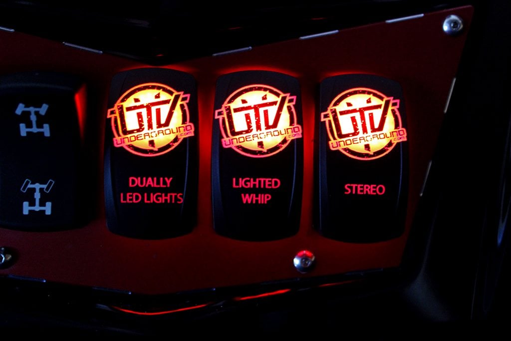

UTV Inc. made is these sick custom switches that we will use in all out builds from here out. These are available for purchase at utvinc.com
Just like the stormtrooper we opted to have a large open windshield with no intrusion bars for maximum visibility. SDR also made an aluminum scoop for the roof that will encase our 30" SR Rigid LED Bar.
